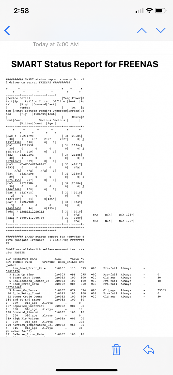

Quick question, for any who care. Is it all possible to specifically disable text-wrapping? Viewing the email report on my desktop is fantastic, but I occasionally want to read it on my iPhone, and it wraps the text, making it unreadable. I understand this is more of a "first world problem." Is this specific to iOS? I tried lowering the font size to 8 in the script, and it helped, but that poses other readability problems.
And thanks to you for updating this script! I'm about to take a look at the rest of the repo and nab anything useful :)

Hmmm... I tried to force fixed-width whitespace handling, per a GitHub user suggestion, by using this html in the scripts:
<pre style=\"font-size:14px; white-space:pre\">
Make sure the scripts you pulled from GitHub contain this code. There may be other, better ways to force html parsers not to wrap text that I don't know of. I'm not an html expert and am open to suggestions.
I honestly have no idea! It's likely a limitation on Apple's Mail app on iOS. While I do love my iPhone, I will be the first to admit that the mail App is severely lacking.
Attached is how a recent report looks on my iPhone. Keep in mind this is the one where I manually reduced the font size to 8px in an attempt to prevent this. What's odd is there are lines after the "Summary" that are much longer than the summary, yet the summary itself is being word-wrapped much earlier in the lines.
Nonetheless, I appreciate your response. I have zero knowledge of coding, other than what I can figure out on-the-fly with Google research.
How does it look when you flip your phone over and view it in landscape mode?
Still a mess, although the linebreaks aren't in the same spot. I've tried experimenting with the code by adding
<div style="width:200px;overflow:visible"></div>
tags into the script, along with changing the width in those tags. I've also tried copying the smart_report.tmp output into an HTML Viewer website, and if I change those tags, along with the white-space type, it behaves exactly how it should. Something behind the scenes i is just going wonky. I changed the script email to my gmail account, and checked it in that app, and although it also word-wraps, it's much more predictable, and is at the edge of the screen. The iOS mail app is word-wrapping in wierd places.
It's no big deal, it's just a quality of life thing lol. I may just try and dissect your code and just use the summary portion, and try and format it for mobile viewing. If I stay within a certain character limit, I can even use it with pushover. (not that it wouldn't work otherwise, but pushover will just truncate the email/message)
