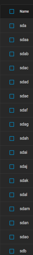

TrueNAS-SCALE-22.12.2 with 39 spinning rust and 2 mirrored ssds for boot pool. Total of 41 disks. It appears that when the sd devices go beyond 26 and start using designations such as sdaa, sdab, sdac, etc. the reports truncate to sda and just give the same reports on sda instead of sdaa, sdab, etc. Does anyone else see this issue. It is a great script tool otherwise. Thanks.
1684201997564-png.66656
Well I knew someday someone would find this out. I've known this would be a problem but fixing it is a bit more involved so I placed it on the very back burner and waited for someone to call me out on it. It may take me a little time to come up with the proper fix that works on both Core and Scale. Once I have it, can I contact you to test it out? I do not actually have that many drives so I can only simulate that number of drives, so it's not a true test.
I would be happy to assist you. I am glad I said something!
Fairly sure that TrueNAS Report would not have that issue if it helps any.
You are correct. I had to bend the rules a little and install bc. However, it did not have the problem. All 41 drives reported. I am not sure what will break on the next update since I had to install a non supported utility. Oh well, wouldn't be the first time I trashed the boot and had to restore it.
