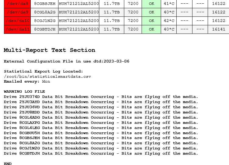

Was in the middle of sending Joe an email as I thought the script had lost the plot. My daily report emails listed all my drives in red. I thought it would be weird they'd all have issues at the same time. Then it occured to me what the date was :tongue:

Glad I could bring a little excitement to an otherwise hopefully uneventful day.

That was cruel, only something Wednesday Addams could think up!

Except for the April Fool's Joke doesn't work :frown: I was hoping to see a message on my machine when I woke up, but nope. I actually didn't test that part and should have, it just wasn't nearly as important as getting the real data correct. The previous version does work as indicated above. But thanks for the kind words.

JESUS I've never run to my desktop so fast in my life after getting that email this morning!
