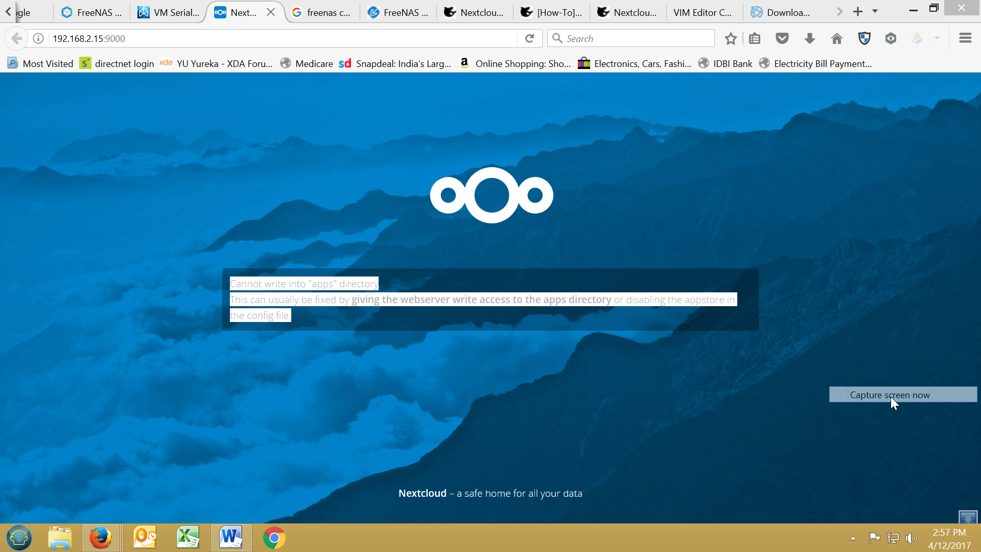

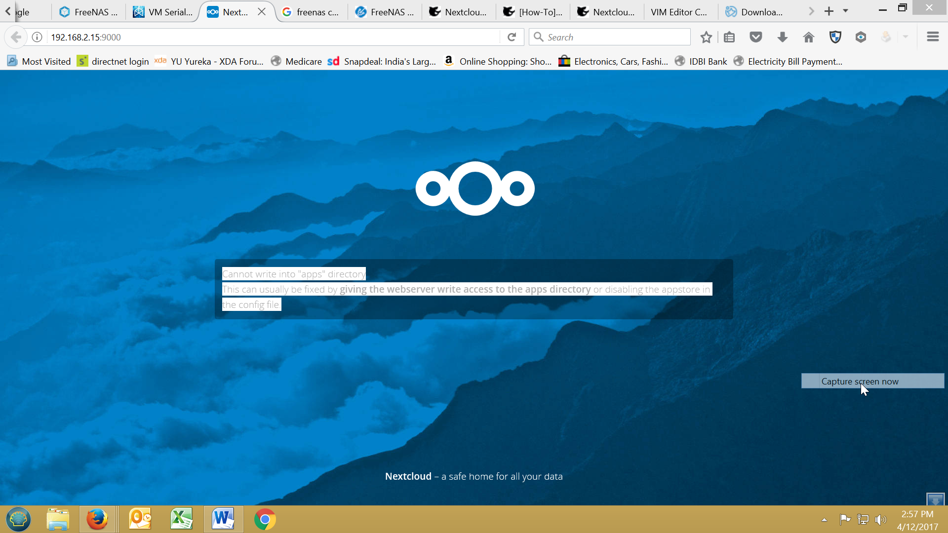

I created a docker for Nextcloud. When Iaccess the same, I get an error as below.
Can you help to overcome the same

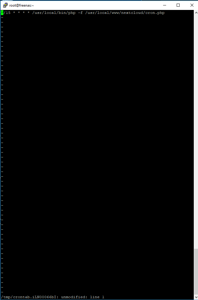

I know the cron dont work because the admin page of nextcloud "last cron job 35min. ago". It sould be between 15 min i guess :)
Again I will thank you for you help
