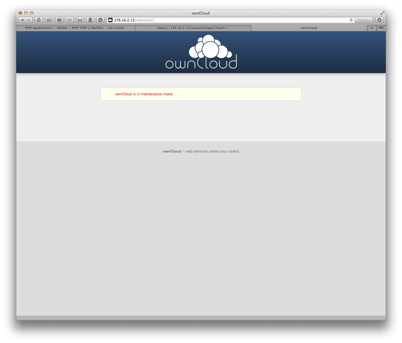

I had ownCloud 5.0.4 working, but since I updated to 5.0.5 it just shows "ownCloud is in maintenance mode". :(
What happened?
Bjarke
Apr 21, 2013
edit /usr/local/www/owncloud/config/config.php and change maintenance from true to false, save the file and then just to be sure do
service nginx restart
then just reload the page, and it should complete the upgrade and everything is fine :smile:

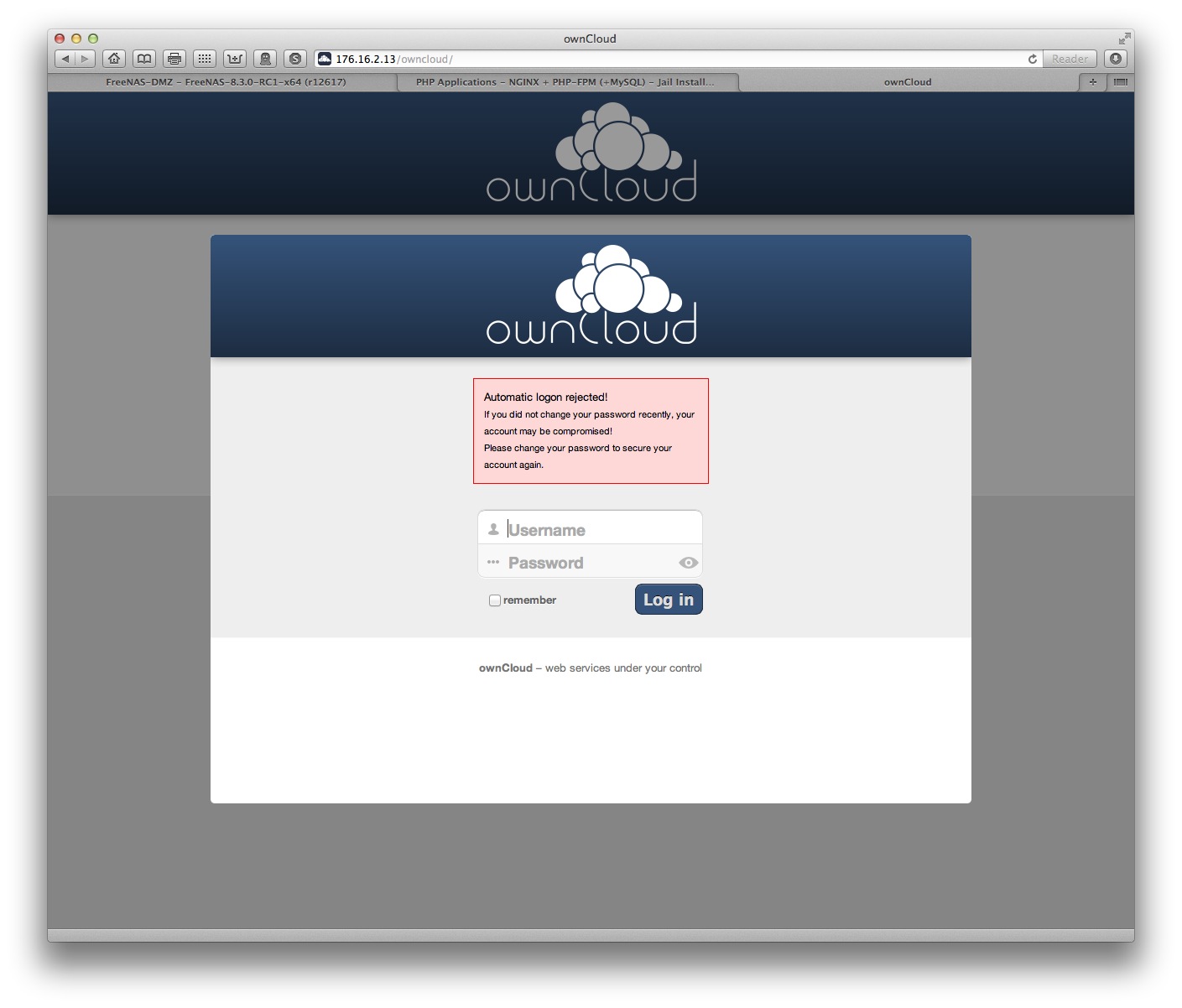

Atomic
Oct 20, 2012
160
the "maintenance" seams to be resolve. But now I can't log in any more, ownCloud alway rejects me login. :confused:
And the /usr/local/www/owncloud/config/config.php says 'version' => '5.0.6', but version 5.0.5 is installed.
