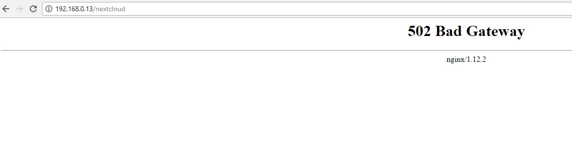

So after running this command I'm no longer able to access Nextcloud either via LAN or WAN. Any ideas?pkg install ffmpeg
Start a new thread, this one has nothing to do with your problem.So after running this command I'm no longer able to access Nextcloud either via LAN or WAN. Any ideas?
What do you mean this thread doesn't have anything to do with my problem? I followed the directions of the OP and ended up where I am now.Start a new thread, this one has nothing to do with your problem.
