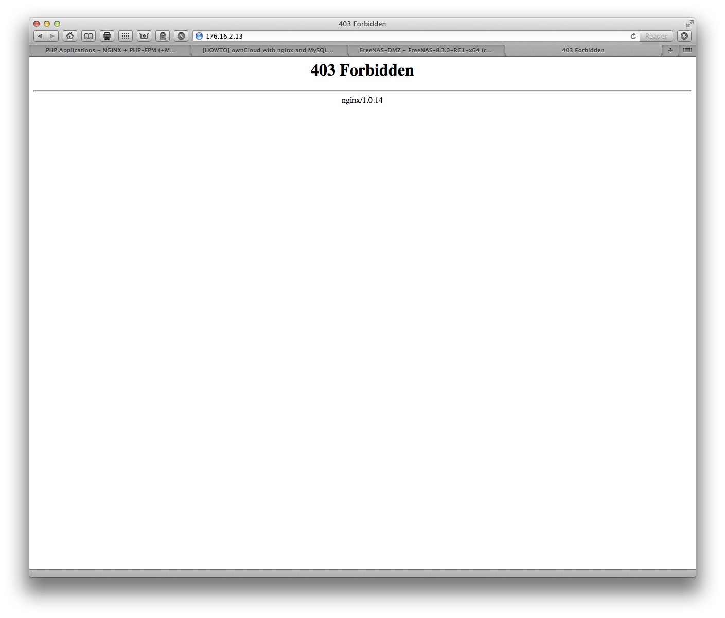

Hi all,
my ownCloud won'd run.
I followed the steps from Joshua straight forward but I only get "Forbidden 403" shown on http. :(
I need a step by step guide which is dummy proof. :o
nginx, php-frm and mySQL are running.

Hi all,
if you setup owncloud using my guide you should be going to "http://jailip/owncloud"

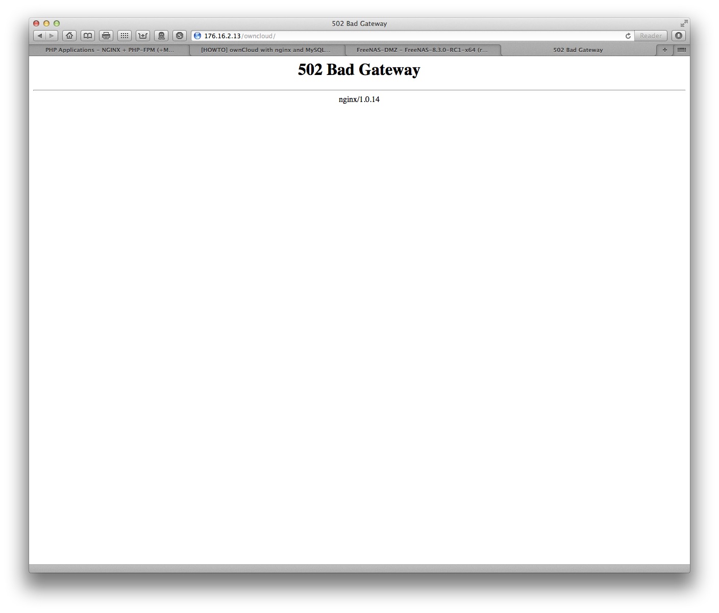

502 Bad Gateway

Oct 20, 2012
160
Hi Joshua,
here is the sockstat:
owncloud# sockstat
USER COMMAND PID FD PROTO LOCAL ADDRESS FOREIGN ADDRESS
www-ajaxplorer php-fpm4292 0 stream /var/run/php-fpm-ajaxplorer.sock
www-ajaxplorer php-fpm4291 0 stream /var/run/php-fpm-ajaxplorer.sock
www php-fpm 4290 0 tcp4 127.0.0.1:9000 *:*
www php-fpm 4289 0 tcp4 127.0.0.1:9000 *:*
root php-fpm 4288 10 stream -> ??
root php-fpm 4288 11 stream -> ??
