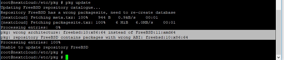

I did a new install. This solved my problem with the cron.php. But I still get this error when i try to activate memcache
Memcache \OC\Memcache\APCu not available for local cache Is the matching PHP module installed and enabled?
Also I tryed to do
 browser jail_IP/owncloud/updater/phpinfo.php
still without succecc.
I have installed owncloud according to your how-to and then switch over to nextcloud (only renamed the nextcloud folder in to ownlcoud)
I have done the installation in a freebsd vm, because of issues with the jails (cant do pkg update. Always get this message:
Unable to update repository FreeBSD
Because of this, I can install any other pkg.
For now nextcloud is running (without memcache). This shit fuc...ed my whole day :/

I thought you would have realized it should be https://jail_IP/updater/phpinfo.php
A VM? I would never do that. You probably just need check DNS is working in the jail, or delete any package server settings in the jail (I think "rm /etc/pkg.conf").

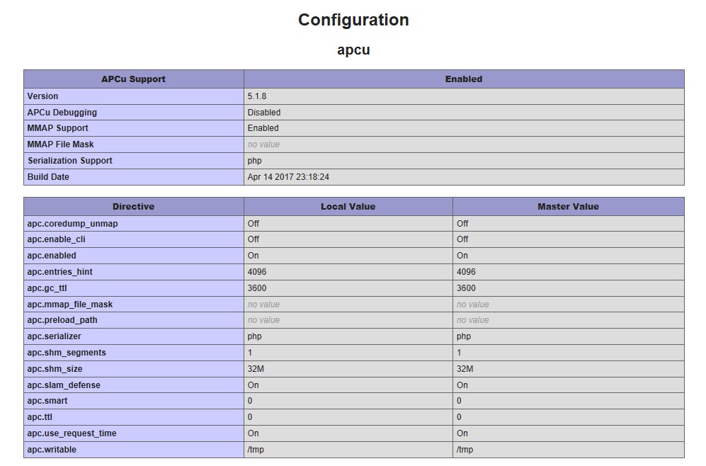

Now i got the php-page. Please find attached the APCu column. I guess it looks good.
My DNS in the jail seems to work. eg. I am able to do "portsnap fetch update". The file /etc/pkg.conf don't exist in the jail. Also a "ping freebsd.org" works. Any Idea?
Find attached a picture of the output
I found the problem.I have edit the file /usr/local/etc/pkg/repos/FreeBSD.conf and changed from :
#FreeBSD: {
  url: "pkg+http://pkg.FreeBSD.org/freebsd:10:x86:64/latest",
  mirror_type: "srv",
  enabled: yes
into
#FreeBSD: {
  url: "pkg+http://pkg.FreeBSD.org/freebsd:11:x86:64/latest",
  mirror_type: "srv",
  enabled: yes
Why only I have this issue? I can't find anything about it here in the forum....
btw... you right... that sucks very hard :(

hmm maybe you need to add "apc.enable_cli=1"
to your php.ini (then restart php-fpm)
if that works I can add it to the guide
I have seen the repo issue on this forum before. when I hit it I just delete the pkg.conf and keep going.
Thats it. Now it works. You can add it to the guide :)
Thanks for you help!
