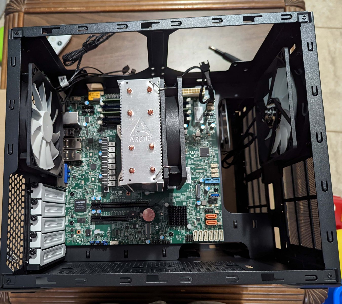

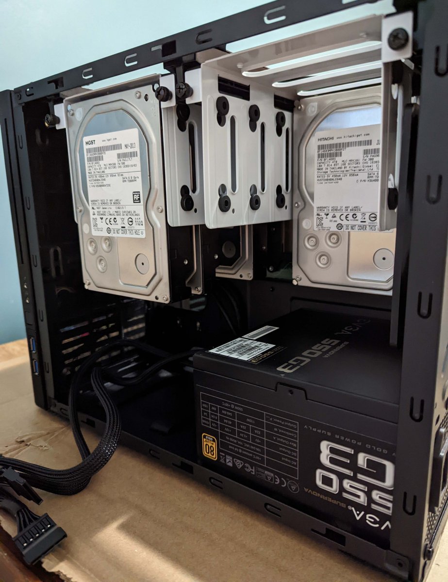

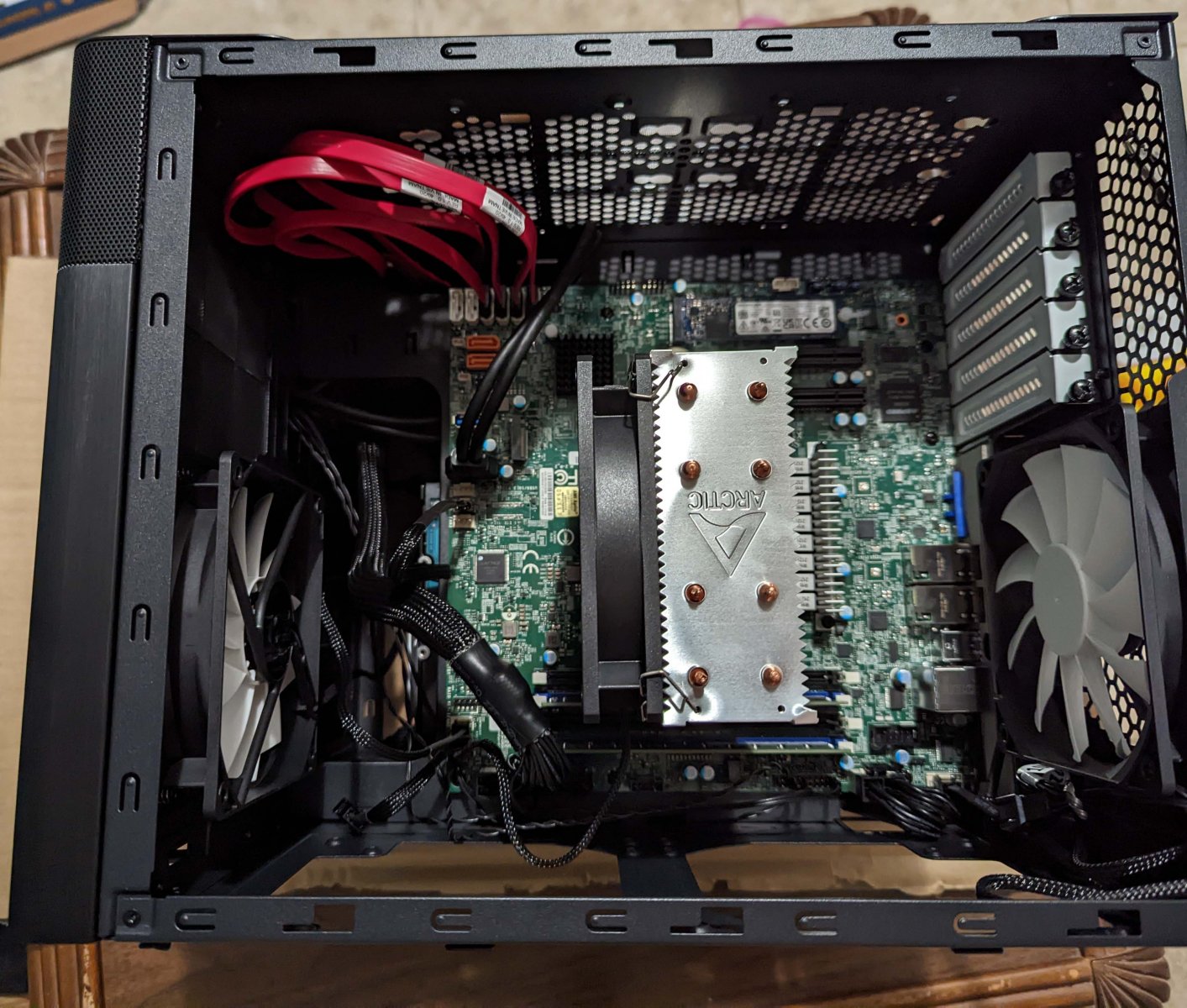

Hi all. Just wanted to give an update.

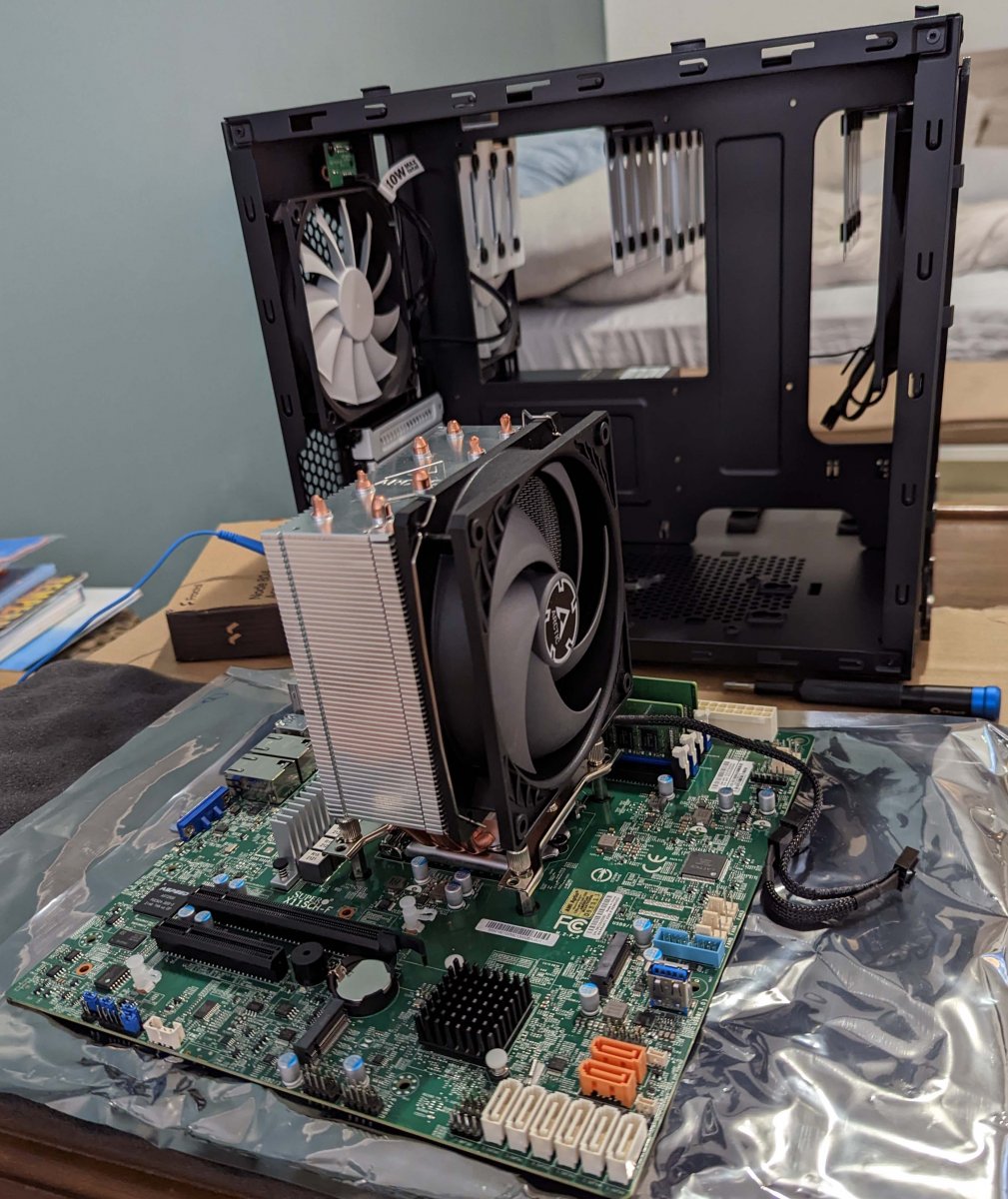

I finally received all parts friday, and I finished the build. I decided to install TrueNAS Scale.
I have yet to transfer the 2 HDD's from my previous NAS to the new one.
These are the changes from the OP:
2x Supermicro Certified MEM-DR416L-HL01-EU26 Hynix 16GB DDR4-2666 ECC UDIMM
ARCTIC Freezer 34 CO
4x HGST Ultrastar HUS724040ALE640 4TB 64MB 7200RPM SATA 6Gb/s
I did have some issues with the build that I overlooked.

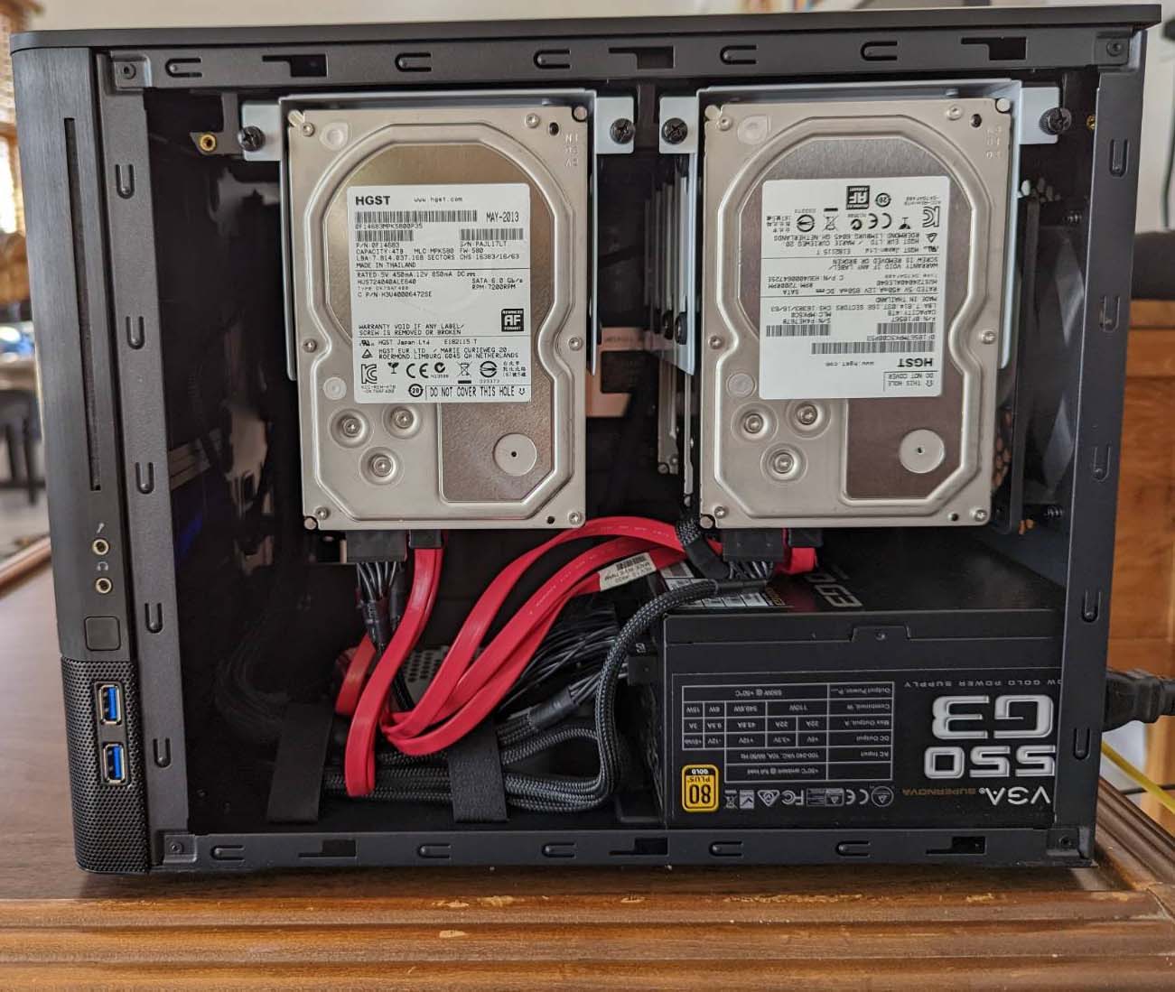

The PSU only provides 2 x 3 SATA power connectors. It was just enough for the 6 HDD's that I will be installing, but has no room for upgrade later on. Also the case uses a SATA power connector which has a switch to control the speed to power the 3 fans, but the PSU has no SATA connectors left since they all are used for the HDD's. There is a "Perif" connector, but the cable is molex. I wonder if I could just buy a SATA cable and use that instead?

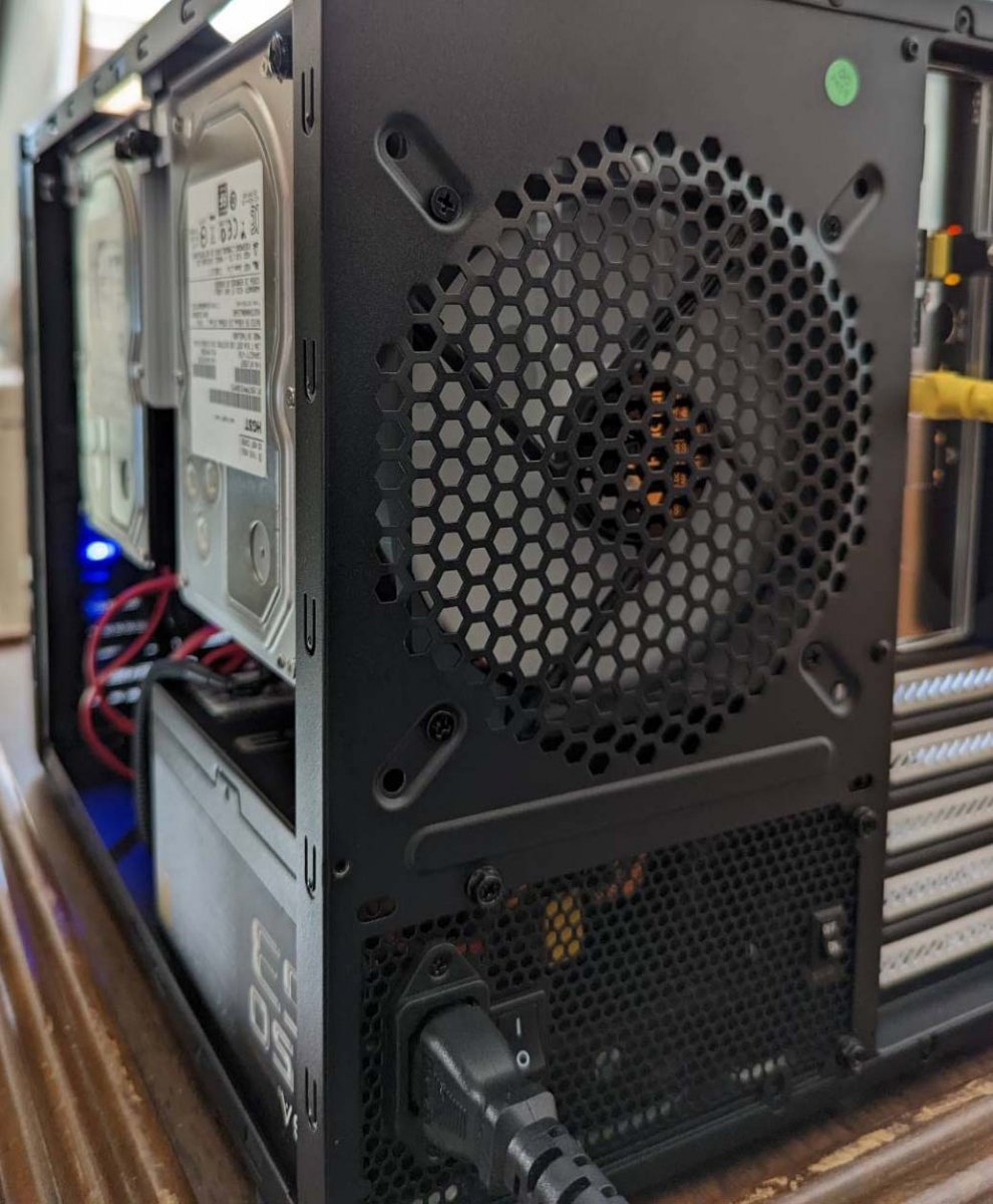

I opted to connect the case fans to the motherboard connectors instead, but the fans are not PWM. I think I will upgrade these to Noctua PWM fans.

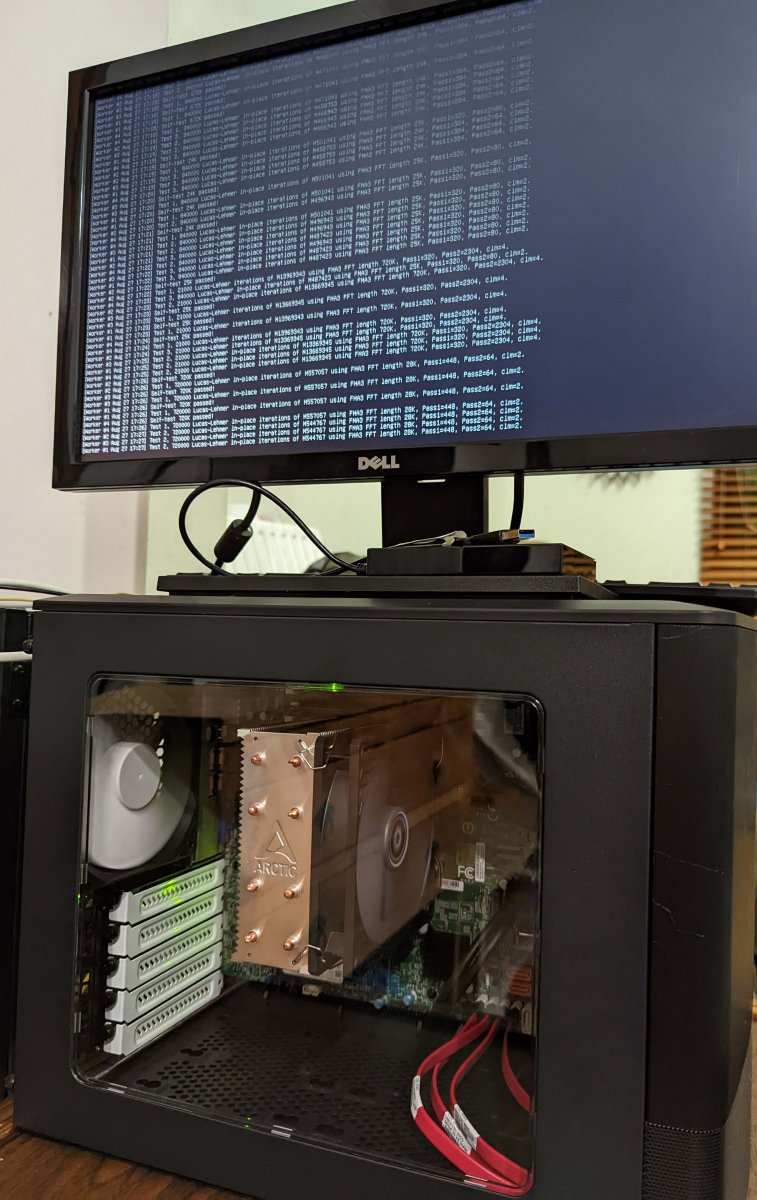

I have been running stress test since friday midnight.
I ran memtest twice (you can only do 4 passes at a time with the free version). So I did 8 passes and it took about 10.5hrs.
I'm currently running prime95. It's been running for about 6hrs (I have it set to run 24hrs).
The highest the CPU temp got was around 72C. This was around midday, the hottest time of the day (the weather has been crazy hot this summer) and the machine is not in a cooled environment.
Here are some pictures of the build. Haven't done any cable management yet.
Yes, there are Molex to SATA adapter cables, they work great. Once your system has been burned in, I would try to switch the case fans to low speed and monitor temperatures of the hard drives (since you have 7200 RPM drives) and any temperatures you can derive from the motherboard. The key is a constant flow of air across the components. Burning in is harsh and odds are your system will never feel those extremes again.
It looks like a very nice build, I hope it all works out when you are done and it's exactly what you desire. It's too bad the left front panel looks like it got scratched up.
Davvo
Jul 12, 2022
3,222

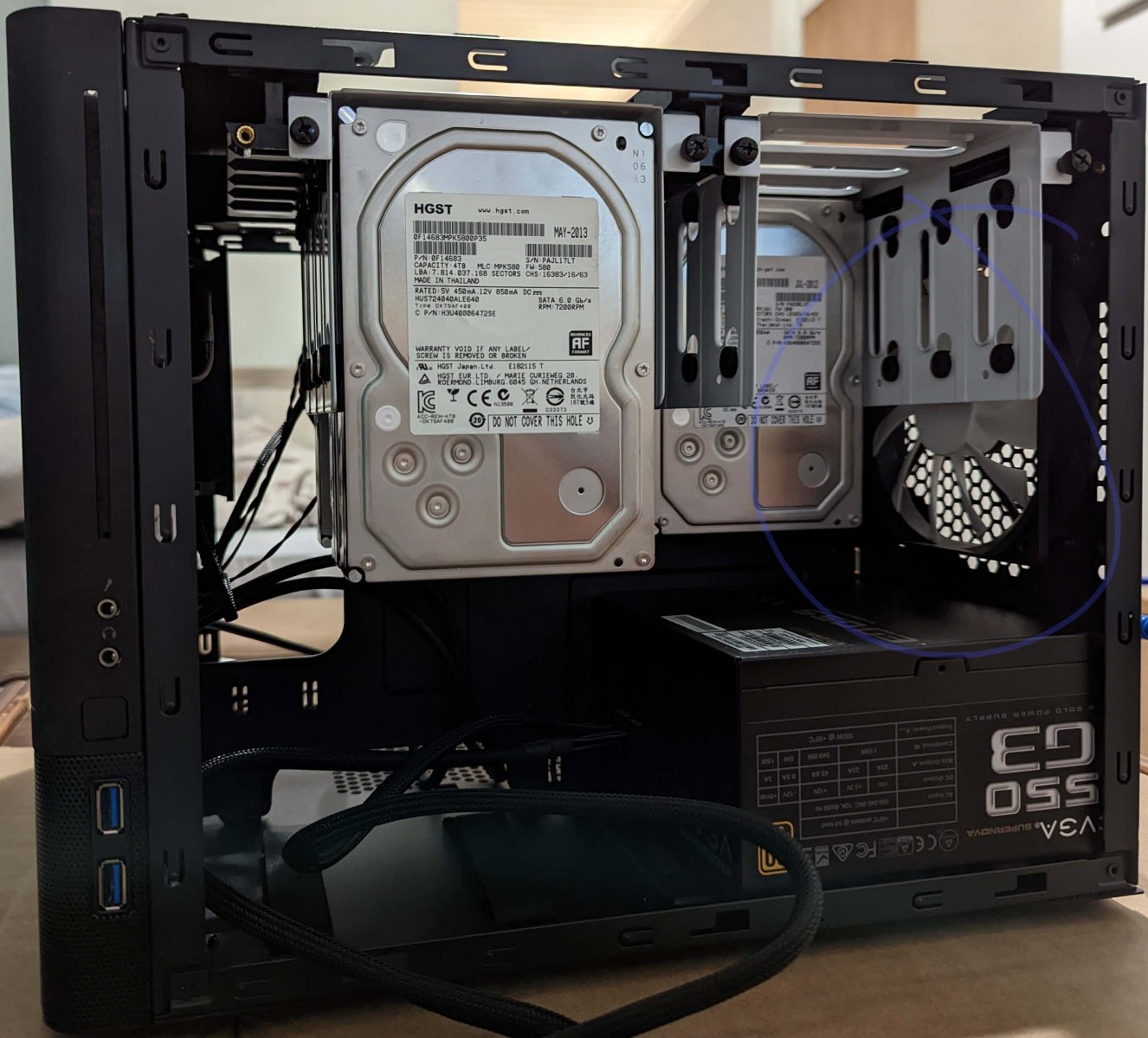

Consider adding a fan or two blowing to the HDD "rack".
Besides that it looks really good.
At the default speed, the CPU fan would fall to around 300rpm and I would get a bunch of alerts about the fan. That's why I wanna get PWM fans.
That's just some lint. There are no scratches. :smile:
There is one fan blowing directly on the HDD rack. I might add an extra, depending on how it performs later.
Make sure you ensure airflow goes across all the drives. Even slow properly directed airflow will remove heat better than a fast chaotic airflow.
Glad the case is in good condition.

Prime95 ran for 24hrs without a hitch.
The fan points right at the HDDs.
joeschmuck
Old Man
May 28, 2011
10,996

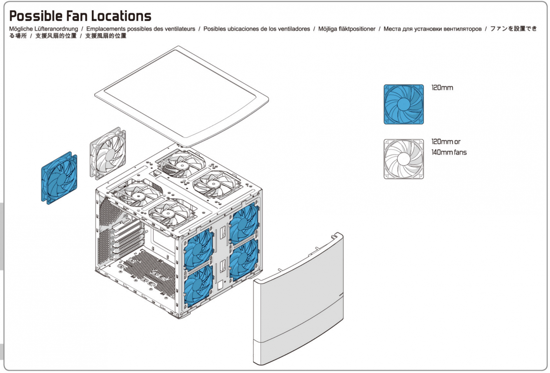

The fan looks to be off center to the hard drives, but that is just how the photo looks, could be very different in reality. Just make sure all those 7200 RPM drives get some much needed airflow.
It looks like the fan there could be replaced by a larger one, is that true? If so, I'd install a larger fan. Also, I'd cut out the entire grill structure and install a nice wire fan grill in order to promote better airflow. I dislike the small holes in the sheet metal grill, it offers too much resistance. but this would require cutting the case, not a fun task after spending this kind of money, andy you may need to remove everything before hand. I'd like to know how large of a fan this case would handle in the hard drive bay.
Cheers,
-Joe
Yes, that particular position can be upgraded up to 140mm fan. I can still add more fans, but will analyze and then add if needed.
