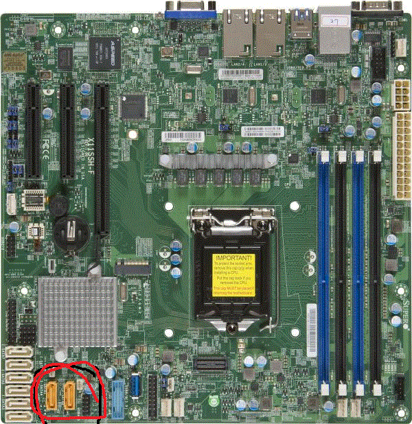

2 x SanDisk Ultra Fit 32GB USB 3.0 Flash Drive
By the way, the two yellow SATA ports on the system board can be used for regular drives, not just the SATA DOM, so you could boot from SSD instead of USB if you were interested in that option. SSD is much more reliable in the long run than the USB drives.

I was talking about the two SATA ports I circled in red.

Although it would be single point of failure.
Even a single SSD would have greater endurance than a pair of USB drives, but it is possible that you would have trouble getting FreeNAS installed and booting from the M.2. I am not sure how well that is supported because I have not used it myself.
