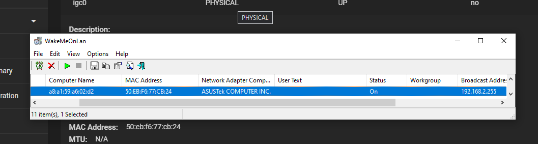

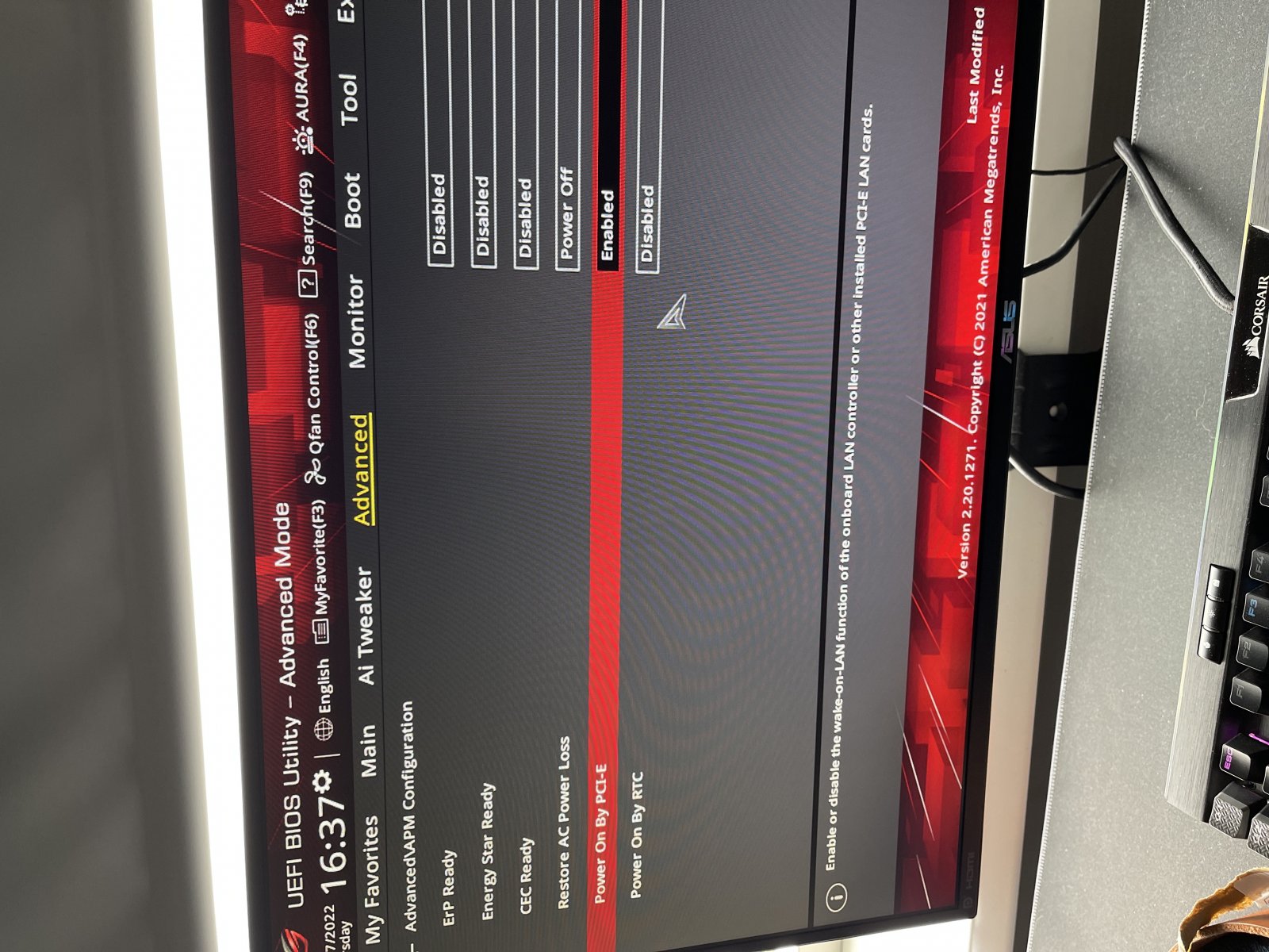

hello i tried setting up wake on lan but haven't got it working yet.
i am using a ROG STRIX B550-I GAMING motherboard with a Intel® I225-V 2.5Gb Ethernet card.
i enabled wake on lan in the bios. it is connected via a netgearGS108 switch. when i search for ip adresses the ip of the nas wont show, i have to put it in manually.
when i try to send the magic packet to the nas it sends it but won't start the nas. i have updated my bios to the latest version. i also tried disabling fast boot but this didn't work. the light on the back of the nas where the cable is in is on.
i have tried to do the same to my desktop with a msi b550 gaming edge wifi motherboard, this has a realtek netwerkcard. but this works fine.
is there aything i have to do in the truenas settings to make it work?
thanks for the help.

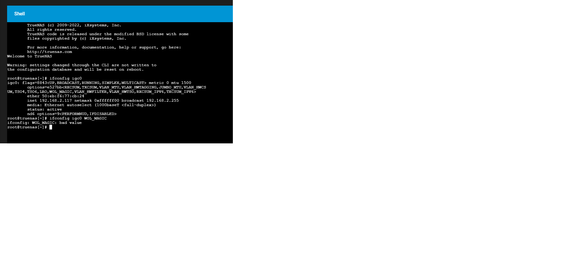

No, but search the forum for loads of threads on this.
Edit: ifconfig need to show option of WOL_MAGIC

No. The option just needs to be there, as it is from the screen print.
WOL works only between the IF card and the Bios.
How are you sending the WOL request ?
Is it to the correct MAC address ?

I use the wakemeonlan.exe.
i use the mac adress from the trueas interface

when i do this it says bad value.
You don't need to enter that option - you just enter ifconfig igc0 and check if it is there. Which it is if I read your screenshot correctly. And you are sure you are using the mac address that shown as "ether" in your screenshot?
i am sure that i am using the correct adress
