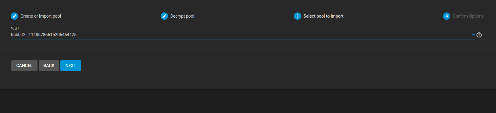

Are you sure there weren't any other devices that were part of Rabbit2? A SLOG, L2ARC, or special vdev? Because the zpool import output you shared indicates that all four disks were present and accounted for, and ZFS should be able to import that pool even if one (or two) of them were missing.

I am 100% sure there is no other names that's why I did Rabbit0 Rabbit1 Rabbit2.

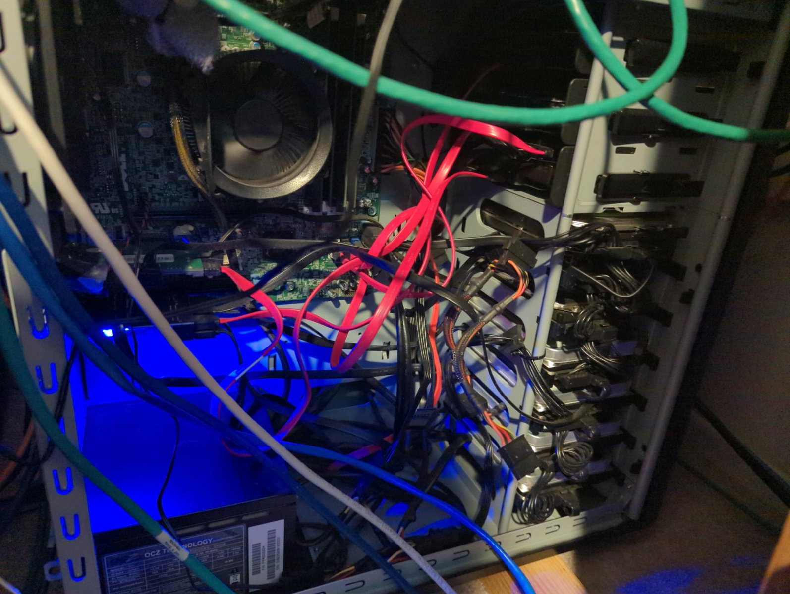

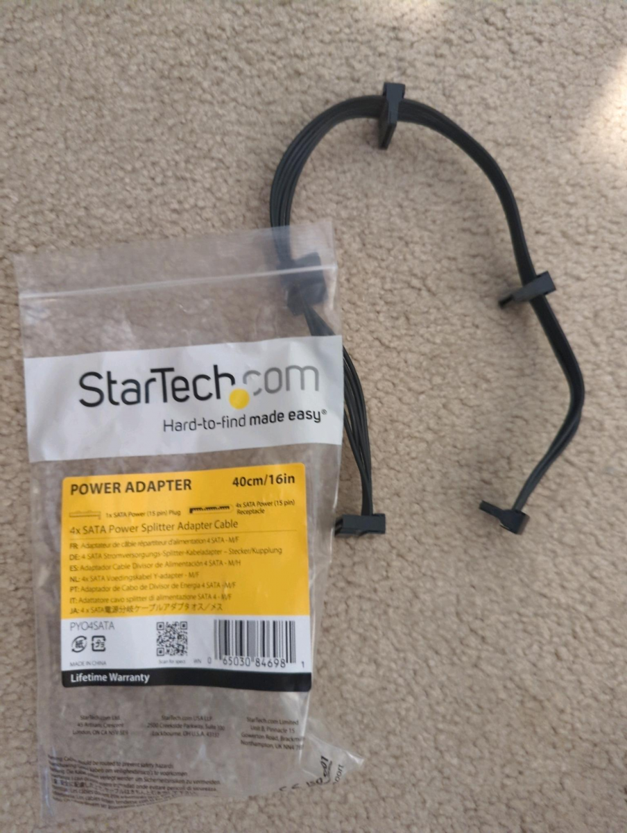

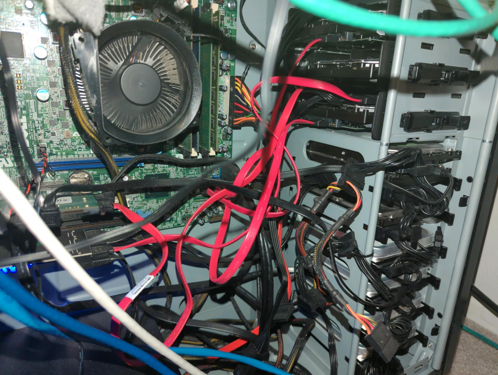

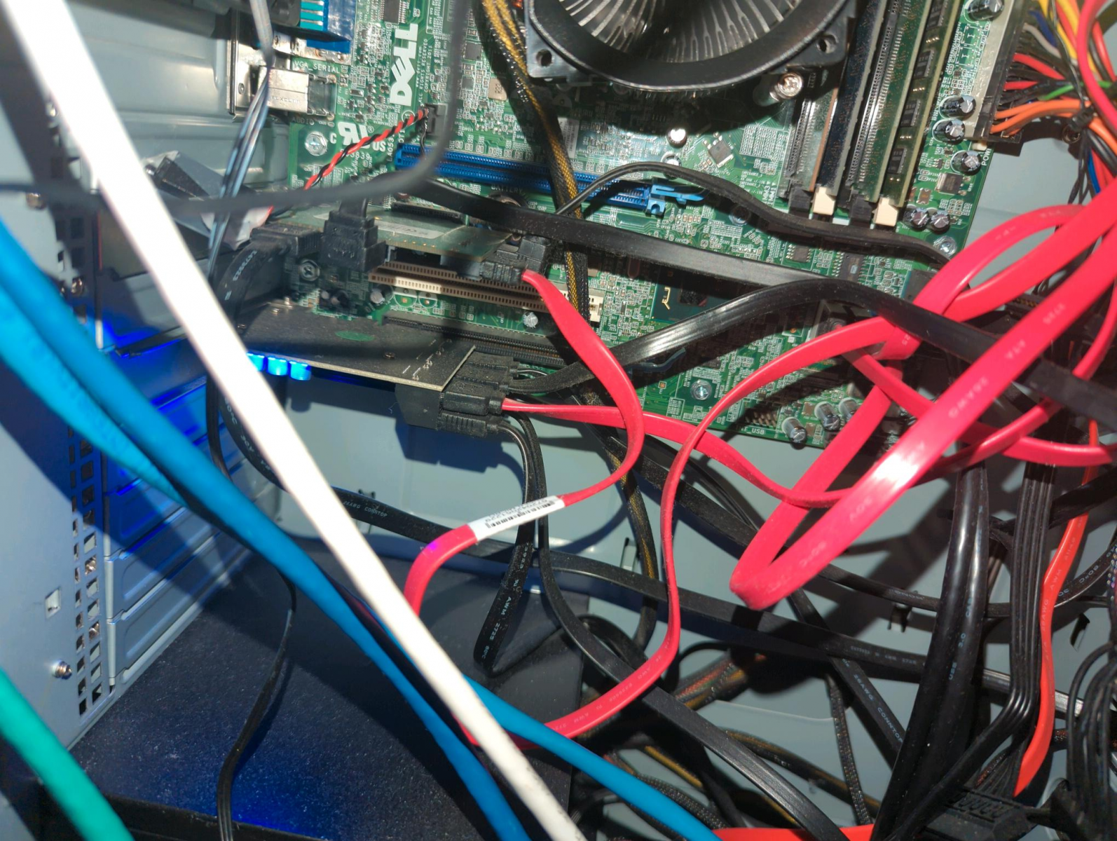

No judging, I was broke and this all I had to work with.. Not my best work.. I use these female connectors to male all the hard drives. I only plug into the main power supply with them. No daisy chains. 500 watt power supply. There are 3 chains for all the drives.
12 Drives total.

I can't tell what exact model of SATA cards those are, but they definitely aren't LSI HBAs, and they appear to be only PCIe x1. You're also chaining SATA power cables and there is definitely no support for staggered spinup on that platform so it's potentially close to having the inrush current of trying to spin up 12 HDD's causing your PSU some grief on startup.
I would recommend removing the 4x16T drives and putting them into your other machine (or conversely, removing all but the 4x16T from this one) and connect them directly to the motherboard SATA ports in either case. Try to import just this pool, and see what results.

On the little bit of research I've done, it sounds like you have severe data corruption likely caused from a cable issue, but this is new stuff for me so don't bank on my information. I doubt the problem is the hard drives. I hope you are able to recover your data.

Generally a bad or incorrectly seated one (both types, power and data, can suffer from this issue).
