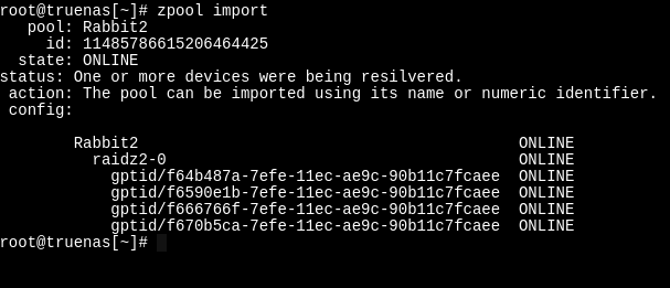

You certainly wouldn't want to do that--either of those, really; you wouldn't want to create a pool or wipe the drives. I'm afraid I have no idea what you're quoting with the "remaining 0, lifetime 6146" stuff, or how you have "4x16tb drives z2" and "Total of 12 drives running."
I understand from your post that a pool is offline. What happens if you try to import the pool through the GUI? What do you see if you run zpool import at the CLI?

NOT SUPPORTED AND WILL RESULT IN UNDEFINED BEHAVIOR AND MAY RESULT IN SYSTEM FAILURE. root@truenas[~]# zpool import pool: Rabbit2 - That's the pool, I need. id: 11485786615206464425 state: ONLINE status: One or more devices were being resilvered. action: The pool can be imported using its name or numeric identifier. config:
