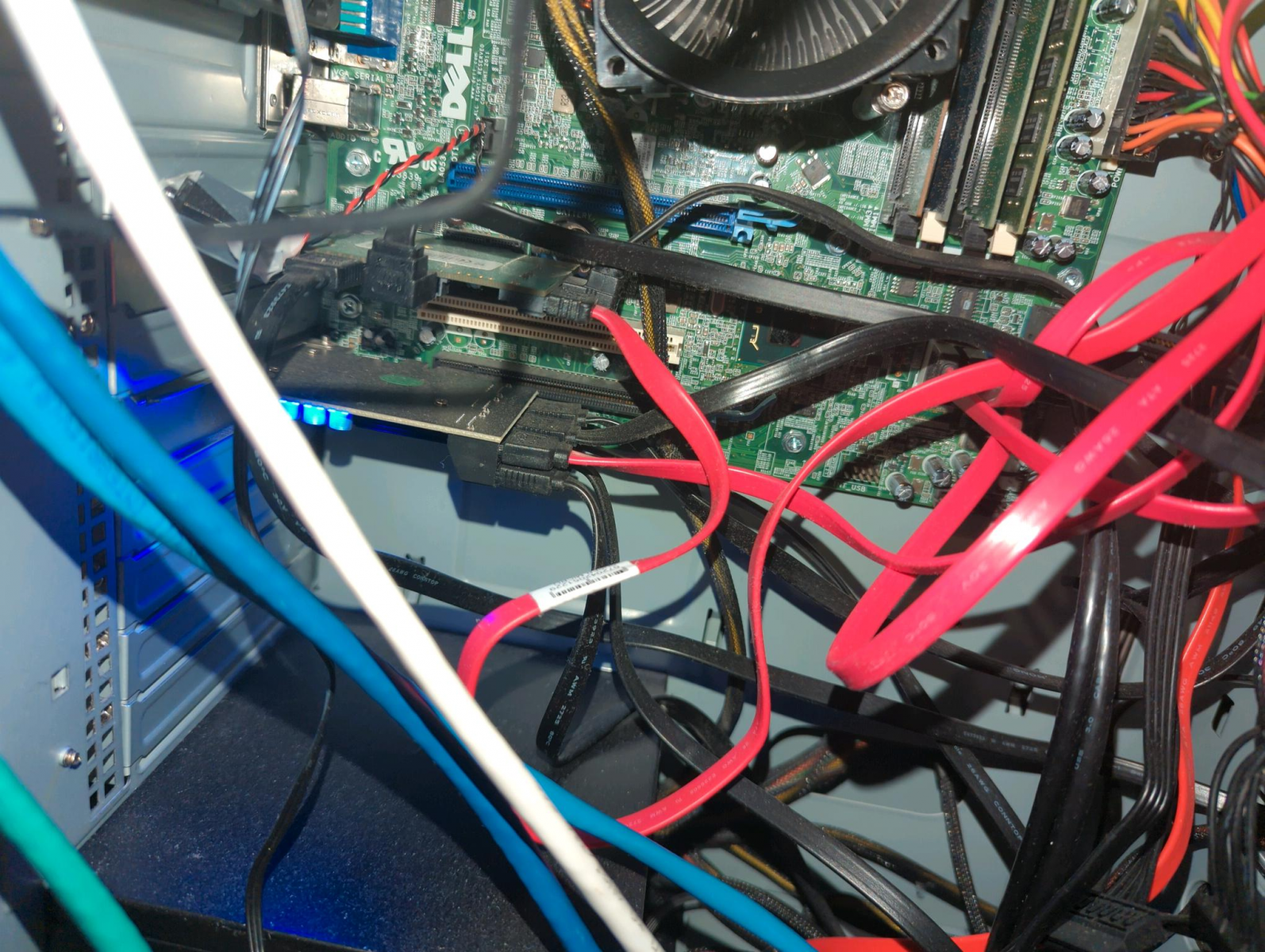

Pool is offline. i/o failure. don't use sata to pci 1x cards.. Drives are fine.

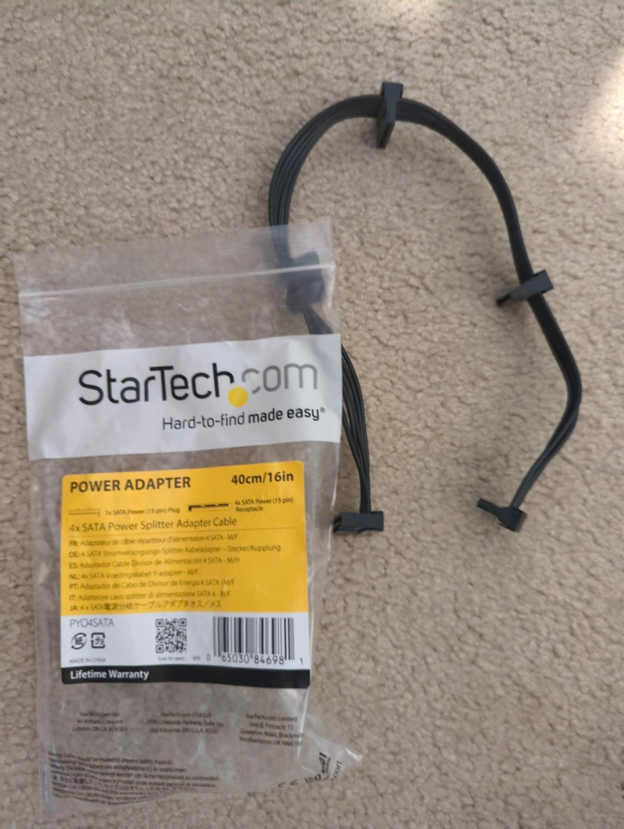

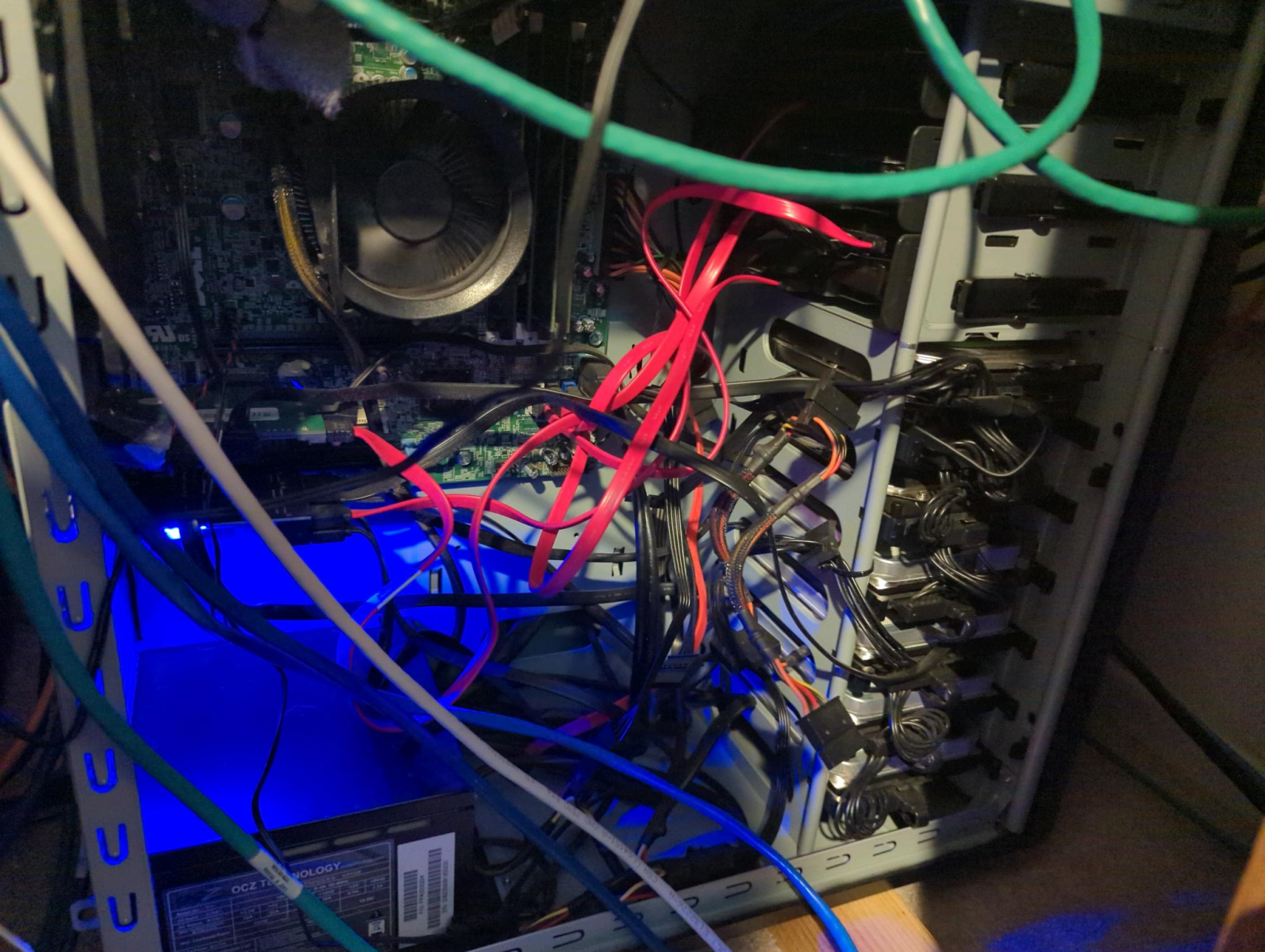

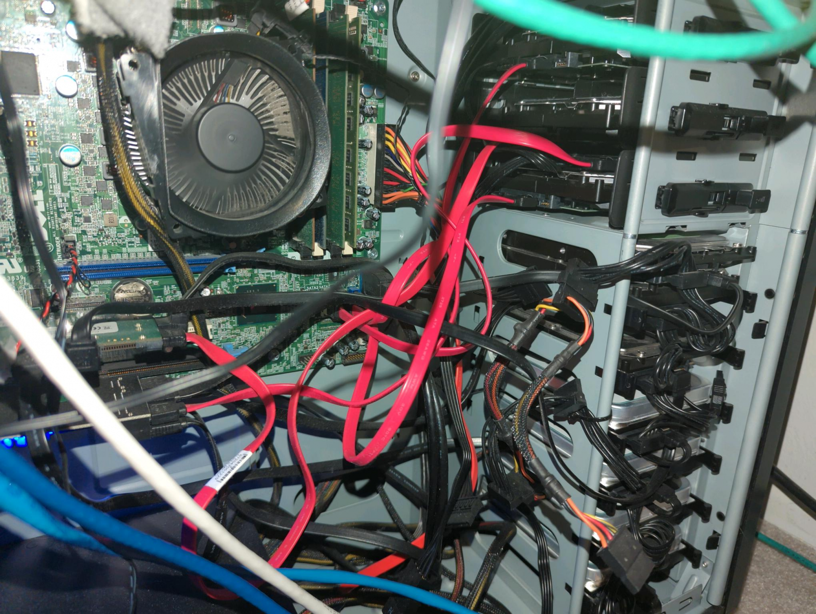

No judging, I was broke and this all I had to work with.. Not my best work.. I use these female connectors to male all the hard drives. I only plug into the main power supply with them. No daisy chains. 500 watt power supply. There are 3 chains for all the drives.
12 Drives total.
OMG, this looks like it came straight out of my nightmare. I suspect all your power cycle issues is at least, in part, due to this crazy card & cabling, which in turn, causes all the data corruptions.

I’d get at least 1 if not 2 ($50 each) LSI 9200 / 9211 cards with 2 or 4 mini sas to 4 sata splitters ($10 each) and a 650w seasonic psu ($150-200). Keep your case motherboard cpu ram for now but look to upgrade them when you have more budget. Also toss all those jank splitter cables you’re using at the moment.

500W? This is catastrophic. It should be in the 750 watt range, according to the precalculations made in the Proper Power Supply Sizing guide.
Should get rid of the power spitters for all the drives?
Absolutely. I'm ashamed that no one climbed all over that one. The "SATA power" connector is sucky. Each pin is rated to handle only 1.5 amps, and three are typically ganged, so the SATA power connector hardwired to your PSU is only able to deliver 4.5 amps for each of 5v and 12v. We know some drives to require spinup currents north of 2.2 amps on the 12V. If you have a three-way splitter, then you might be trying to draw 6.6 amps through a connector only capable of handling 4.5. This can (and does) cause SATA power connectors to melt and arc.

There's a good possibility, given the power cycle counts, that there were a bunch of brownouts due to overdrawing on the 12V. If that wire on the PSU side is 18ga, it should be able to handle 10-15 amps. If you have multiple SATA power connectors on the PSU cable, and you hook up two power splitter cables, you also get near the current carrying capacity of that PSU cable as well. In the meantime, both the power splitter's input connector and the PSU's SATA power connector that it is connected to are both experiencing occasional power overloads as the drives spin up. At best, this can cause brownouts. At worst, the plastic can start melting.
