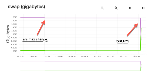

Ok, thank you so much for the help. This is all new to me and I was not aware that was too much. I thought with 32GB RAM I would be ok. Still have a lot to learn I guess.
Here is the output from the arc_max:
vfs.zfs.arc_max: 23748816896
I ran the command you said and now the output matches what you listed. Do I need to reboot or anything? I should also note that the VM is only there to run Ombi and I don't do anything else with it.

You shouldn't need to reboot - the memory change will take effect immediately. Check your reporting pane in the GUI, or swapinfo or top from a shell to see if it has reduced the used portion.
If Ombi can run in a jail, that will be more efficient memory-wise than a bhyve VM.
As far as the amount of jails to pick and choose - you no longer have the option of "add more RAM" and have to go with "use less" - perhaps each individual plugin can be tuned, for example by reducing concurrent downloads or adding other limits in the newsgroup/torrent scrapers, lowering Plex transcode quality.
But if all else fails, you're going to have to either move some of them to another physical host, or do your best Thanos impression and snap a few of them out of existence.

I did see it drop a bit, but not much. However, I should note that Jotta is doing an initial cloud upload of my entire library, so I have to guess that is a a big draw on resources.
Right now, it doesn't look like there is support for Ombi v3 on FreeNAS, which is why i am running in a VM. I powered off the VM for now to help with the situation.
It sounds like the best solution is to upgrade my mobo and process so it can handle what i want to do. Does that make more sense? If so, do you have a recommendation on what I should look for? I can start to monitor eBay and Amazon for used stuff and see if I can get a better setup?
