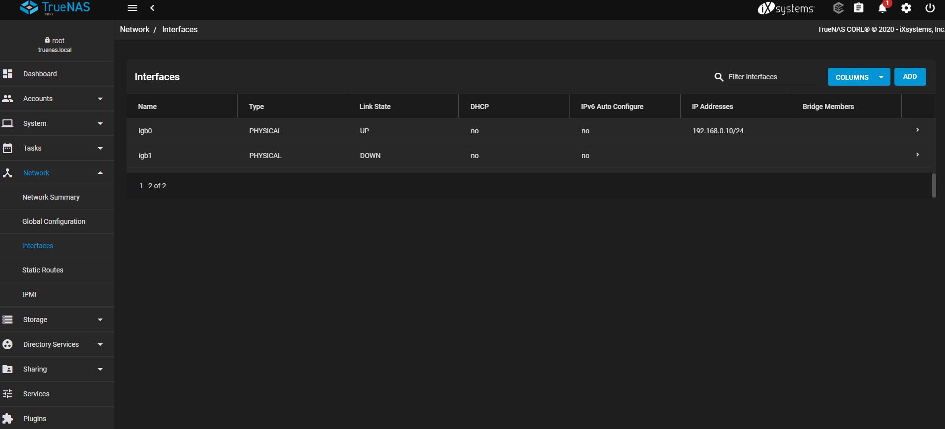

@nikinp Thx, one more piece of puzzle ... can you post screen of "Network -> Interfaces" please. Just to see if it matches the ifconfig output.

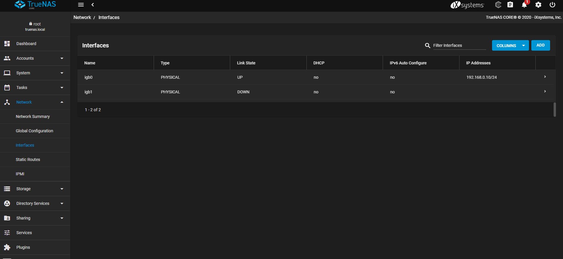

Ok i am not sure if the bridge is automatically created upon jail creation but not visible under the Network>Interfaces (i have it there because i've created it manually due to VLAN assignment).
Go there again, click "Columns" and check "Bridge members".
Also side-question ... do you intend to use VLANs?
nikinp
Sep 7, 2014
116
Go there again, click "Columns" and check "Bridge members". Then see/post screen if the igb0 has bridge0 listed as member?
I dont have an intended use for VLAN. I would like to make the most of the two LAN ports on the board, if this is something we can address as we troubleshoot this issue. I am assuming that the IPMI (3rd port) is unlikely to affect the issue here?

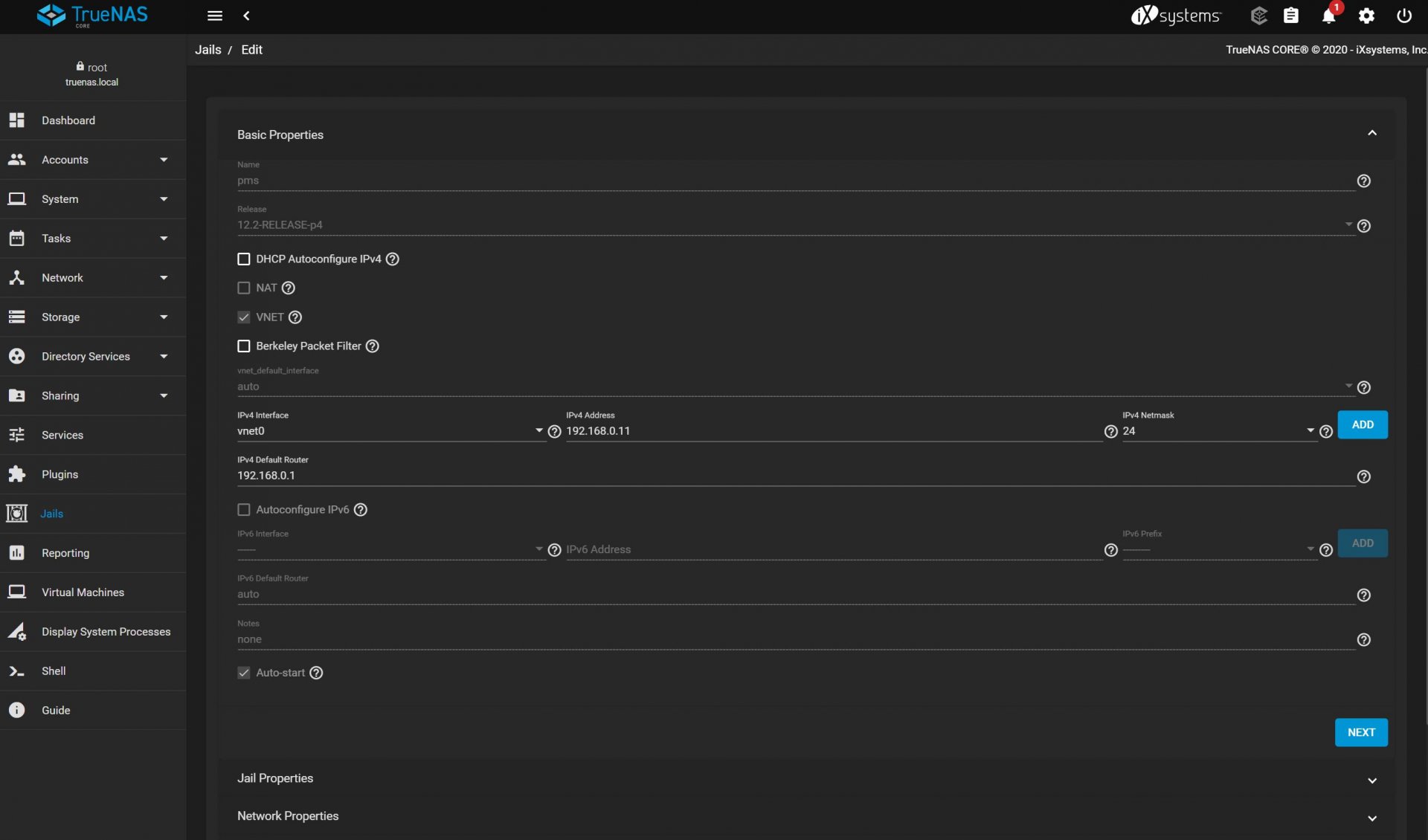

Anyway for your current setup ... edit the Jail and go to "Basic properties", then tick the Barkley packet filter, save and try to start Jail.

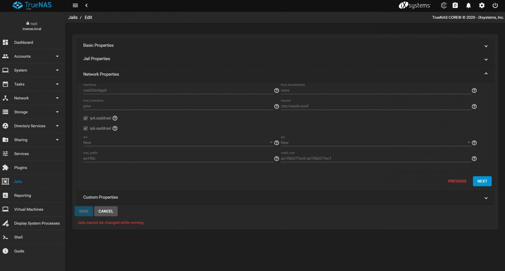

Anyway for your current setup ... edit the Jail and go to "Basic properties", then tick the Barkley packet filter and change the default_vnet_interface to None, save and try to start Jail.
To do this. I need to stop the jail to edit. However, when I try to stop jail, it seems to logmeout and then when I go back in the jail is still up.

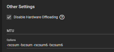

Disable the Hardware offload
... Two reasons ... It is mentioned in the TrueNAS docs (as it is causing various issues) ...
Disabling this is only recommended when the interface is managing Jails, Plugins, or Virtual Machines.
... and secondly there is actually a BUG in the FreeBSD 12.0 causing even more crazy issues. So yes, disable it and move on.
Go to GUI -> Network -> Interfaces -> edit the interface which is used as a parent for Jails and check Disable Hardware Offloading . Confirm the warning and save (confirm test, save, save...).
By doing so you will disable following NIC options: RXCSUM, LRO, VLAN_HWTSO, RXCSUM_IPV6
But that is not the whole story. There are additional options which are enabled by default and getting disabled upon first Jail start. So to prevent disabling/enabling them every time Jail start/stops we will just disable them by default.
So go to the interface config again and add -rxcsum -txcsum -rxcsum6 -txcsum6 to the Options field. So at the end it will look like this:
- Now Save, confirm everything and after that reboot the NAS! This is important because if you don't then these four excluded options are not persistent. It will allow you to start Jail w/o interruption BUT if you stop the jail these flags gets enabled again (I guess the state is cached/stored somewhere). After reboot try to stop/start your Jails. It should not interrupt your network.

RXCSUM,TXCSUM,VLAN_MTU,VLAN_HWTAGGING,JUMBO_MTU,VLAN_HWCSUM,TSO4,TSO6,LRO,WOL_MAGIC,VLAN_HWFILTER,VLAN_HWTSO,RXCSUM_IPV6,TXCSUM_IPV6
- And after adding the extra options (blue ones are removed)
So the output of ifconfig is:
- Initial: RXCSUM,TXCSUM,VLAN_MTU,VLAN_HWTAGGING,JUMBO_MTU,VLAN_HWCSUM,TSO4,TSO6,LRO,WOL_MAGIC,VLAN_HWFILTER,VLAN_HWTSO,RXCSUM_IPV6,TXCSUM_IPV6
- HW Offload disabled: TXCSUM,VLAN_MTU,VLAN_HWTAGGING,JUMBO_MTU,VLAN_HWCSUM,TSO4,TSO6,WOL_MAGIC,VLAN_HWFILTER,TXCSUM_IPV6
- Further options disabled: VLAN_MTU,VLAN_HWTAGGING,JUMBO_MTU,VLAN_HWCSUM,WOL_MAGIC,VLAN_HWFILTER
So that's about it ... hope it helps :]
//Note: The second part of the OPs question about not being able to stop the Jail is another/unrelated issue. That one is caused by the custom script

After some hours of hunting the root-cause we figured it out ... So for the future generations bellow is explanation what the (hell) was going on and how to fix/overcome that annoying behavior.
