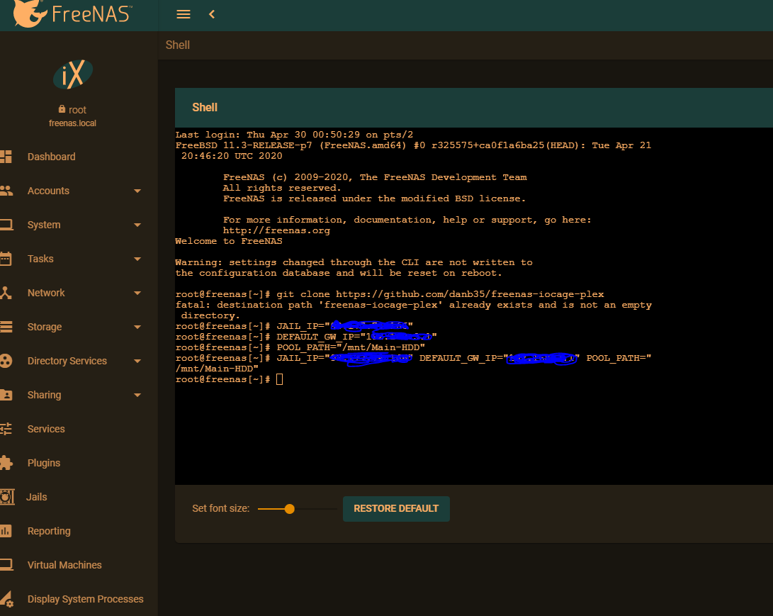

so I've ran the 'git clone https://github.com/danb35/freenas-iocage-plex '
But now I'm on this bit -
JAIL_IP="192.168.1.75"
DEFAULT_GW_IP="192.168.1.1"
POOL_PATH="/mnt/tank"
These values must be set. They correspond to:
  • JAIL_IP and DEFAULT_GW_IP are the IP addresses of the jail and your router, respectively.
  • POOL_PATH is the path for your main data pool's root directory.

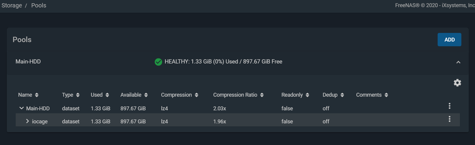

Where do i find the 'main data pool's root directory'? This is my drive below. I want to be able to access the drive on my NAS from my laptop to add films, music and tv shows.

Looks like it's /mnt/Main-HDD.

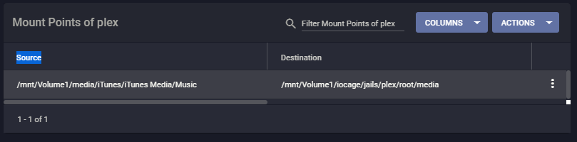

I would make a datasets under it for Films, Music, TVShows in which to store your media files (and make those SMB shares for Windows access). At the end of the plex install you will mount those source points to the plex destination (something like this):

How do i make datasets / mountpoints like this? I guess I'd make a Media one like you have done so then Music/TV Shows and Films within it

Both. The dataset is the structure that stores the data. The mountpoint is how you make that data accessible to the jail.

You're meant to put those lines into a plex-config file inside the freenas-iocage-plex directory:
You can use a graphical editor with SFTP support on your Windows machine (like Notepad++) to do this, or you can SSH into your FreeNAS box* and use one of the editors installed there like ee or nano. Do not use the shell through the web GUI; it's very badly broken.
*see https://www.familybrown.org/dokuwiki/doku.php?id=fester112:ssh_setup, but you don't need to bother with private/public key setup. And if you're using Windows 10 (or pretty much any OS other than Windows), there's a built-in ssh client, so you don't need to install PuTTY.

I enabled the SSH feature on Windows 10. Although I already have Putty for my switches.
Just saying 'Permission Denied (publickey,password). in PowerShell
Permission Denided, please try again in CMD
but managed to get it working in Putty

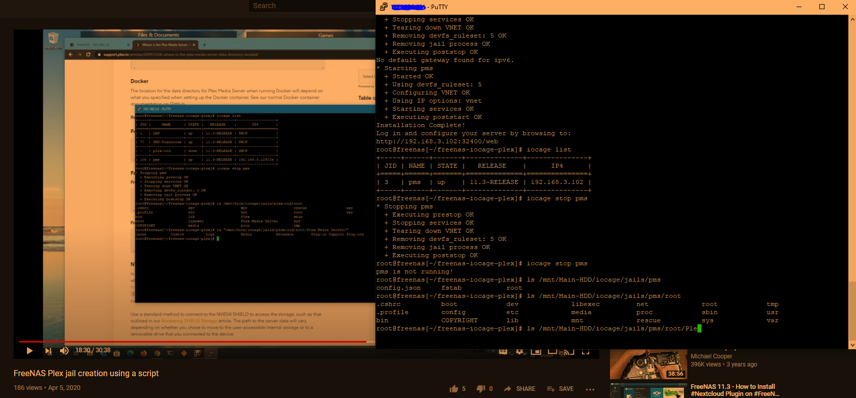

Would it be helpful to see someone walk through using the script? I created a video for that, which is at https://www.youtube.com/watch?v=GvM32lWc_r4
This is so helpful so far! This is the first time setting up plex on here & using FreeNAS really so got no films or anything. Just at this point here (18:30) and i can't seem to see the /Plex Media Server. Guessing as this is your old plex jail which I don't have.
Although to be able to access the jail outside the NAS on other laptop, I think the other people were saying I do need to move it out so it's accessible, correct me if I'm wrong.

I am moving data from an old jail to the new jail. If you don't have an old jail, there's no data to move. Just create plex_data as a dataset, mount it into the jail once the jail has been created, and ignore the entire rsync portion of the video.
