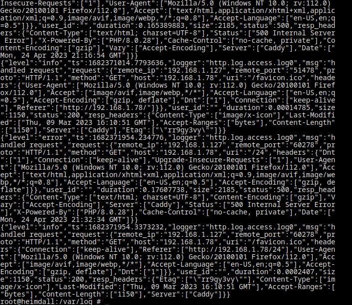

Hi !
I Installed Heimdall using the guide successfully, all seemed well, however when trying to access the webui I get 500 Server error.
I've no idea how to sort this, im on TrueNAS-13.0-U4 and this is my heimdall log:
Any help would be greatly appreciated.
