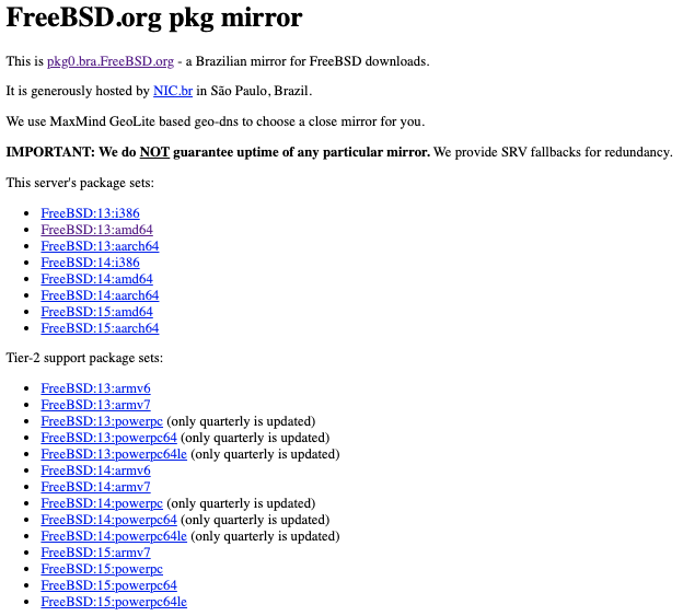

i'm having the same problem as cockrell960 my jail has internet and correct DNS settings it can ping and google with no problem, but no pkg from FreeBSD 12, if i create a Jail with FreeBSD 13 pkg installs correctly, when i visit i cant find FreeBSD 12 package is it not supported anymore?
Patrick M. Hausen
Nov 25, 2013
7,776
mrarrieta
Jan 22, 2024
4
Thanks Patrick M. Hausen, that must be the reason me and cockrell960 are not able to install pkg in FreeBSD 12 jail which is required for PhotoPrism to work, any ideas on how to proceed here? i really would love to install PhotoPrism in my TrueNas Core!!.
Patrick M. Hausen
Nov 25, 2013
7,776
Use FreeBSD 13 in the jail?

Sadly this guide does not work anymore, because the FreeBSD Version is not available anymore.
Error:
Error fetching http://pkg.FreeBSD.org/FreeBSD:12:amd64/quarterly/Latest/pkg.txz: Not Found
