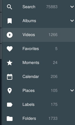

By the way - it took 2 days to go over my photo collection :)
