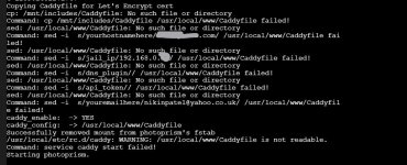

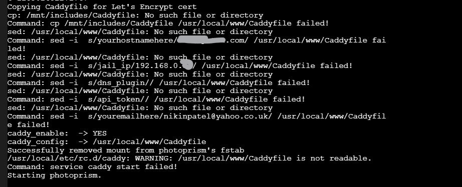

It did work. I can get access to it within the network at http:<<ip>>/2342
But having Caddy errors. Wonder if you can help work out what's wrong?

Yes. So sorry. Another script bug. Try a git pull and run it again.
I re-installed and no error messages on Caddy side. See below.
