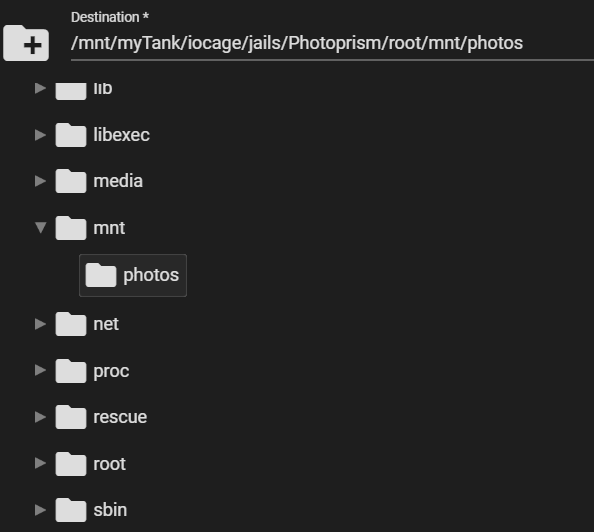

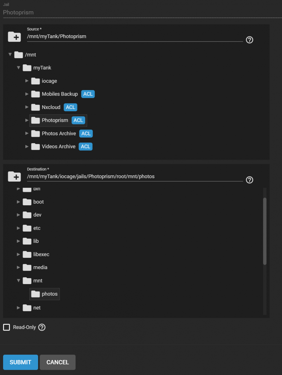

Select the source by navigation, then as a destination navigate to Photoprism/root/mnt/photos and just write /originals at the end; I also mounted it read-only, I don't want Photoprism to be able to touch my original photos.
You can add as many mounts as you want. It is not a second destination, is a new mount.

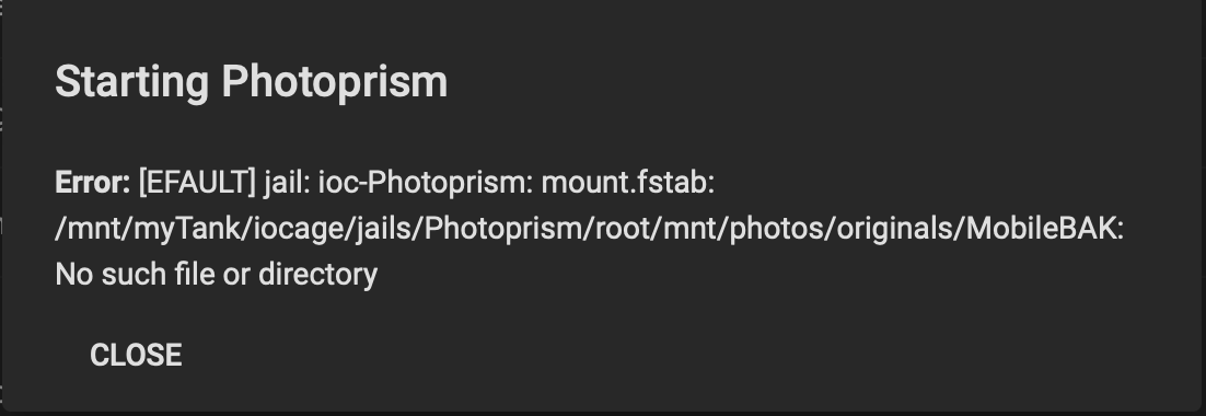

That didn't work, Jail doesn't start
it throw below error

If that folder where you want to mount does not exist, it makes all the difference in the world. You can use any path as source, but the destination needs to be in /originals OR you need to manually create a subfolder there before mounting.

i can't mount 2 folders to mnt inside the jail ,
simply the jail doesn't start !
an throw fstab error :no such file or directory

The destination folder inside the jail where you want the mount to occur must exist. If it doesn't, you need to create it manually. By using the shell and the mkdir command. Otherwise the jail won't start.

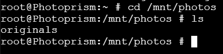

i tries your method in a new jail , when i create a mount point , i dont see the folder i've created , , but i can see the folder from shell !
am i missing something?

You don't actually have to create the directory, you can just specify it in the destination and it will be created for you.
In the destination field just put
/mnt/myTank/iocage/jails/Photoprism/root/mnt/photos/originals

@A.saleh I think I see the issue you're having. When you are mounting your existing photo collection, you won't be able to browse directly to the originals folder because it has been created within another mounted dataset that is inaccessible while the jail is stopped!
For the Destination in the Mount Points dialog, you have to browse to /path/to/jail/mnt/photos and then manually type the extra "/originals" on the end. I've just updated my instructions again to clarify this.
Have a go and see if that works. If you're still having problems, post a reply here and I'll try and help.
