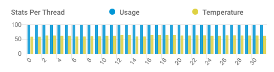

Interestingly, even after installing all of them, make config-recursive still has me configure all of them, though it doesn't look like it's building them. Still, it's maxing out the CPUs:
Unfortunately, after about 10-15 minutes, it fails:
