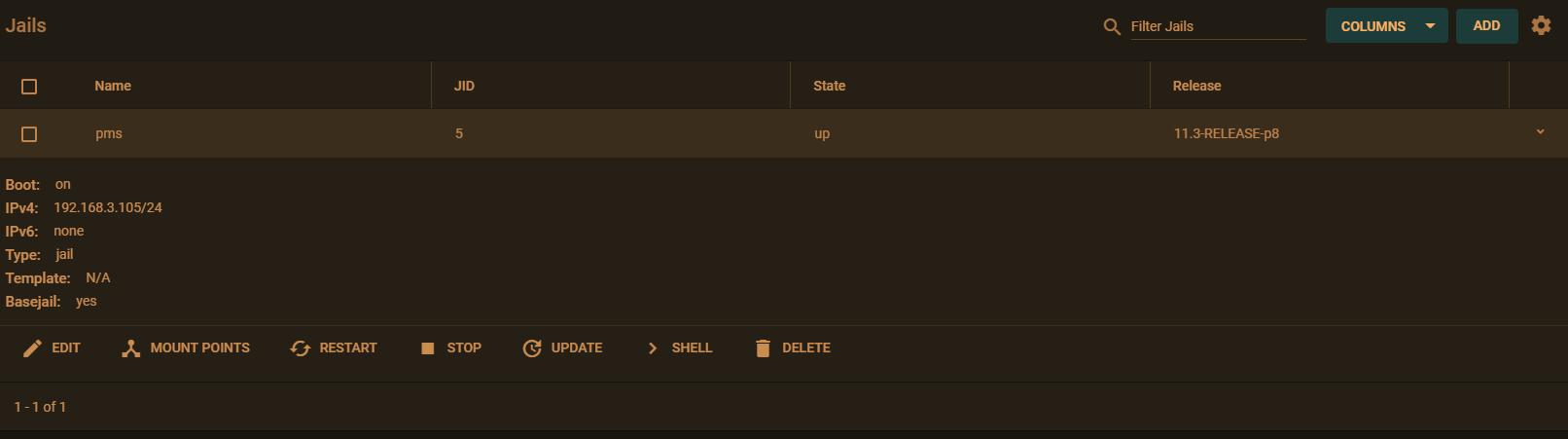

I don't see any evidence that the plexmediaserver service is running, just that the jail is running.

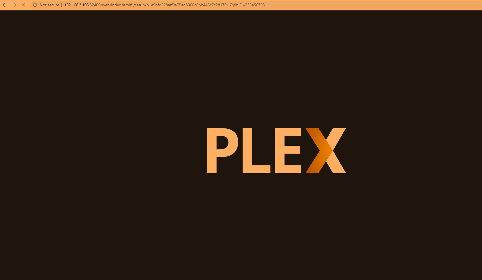

I'm not how i can prove Plex is running then... I just tried changing the IP but made no difference.

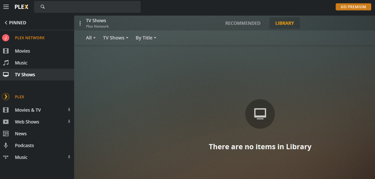

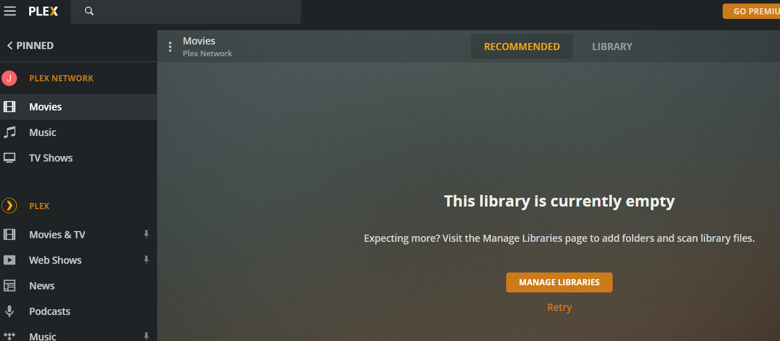

I think the permissions are wrong or something... Plex is unable to see the items in the Media\Movies & \TV Shows and \Music Folders.
There is nothing in this folder, but there is in the TV Shows folder & it's like it can detect it but can't see/show it...

You are right that this is likely a permissions issue. You can try and set up a Media share with "pristine" permissions, then compare to yours and see where they differ. I have a video that discusses basic permissions, including for Plex, at https://youtu.be/9Xsgsap0wgQ
