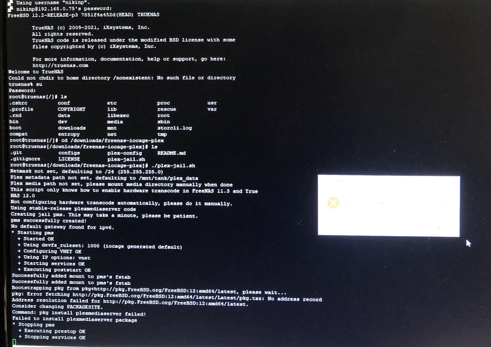

I am trying to use the script but it is failing and logging me out of freenas UI and giving putty error ‘network error:software caused connection abort’
When I go back in the jail isn’t there:
Here is putty output

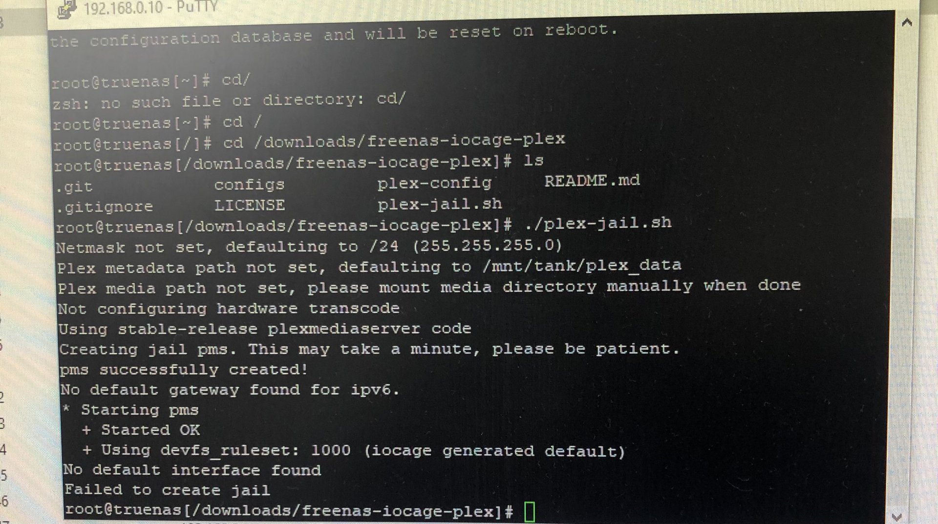

I am struggling here. I am using system 1 (new build) as per my signature.
Last night I was running script and it kept disconnecting putty and freenas UI with a network disconnection.
I have two ports on the board, so I connected both (no settings in the UI change).
Now I get message ‘no default interface found’ see pic below.Searched forum but not getting anywhere.
help much appreciated

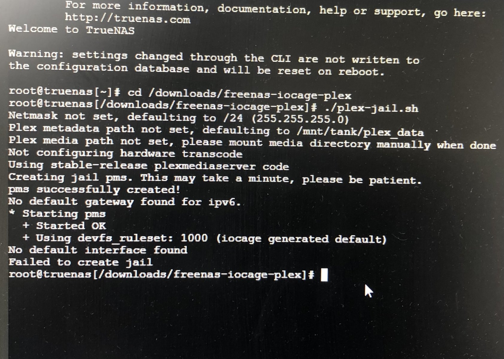

Done as suggested. But same result as post 66. Pasted again below:

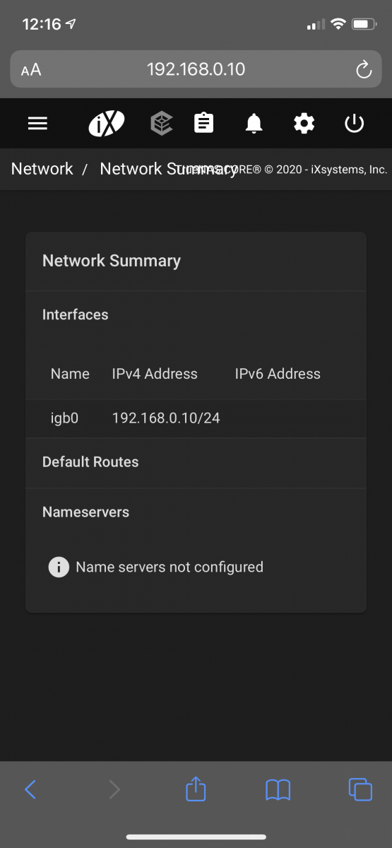

Hmmm what's the content of Network>Network Summary:
nikinp
Sep 7, 2014
116
