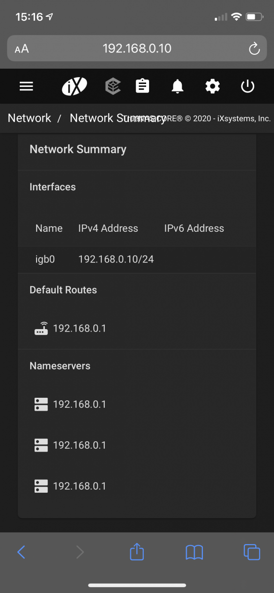

Please configure your default gateway - also you can put the same address in for the three nameservers (at least for now) while you are at it - in the Global Configuration page. and post the new Network Summary when done.
nikinp
Sep 7, 2014
116

Looks good.
Can you ping 192.168.0.10 from the4 shell command line?
What's in your plex-config file?

Yes I can ping it.
Config-file
JAIL_IP="192.168.0.11"
DEFAULT_GW_IP="192.168.0.1"
POOL_PATH="/mnt/tank"
USE_HW_TRANSCODE=''1"
I have re-set the server, following network change. Let me know if I should re-try the script

Yes, definitely. This all looks OK.

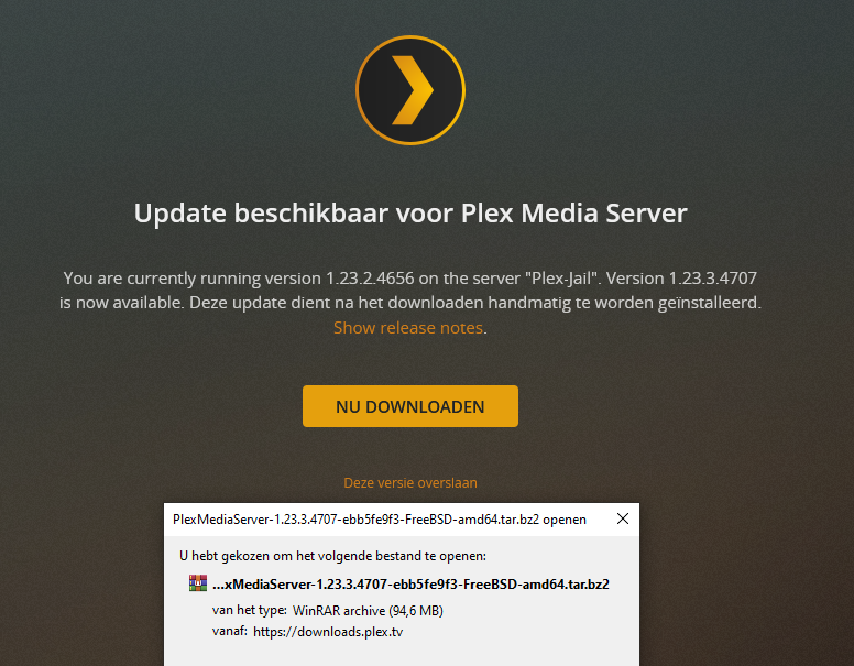

Thanks a lot for the script! I managed to get it working on my TrueNAS12.0-U4...
I'm wondering if the Plex update mechanism is working as expected though?
root@Plex-Jail /]# crontab -l
#Upgrade all installed packages and restart Plex
18 3 * * 0 pkg upgrade -y && service plexmediaserver restart
I suppose this does a weekly 'pkg upgrade', which should include the Plex package.
However, is it normal that Plex notifies me that an update is available, while pkg upgrade doesn't find anything?
[root@Plex-Jail /]# pkg upgrade
Updating FreeBSD repository catalogue...
FreeBSD repository is up to date.
All repositories are up to date.
Checking for upgrades (1 candidates): 100%
Processing candidates (1 candidates): 100%
Checking integrity... done (0 conflicting)
Your packages are up to date.
15,504
Very common. Plex pushes out new releases pretty frequently, and there's often a bit of a delay (not usually more than a week or so) before a FreeBSD package is available.

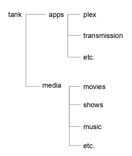

Jan 4, 2014
1,644
This dataset structure works for me...
...which would make...
PLEX_MEDIA_PATH="/mnt/tank/media"
PLEX_CONFIG_PATH="/mnt/tank/apps/plex"
Notes:
  1. These are datasets and child datasets under tank, not directories.
  2. Doing it this way, from the storage UI it's easy to see how much space each type of media is occupying.
  3. It's good practice to have the config data for each application stored under a root dataset like apps.
elorimer
Aug 26, 2019
194
@ThatGuyAZ: It wasn't clear from your post whether you were following footnote #1 above, which would have been my only comment. The other reason for having child datasets under /tank/armored is that you can set up different snapshot/replication and permission scenarios within your main pool. My main pool is about 12 TB, 35% utilized, but my /Movies dataset is 1.7TB, so I can replicate it to a 2TB local backup pool monthly. The rest of the datasets are snapshotted daily and backed up to a 4TB local backup pool. The plex user doesn't have permission for those other datasets.
