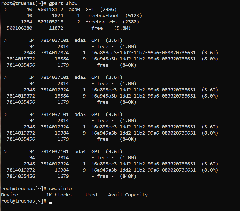

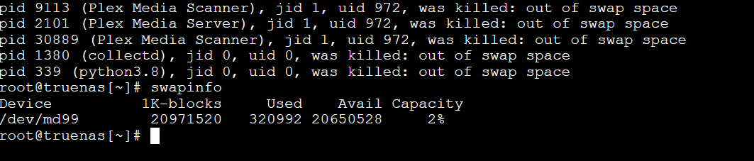

It seems to be related to a swap issue as per the dmesg.
That is in turn related to the arc something?? I need some help here. I'm out of depth.

Looking in this a little further, it looks like there is no swap in my system. I set my swap to 40GiB in the GUI, but checking "swapinfo" shows nothing. I'm sure this is not normal behavior.... right?
Swap space is reserved when you create the pool. And obviously you did with swap space set to 0. You cannot change the size after the fact.

So after moving the swap file to the pool, it persists and my script looks as follows:
echo "md99    none    swap    sw,file=/mnt/NAS/Backend/swap0,late    0    0" >> /etc/fstab
swapon -aL
A quick reboot shows the swap file is correctly attached. Now I'm going to do some testing to see if there is still an issue with plex
itractus
Mar 1, 2021
39
After some testing, it seems to not work.
Not only does the service stop, I also cannot dmesg anymore, getting the following error when I do:
The jail now also shows as 'down' in the morning after a night of running plex.
Any pointers?
Patrick M. Hausen
Nov 25, 2013
7,776
You cannot call dmesg inside a jail. Try on the NAS system.
