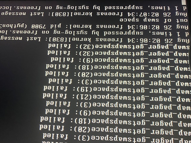

I have had my Plex running for a couple years and am running TrueNAS-12.0-U8.1 with Plex plugging 11.3 with no issue until about a three weeks ago.
What happens is Plex no longer sees my share until I restart the plugin . When checking TrueNas was I see this the attached file .
Which leads me to believe something is failing on the swap ..
I see on the following post where it was more than likely swap ( and the error attached )
But this user didn't have swaps set I do ( see out put below ).

I manually updagrade Plex to the latest and Trues Nas is current . Nothing else has really changed
Thanks for any help and direction ,

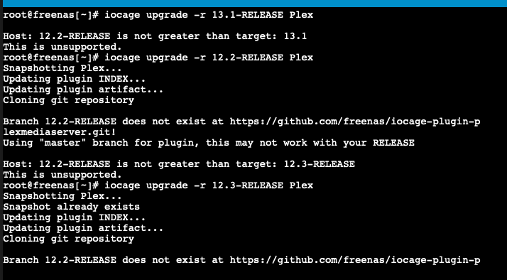

I tired iocage upgrade <jail_name> -r no luck :(

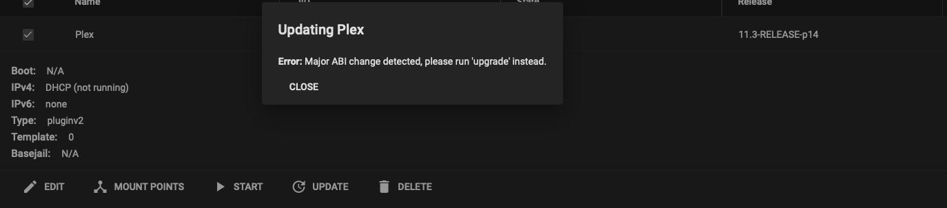

there's an update button in the GUI that updates your jail to the latest on whatever version you have .. IF you are running 12 something .. then it will only update to 12. whatever
To Update to say 13 . .then you have to go into the main shell (not the jail) and type
iocage upgrade -r 13.1-RELEASE WhateverYourJailNameIs

I tired the button it fails

tried the code different 13.1,12.1-12.3 no luck . is there a way to set the jail to restart nightly ?

are you running a plugin or a manual install? If the Plex plugin .. then you are stuck on whatever version of the jail the plugin is
That is why I switched to a manual install quite awhile ago .. all around easier to keep up to date with both Plex and the jail itself
