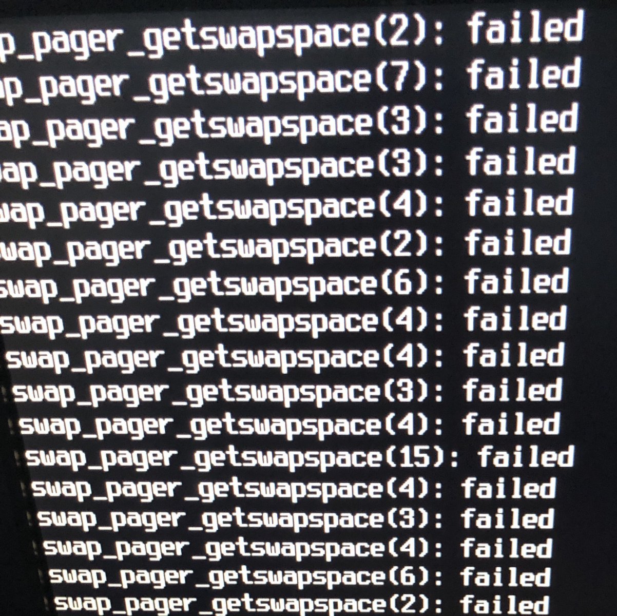

I am actually running the Plex Pass version, but I know what command you’re referring to. Yes that will restart it. So will restarting the jail. It does appear that the service stops with the jail still running. I don’t know if Plex crashes. I thought I read that if it really crashed it with generate a crash log labeled as such. I have no idea how to troubleshoot freenas to see if there is a log file that may tell me what is happening. I also get this on my console and in my nightly emails. I’ve posted about it too with no resolution and it not being fixed with the upgrade to RC

Swap space errors could be somehow related to the crash of Plex inside the jail, so I would focus your time on fixing that first.
You can try looking at the output of dmesg at the CLI to see if you get something more useful to look for, but you should also search on the errors in your last post to see what could be the solution for that.

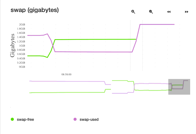

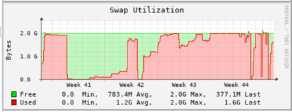

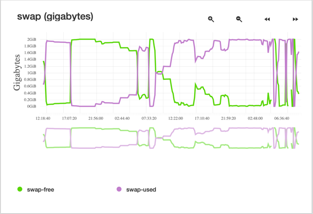

I have been trying to read about the swap issue and a lot of people seem to look at the graphs so i pulled one from the legacy ui and one from the new ui. I'm not entirely sure what it means, but the pattern seems to be increasing toward the end (right side) in frequency.
9,700
So clearly that much use of such limited swap space is going to be a problem.
Normally you would have 2GB of available swap on each disk (for the first 5-10 disks in your system), so something has gone wrong there to leave you with only 2GB of swap in total.
We can also do some more investigation into why a system with 32GB of RAM thinks it needs to use SWAP at all... Are you running VMs? Do you use L2ARC? anything else we should know?

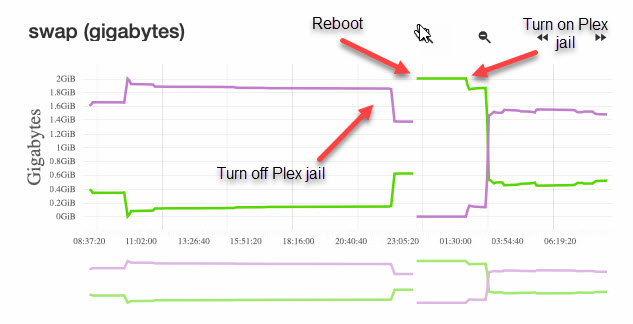

So I did a few tests trying to figure out the swap issue and get some direction. The first thing a did was turn off several jails. The ones I turned off seems to have virtually no effect on the swap graphs. However, when i turned off Plex, I immediately saw the graph drop from 2gbs down a bit. Then I turned off all jails and saw it drop even more. I never did get it to show the inverse of what I posted (meaning the swap usage below the free like it starts after a reboot). However, it least I figured out a lever I could pull.
Next I removed my Plex jail completely. I had previously installed in a jail running 11.2, and this time I installed in a jail running 11.1. It still after a bit of time started to drive the swap mem up.
Right now I am only running a few jails just to see if I eventually hit the limits of swap and get the message.
If I can see around the time the swap began to climb, is there a log with time stamps I can compare against to see what is happening with the system around that time?
**UPDATE**
I turned off my Ubuntu VM and it had a pretty dramatic effect on the swap memory. I suspect this is the main culprit, but don't know how to fix it.

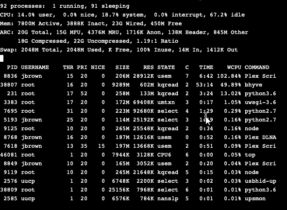

A few more updates to hopefully help troubleshoot this.
Noticed this... Plex stopped right at the end of this: (wondering why swap free is gone, does that mean its at zero?)
Looked at processes at that time:
Shell after trying to restart:
