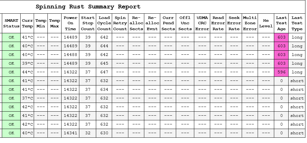

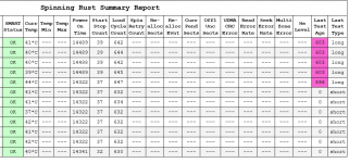

Possibly a silly question, but I often see the "Last Test Age" come up as something that needs attention. I was wondering what the number refers to?
The long tests currently run once a week, and short once a day.
joeschmuck
Old Man
May 28, 2011
10,996
Not a silly question. The value is the number of days since the last SMART Short or Long tests was conducted as reported by the drive. And in your example the last test was a "long" test. There is a value that you can set as the trigger point, by default it's 2 days, you could change it to 1000 days if you desire, but I would never suggest that.
The error could be caused by two things:
1) That it has been that long since the last SMART test, meaning maybe your drives are not listed to be included in the SMART Short tests like the rest of you drives are. This does happen where drives get dropped for various reasons.
2) The other possibility is the SMART Short/Long "Hours" are not actually representative of the power on hours value when the test occurs.
I've seen both situations. I would first verify that you are actually conducting testing as you expect. If that is correct then PM me the output of the script "-dump" option and all I really need are all the attached files.
So how to fix this if the drives are reporting incorrectly... One of the last updates I made was to allow customizing each drive if needed. You can use "-config" to generate this and you would IGNORE the Last Test Age data. This will add an entry to the multi_report_config.txt file that are specific overrides for these four drives. But I'd like you to still send me the -dump data if that is what you do. I just want to verify you are doing the correct thing and if I need to make a change to the script. If you feel the -config option seems confusing, I would ask you to provide me comments and suggestion on how you would improve it, keeping in mind that this a script and not a nice GUI. I can also provide you an updated config file that you can just drop in and the configuration is done for those four drives.
But first, find out if the SMART tests are being run. At face value it's been almost 2 years since a SMART test was run on those four drives.

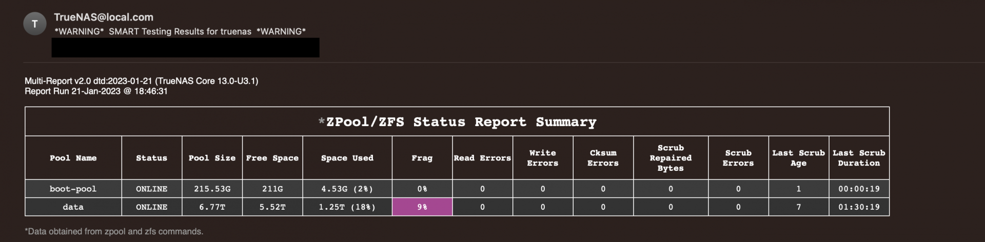

Seems like the frag parameter yields a warning, though frag is 9% over here.
joeschmuck
Old Man
May 28, 2011
10,996
Thanks for the heads up. I just checked the script of course I didn't check for any fragmentation above 5%. The Hex math got me yet again. We now convert it to decimal (base 10) and things are working again, I hope for everyone. I've updated the file, please download it again. Version is now 2.0.1 and includes the fix. Hope this works for you. Please let us know.

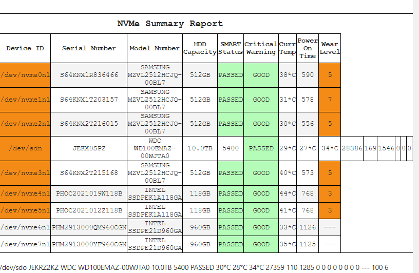

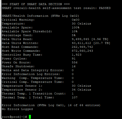

I Have a fairly complex setup for my system. I just ran an output.
I posted the update, or thought I attached it. Must have just removed it. I attached it again above. But yes, the github location will work as well, it's been updated.
I just downloaded it and ran it through my system, which is kinda complex. Weird error where it thinks one of my SAS drives is an NVME drive. Full report is here: https://fuscolabscom-my.sharepoint....lDiiW1XnjjB7sBdXWjoTcIoluxLWZvMz3Zvg?e=c32IK3
I'm also not entirely sure what the "Wear Level counter" indicator means.
The configu file says:
Does that mean that if I've used 9% of the drive that it will alarm?
The script is triggering a WARN status, but I've only used 5% of the drive's endurance with 95% remaining.
In any case, this is really cool. Thank you for your hard work!!
