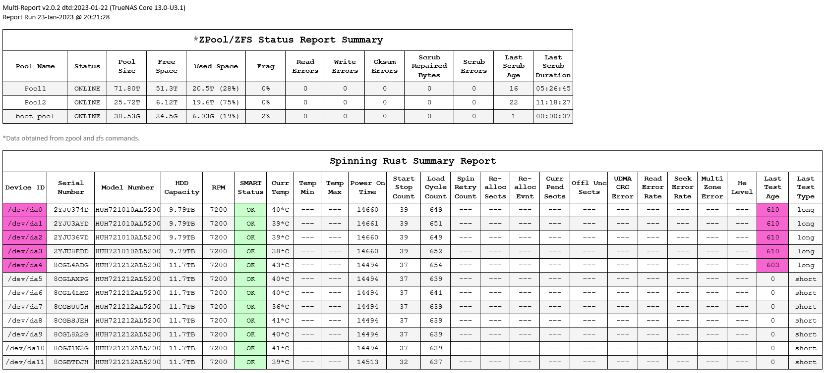

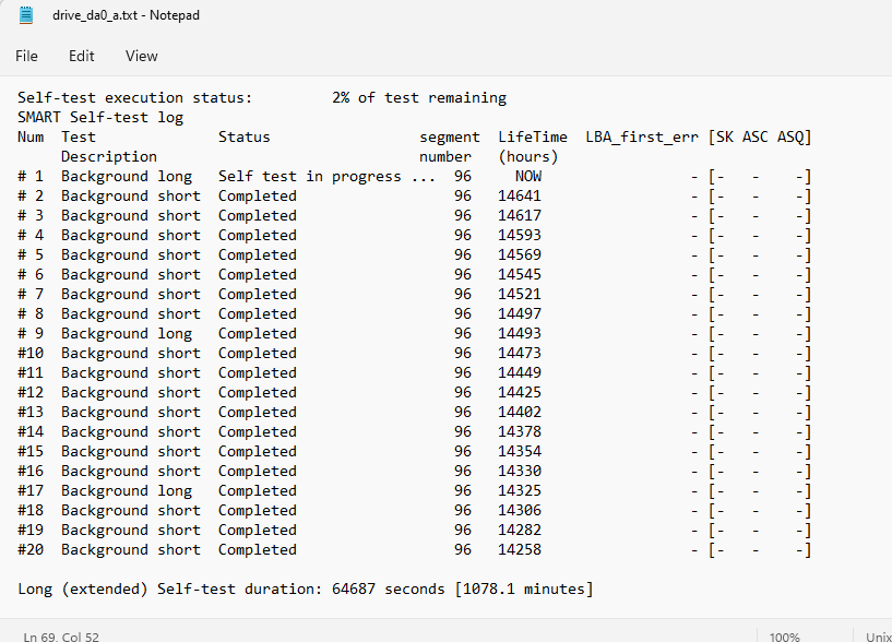

I just updated one of my TrueNAS servers that is having the issue with reporting incorrectly on the "Last Test Age". Unfortunately that error still seems to persist. Eg, as you can see from the attachments, it tells me that drive da0 has a last test age of 610, but using the -dump command shows that da0 has completed short and long tests.
