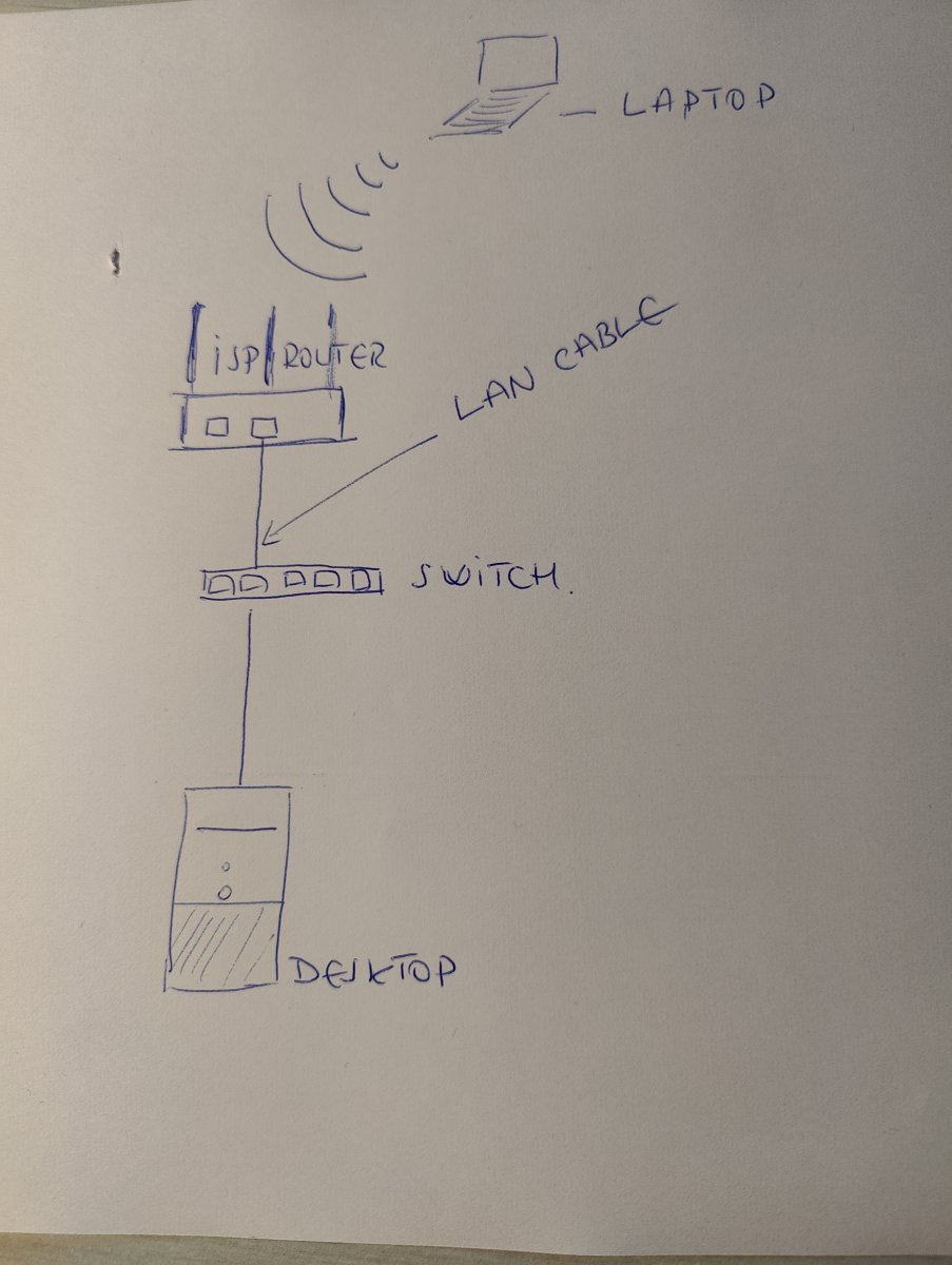

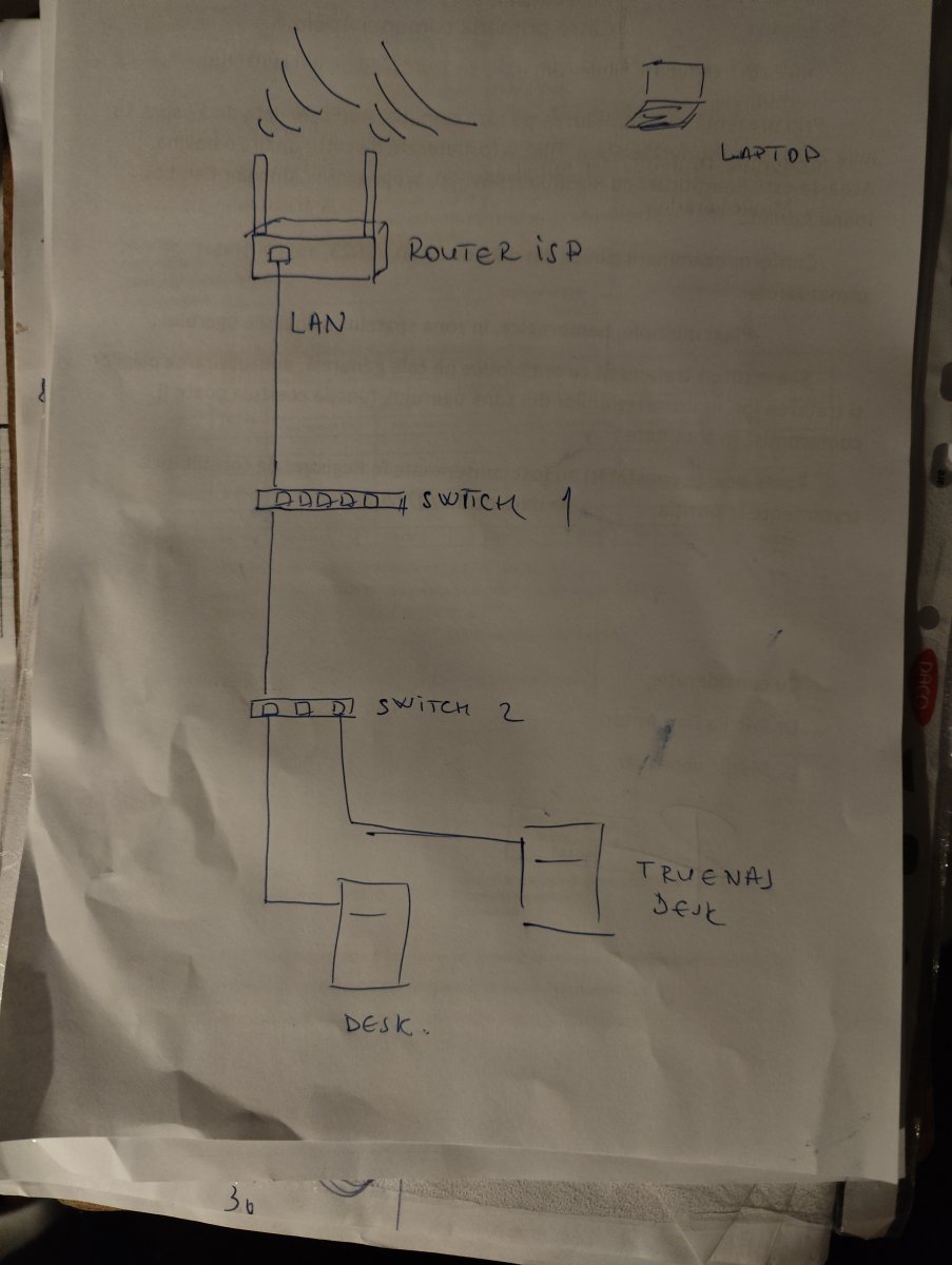

Patrick M. Hausen
Nov 25, 2013
7,776
Please post a diagram of your network and IP adresses, netmasks and defaulrouter settings of all three systems (TrueNAS, working computer, not working computer) involved.

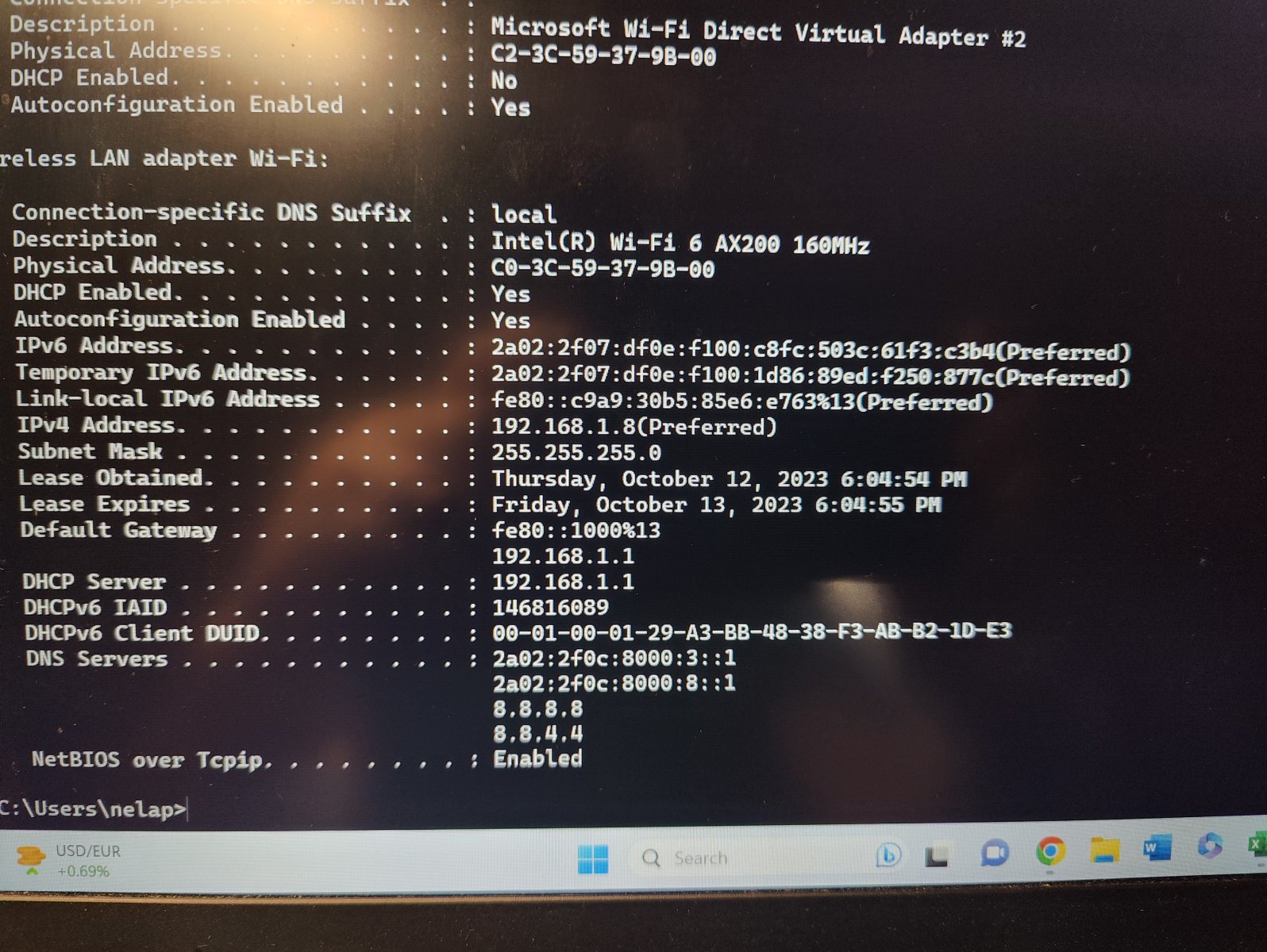

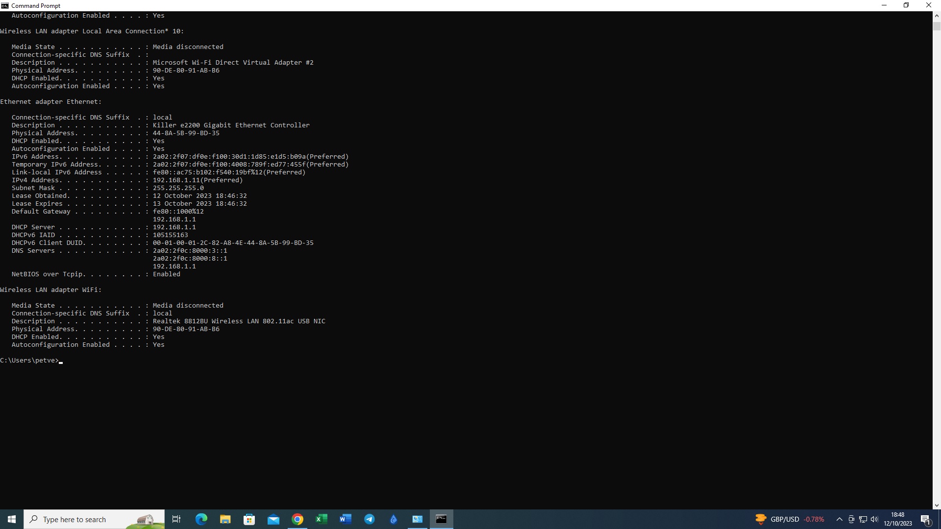

Laptop config
Patrick M. Hausen
Nov 25, 2013
7,776
UI: Network > Network Summary

Patrick M. Hausen
Nov 25, 2013
7,776
@Davvo Possibly the netmask on the TN host is too narrow so it can communicate with the PC only but not the wireless laptop. That's why I asked for full configuration of everything.
@madvet Another possible cause: does your ISP router/access-point permit wireless clients to communicate with devices on LAN at all? Is there a feature named "client isolation" or similar? Is it activated?
