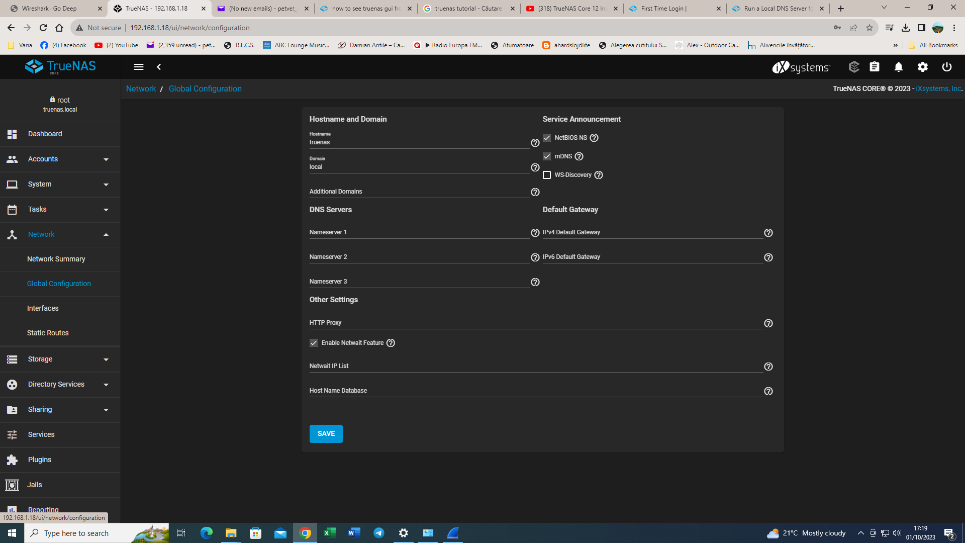

and screen snip the network summary tab

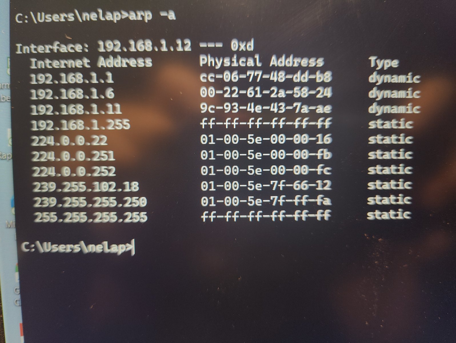

also open cmd prompt and do a "arp -a" then post results

ARP - a from my laptop
