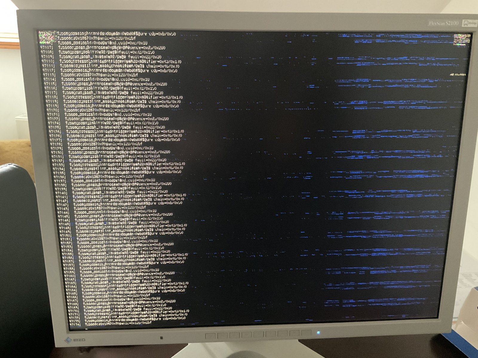

Hello everyone,
I very irregularity experience strange crashes in my system that I am simply am unable to diagnose (see crash screen in attached image). I am quite new to truenas but have been building linux servers for a while.
My server is built from a repurposed workstation that has been running fine for over a years and it has been running fine for two weeks and suddenly is producing these strange crashes
My hardware
  • Installed bare metal
  • Asrock B560 Pro4 (the workstation used a different motherboard)
  • 96 GB ram
  • Intel i9 11900 (non-k)
  • PSU: Flexguru 300w
  • one mirrored pool for frequently used data with two: WD BLACK SN850
  • one pool raid z1 with one 8tb HGST deskstar and two WD Ultrastar DC HC510 8TB
  • I use the onboard sata controllers
I am confident that this is not an overheating issue as at most get 60C. The system always reboots without problem and operates just as before.
I do get a waring on boot that I am not sure about "IPVS: rr: TCP: [ ip...:port] no destination available". The containers on the respective ports works fine.
One possible issue could be that I currently using the onboard gigabit port and really push its bandwidth that this cause this behavior? I am waiting for a mellanox conectX-3 at the moment.
I cannot detect any hardware or software flaw and am a bit lost how to diagnose this correctly.
Thank you!

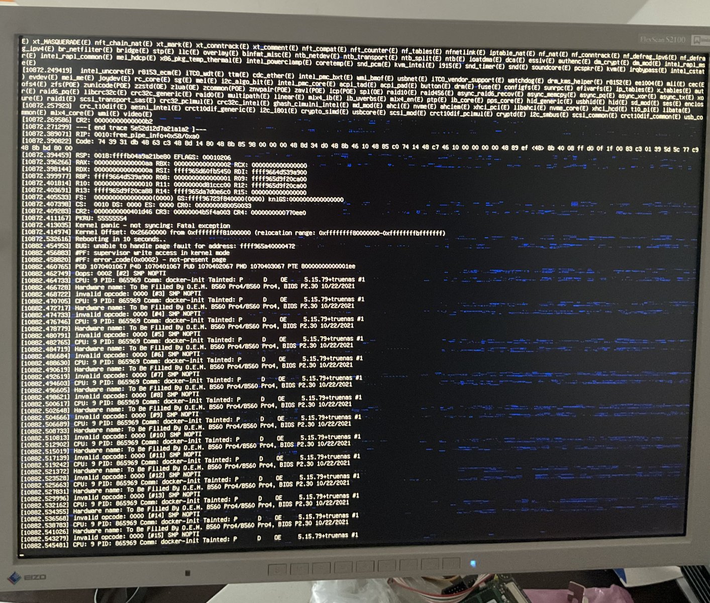

Ok that didn't fix it either but at least this time I caught the error message and does seem to be a kernel panic.
@OP You mentioned 60 degrees earlier
Are you talking disk temps - or system temps? If disk temps thats way too hot
No I am only talking about CPU temps I wouldn't actually know how to measure disk temps. The problem still persist also with the new RAM settings. This time I saw the error message in time and it a kernel panic I just do not seem to be able to find the cause. I since swapped my network card for a mellanox connect3

This time around the errors are more legible could that mean that a container is causing the panic?

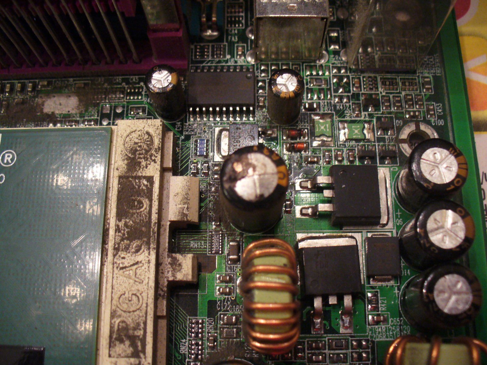

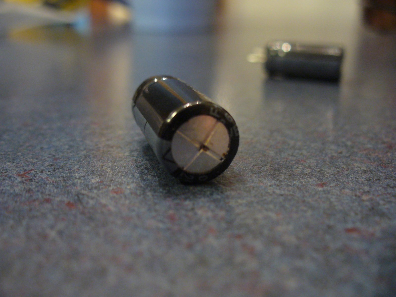

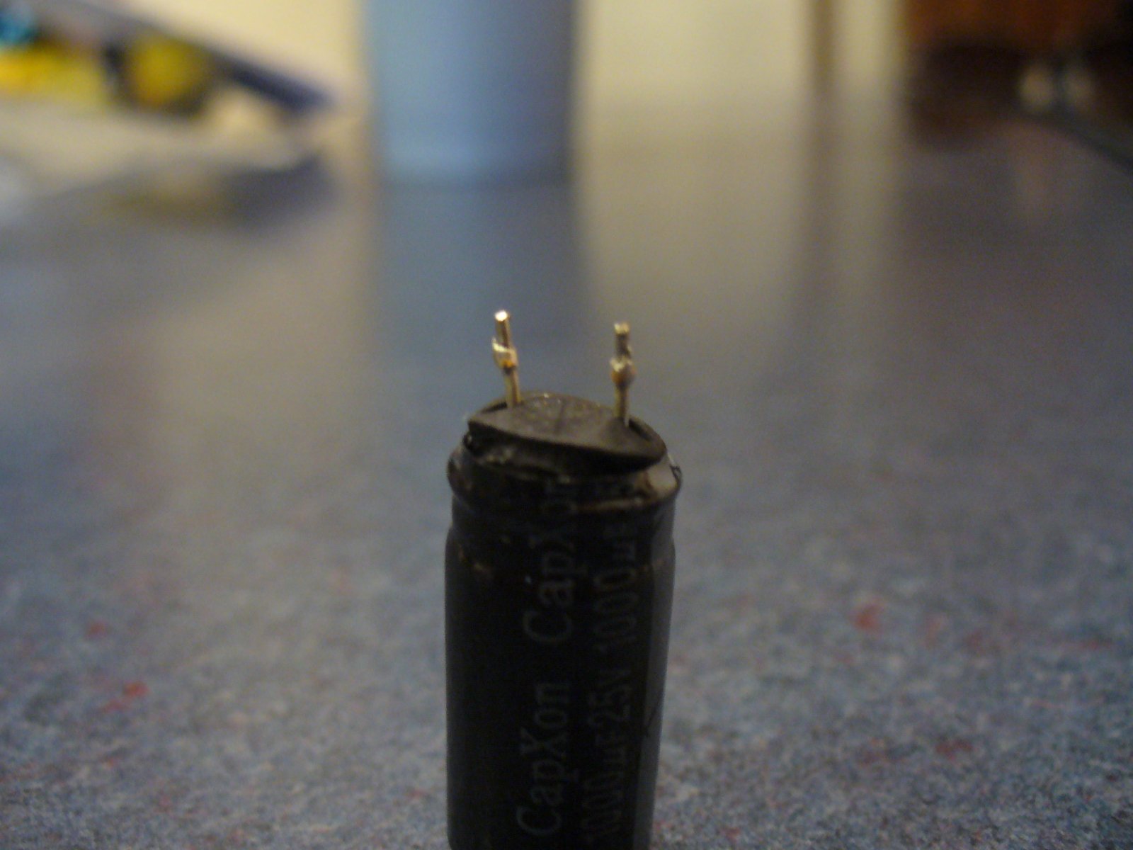

Jun 15, 2022
674
Check for swelling power filtering capacitors around the CPU. <--click the link
Also, the install is suspect when done on a failing PSU with noisy power. Think of the results in a music recording studio if the singer was being hit by a boxer while recording, except inside a computer is better compared to the noise levels of a restaurant kitchen.
