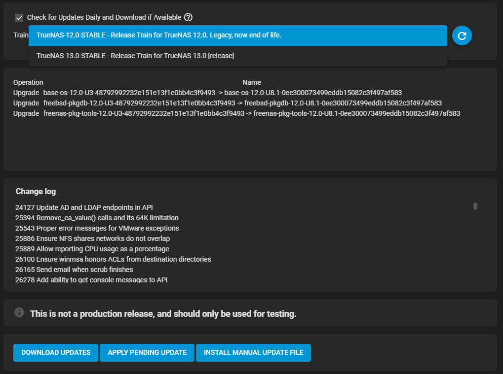

Anonza
Jul 26, 2023
19
@Davvo They are running virtual disks with a virtual LSI parallel SCSI - not good. At least the hardware seems to be "ESXi compliant".
Hi Patrick,
Yeah apologies to you as well, I just moved the ESXI tab further down to avoid confusion on my part.
TrueNAS version is: TrueNAS-12.0-U3
TrueNAS CORE is what I have.
I see there are updated available, if I perform these, it shouldn't corrupt the Data right?
