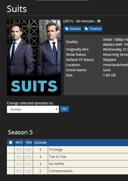

Grasfer
Jun 19, 2015
11
Has this happend to anyone else that after post process the episode dissapear from the list?
Like episode 1 of new suits dissapeard after it downloaded and post-processed it. Happend to alot of other series to.
CraftyClown
Apr 5, 2014
214
Hey Grasfer,
I'm not seeing the same behaviour. Suits downloaded and post processed for me without problems and episode one is still showing in Sick rage.
Are you on the Master or Dev branch? I'm currently on master.
Grasfer
Jun 19, 2015
11
Hey Grasfer,
Master.
I'm not 100% sure but if i download a serie manual and set it to process for tv then the episode is still in the list. But when sickrage think the quality is bad and wants to redownload a better version sometimes episodes dissapear.
Really weird.
