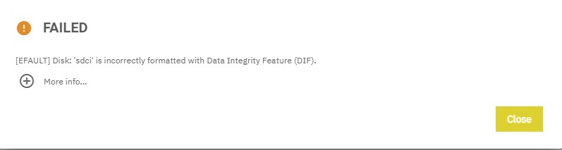

updated our second storage from 22.02.4 to 22.12.0. After the update i get this error:
New alerts:
  • Disk(s): sdaa, sdz, sdah, sdag, sdao, sdak, sdai, sdaf, sdad, sdac, sdaj, sdu, sdam, sdan, sdaq, sdar, sdas, sdav, sdax, sdap, sdau, sdat, sdal, sdaw, sdj, sdd, sdb, sda, sdf, sdc, sdm, sdg, sdk, sdi, sde, sdh, sdr, sdx, sdw, sdl, sdab, sdv, sdae, sdq, sdy, sdp, sds, sdt, sday, sdaz, sdbb, sdbf, sdbc, sdbe, sdbh, sdba, sdbj, sdbd, sdbi, sdbg, sdbk, sdbl, sdbu, sdbv, sdbm, sdbp, sdbq, sdbo, sdbn, sdbr, sdbs, sdbt, sdn, sdo, sdcf, sdcg, sdch, sdci, sdcr, sdcs, sdcj, sdck, sdcl, sdcm, sdcn, sdco, sdcp, sdcq, sdbx, sdby, sdbz, sdca, sdcb, sdcc, sdcd, sdce are formatted with Data Integrity Feature (DIF) which is unsupported.
It seems evertything ist working.
I'm seeing the same issue, and everything also seems to be functioning normally still. Strangely, there were only two posts for the error found in search (including this one) and neither had no replies. From what I remember, my drives were formatted when I first installed Scale 22.02.1.
rollee
Sep 18, 2021
4
UPDATE: A Google search returned one new result, https://ixsystems.atlassian.net/browse/NAS-119271, which indicates these are T10 formatted drives, which "does not play well with ZFS and is unneeded since ZFS has it's own checksumming." What kind of complications should we expect if we were to leave the drives as they are, since everything seems to be functioning now?
NickF
Jun 12, 2014
763
Depending on the specific disks and what firmware is publicly available you may be able to flash to 512 byte from 520, but without knowing the specifics not sure that you will be able to use the drives safely.
morganL
Captain Morgan
Administrator
Mar 10, 2018
2,694
No problems are known.
If you want to replace 1 drive at a time and reformat, you can.

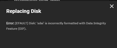

MR.B
Dec 15, 2022
6
can't replace the disc

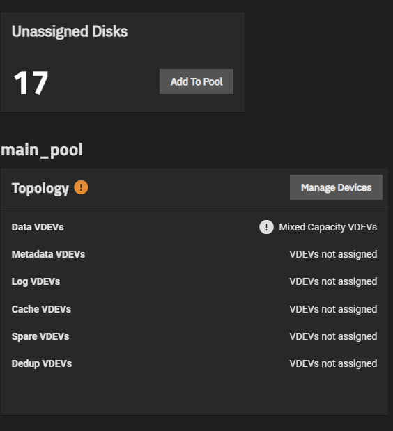

Having the same issue here, all my drives are gone from my main pool, and the datasets have been removed.
bonfire62
Nov 27, 2022
21
more info:
The pool still shows up in zpool, so the pants-pooping has slowed:
NAME        SIZE  ALLOC   FREE  CKPOINT  EXPANDSZ   FRAG    CAP  DEDUP    HEALTH  ALTROOT
VM          460G  62.0G   398G        -         -     6%    13%  1.00x    ONLINE  /mnt
boot-pool   111G  5.35G   106G        -         -     1%     4%  1.00x    ONLINE  -
main_pool  72.7T  21.3T  51.4T        -         -     0%    29%  1.00x    ONLINE  /mnt
Daisuke
Jun 23, 2011
1,041
@bonfire62 please post the output zpool status -v main_pool, from screenshot, you have mixed capacity disks, which should not matter. Also, can you please surround the above terminal text output with [CODE]text[/CODE], for readability?
I created this troubleshooting thread for DIF warning, let’s continue the discussion there. cc @rollee @MR.B
I love your humor! :grin:
bonfire62
Nov 27, 2022
21
@bonfire62 When you run zpool status main_pool, do you see the list or attached disks? From screenshot, you have mixed capacity disks, which should not matter. What happens when you press Manage Devices in UI, please show us what you see.
I got scared and I'm downgrading with my old boot image, it's still coming back up :(.
I hadn't mixed different capacity drives in the main_pool, for some reason it had added a fourth vdev from drives that I had added to the JBOD but not allocated to a vdev yet. Looking at the issue above, I think the issue that I'm seeing is from there being the ?metadata? volume under /dev/ that was originally from the 520b vs 512b format issue shown above.
.....downgrading by switching boot images should work.....right?
