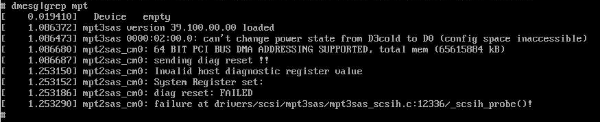

Correct. When in slot 7, it just works. In slot 4 and nothing in slot 7, it spits out what I gave above. That's actually not the full message, just the ones with "mpt" in it. I think there was some additional hardware or memory address dumps what were showing. Or maybe that was only when I turned on more detail logging of the module.

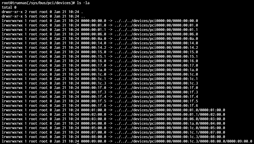

Anyways, I really only stumbled that maybe port 7 needed to be populated first. I saw the below and noticed that 0000:01* and 0000:02*, the two addresses the card would show up depending if it was in PORT7 or PORT4, really were just links under 0000:00:01.0 (or .1). I'm not a hardware programmer, and I don't have a clue about how the PCIe bus works and is enumerated, but it just made me think along the lines of "hey, maybe the 1x16 slot gets treated as two 'sub busses' and if there's nothing in the first, the second one can't be communicated with."

- What's with the mpt2sas messages? Is this a benign quirk of the Linux driver? Or is something terrible happening behind the scenes?
I presume you're referring specifically with the 2 instead of 3? Looking at the kernel module code, it's all under the mpt3sas module, but it covers quite a range of actual cards used over the years. The mpt2sas i believe is the code for the more "legacy" cards like my 9211-8i that are SAS 2008 based. It may also differentiate SAS2 vs SAS3. That's not an area I'm particularly fluent with.

As the the last line mentions mpt3sas_scsih.c and scsih_probe(), I thought that file might be a good place to start investigating the history. The line about changing the power state from D3cold to D0 also got power management on my mind. I saw a commit from November 2020 regarding
generic power management. I don't believe that made it into the initial 5.10 kernel release in December 2020, but it's in the kernel version used for Bluefin according to the github repo.
