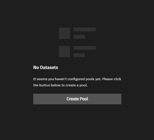

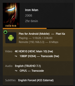

So... I decided to use one of my breaks at work to do this today and I can confirm that I have HW transcoding again!!
However...
I can no longer manage my datasets from the GUI. They all still show via SMB and from using
zfs list -r
, but they aren't in the GUI.
jace92
Dec 14, 2021
46
Just updating here in case anyone else has the same issue I posted about a couple days ago.
To fix the dataset issue (for me at least) I had to remove my cloud sync task and then they showed right up (I first saw that nugget of info here). Hopefully that helps someone.
