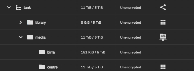

Why use a directory structure for a dataset? After all, the dataset is mounted in /mnt. The root / directory uses the appropriate unix structure. I believe there is no need to use unix directory structure in dataset.

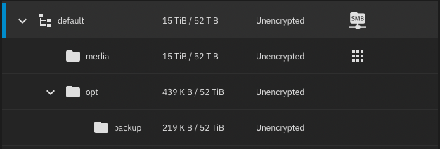

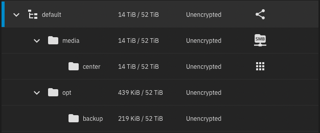

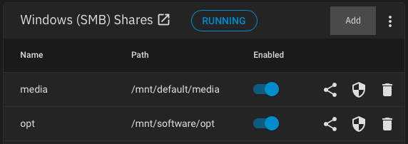

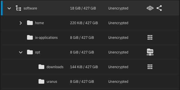

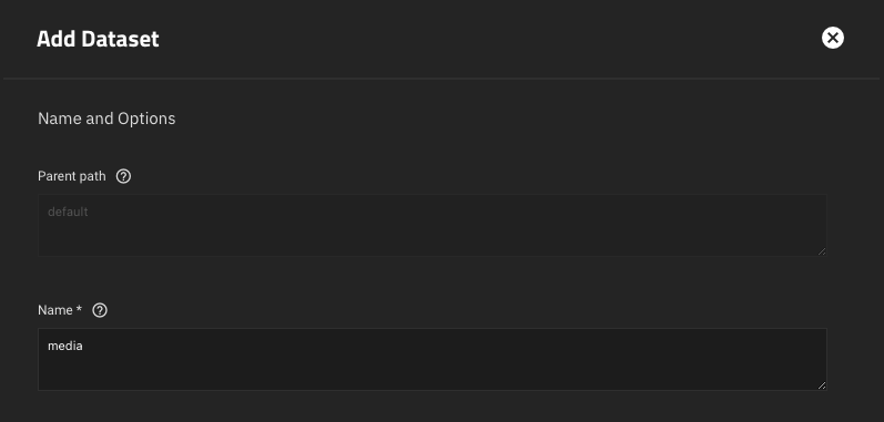

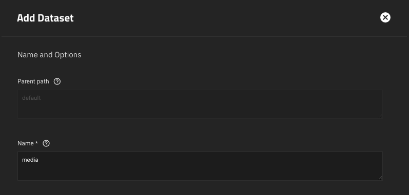

Pools and Datasets
It is strongly recommended to separate your media storage, from your applications storage. Also, is preferable that root defined pool dataset names follow the Linux standard naming conventions. Users familiar with FHS, will find this beneficial.

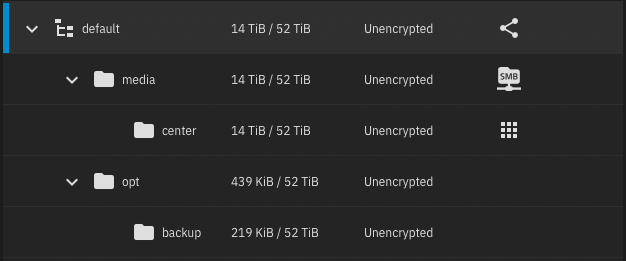

My pools and datasets setup:
  • default pool, using RaidZ2 CMR disks:
    • media dataset used for SMB share access
      • center dataset used for storage of media related files and accessed by multiple Kubernetes applications
    • opt dataset used for shared data
      • backup dataset used for backup files
  • software pool, using Mirror SSDs:
    • home dataset used for non-root user home directories
    • ix-applications dataset used for Kubernetes applications

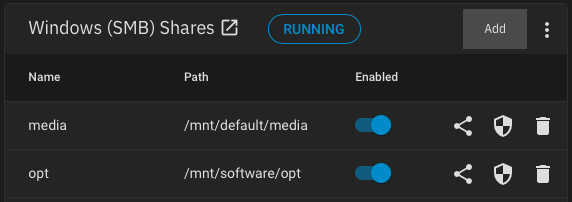

    • opt dataset used for SMB share access
      • downloads dataset used for storage of temporary media related files and accessed by multiple Kubernetes applications
      • uranus dataset used for a private Github repo where automated application backups are stored

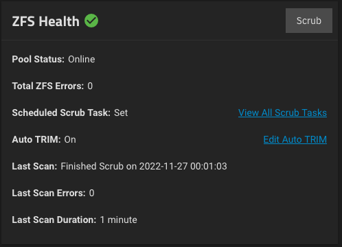

If you use SSDs for your pool, make sure you enable Auto TRIM pool option in Storage > ZFS Health:
TRIM is a command that helps Scale operating system know precisely which data blocks are no longer needed and can be deleted, or marked as free for rewriting, on SSDs. Whenever a delete command is issued, TRIM immediately wipes the pages or blocks where files are stored. Next time the operating system tries to write new data in that area, it does not have to wait first to delete it.

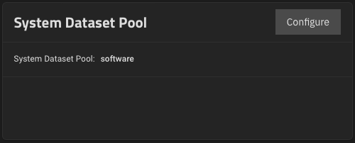

To take advantage of your SSDs speed, set the System Dataset Pool to software pool:

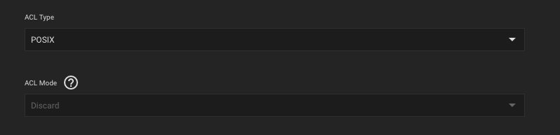

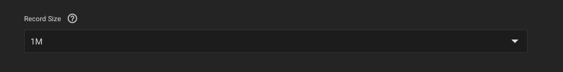

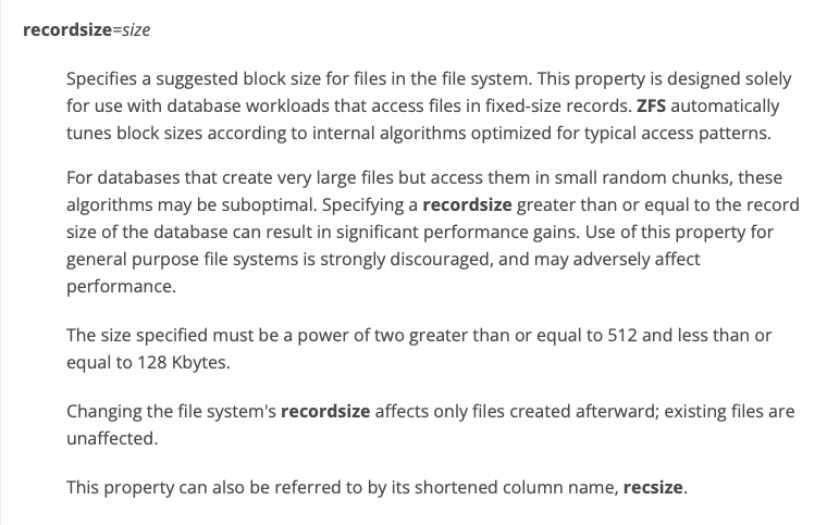

Datasets should have the recordsize set according your specific dataset usage. For example, if media files larger than 5MB are stored on a dataset, recordsize should be set to 1M:
On the other hand, a MySQL InnoDB database stored on a dataset will greatly benefit from a recordsize set to 16K. That is because InnoDB defaults to a 16KB page size, so most operations will be done in individual 16K chunks of data.
If recordsize is a lot smaller than the size of the typical storage operation within the dataset, fragmentation will be greatly increased, leading to unnecessary performance. If recordsize is much higher than the size of the typical storage operation within the dataset, latency will be greatly increased. See openzfs performance tuning, for reference.
To determine the correct recordsize, you can calculate the average file size for a specific dataset with this command:
# find /mnt/software/ix-applications -type f -ls | awk '{s+=$7} END {printf "%.0f\n", s/NR}' | numfmt --to=iec
43K
Note that changing the recordsize affects only newly created files, existing files are unaffected. Therefore, is important to move your data to a new dataset with the correct recordsize. See man zfs, for reference.

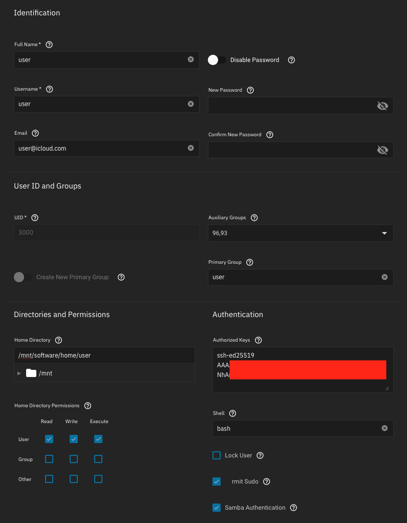

Non-Root Local User
In Bluefin, non-root local user UID starts with 3000, versus Angelfish UID 1000. It is recommended after Bluefin upgrade to delete old non-local users and re-create them with the new UID structure, to avoid future permission conflicts. Prior upgrade, make sure your root user has the password enabled into Angelfish UI. Once upgraded to Bluefin, create a non-root local user to use it as UI login. On a clean install, admin user is created with UID 950 and root user password is disabled.
Standard Linux user creation defines the same userid and groupid, then you can add additional groupids to your user. A standard Linux user also requires a /home directory defined, in your case /mnt/pool/dataset/username. Auxiliary groupid 41 is builtin_administrators and auxiliary groupid 96 is apps (needed for Plex), names showing as ids will be fixed in Bluefin 22.12.1.
Create a /mnt/pool/dataset/username dataset (e.g. /mnt/software/home/user), where your user private information will be stored, then add a new user with following settings:
Make sure you set a valid email address, needed for testing the email alerts (see below Email Alerts section). The new UID 3000 can be used into runAsUser setting for all Scale applications, see below Kubernetes Apps Security section.
You should also generate a ssh key, login into your server as user and run the following command:
$ pwd
$ ssh-keygen -t ed25519 -C 'user@icloud.com'
Generating public/private ed25519 key pair.
Enter file in which to save the key (/mnt/software/home/user/.ssh/id_ed25519): [press Enter]
Enter passphrase (empty for no passphrase): [press Enter]
Enter same passphrase again: [press Enter]
Your identification has been saved in /mnt/software/home/user/.ssh/id_ed25519
Your public key has been saved in /mnt/software/home/user/.ssh/id_ed25519.pub
The key fingerprint is:
SHA256:kpfu/eLIwWkXyujcDQfUDX/FqAX0UoJUnabz8XR9esc user@icloud.com
The key's randomart image is:
+--[ED25519 256]--+
|         .o+=o.+.|
|        . . +=o .|
|       o .  +o. =|
|      o S .  o *o|
|       B + .  o E|
|      . X o    ..|
|     o = O.      |
|      o =.+o.    |
+----[SHA256]-----+
$ mv .ssh/id_ed25519.pub .ssh/authorized_keys
Use your new id_ed25519 private key to access the server, the authorized_keys file content will automatically show into Authorized Keys UI field.

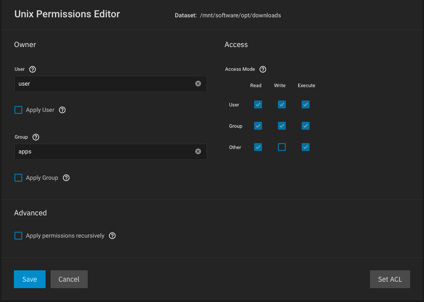

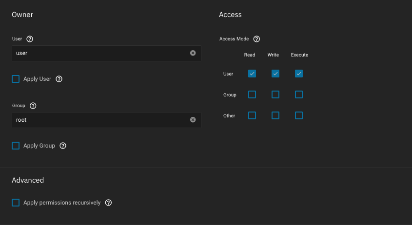

Next, recursively re-apply the correct user/group permissions to your /mnt/pool/dataset/username dataset:
Once upgraded to Bluefin, disable password for root user (see caveat mentioned below into Kubernetes Apps Shell):

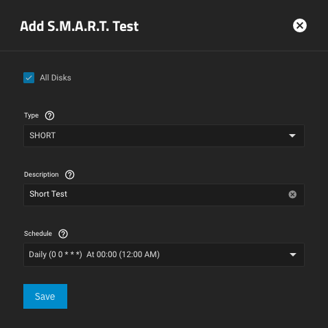

Configure S.M.A.R.T self-tests to measure the storage devices health, predict possible device failures and provide notifications on unsafe values. S.M.A.R.T. (Self-Monitoring, Analysis, and Reporting Technology) is a supplementary component built into modern storage devices through which devices monitor, store, and analyze the health of their operation.
There are four types of self-tests that a device can execute, all safe to user data:
  • SHORT - runs tests that have a high probability of detecting device problems
  • LONG - same as SHORT check but with no time limit and with complete device surface examination
  • CONVEYANCE - identifies if damage incurred during transportation of the device
  • OFFLINE - runs an immediate offline Short self-test, in foreground
To configure a daily short SHORT self-test, go to Data Protection > S.M.A.R.T Tests:
It is recommended to run a daily SHORT self-test and a bi-monthly LONG self-test, on all your pool disks.

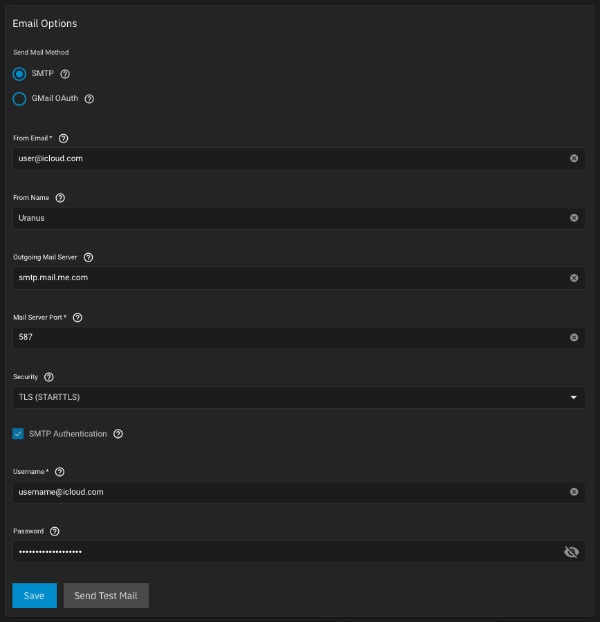

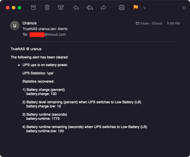

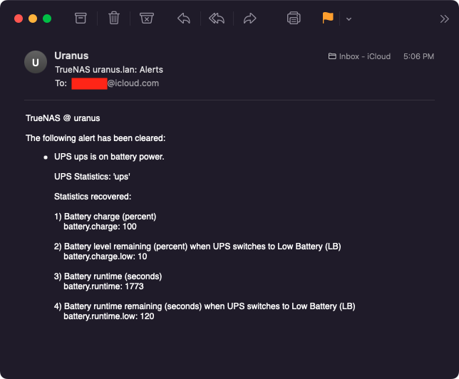

Email Alerts
It is extremely important to have functional mail alerts in Scale, in order to receive notifications of a degraded pool or other critical errors. I personally use the Apple iCloud SMTP servers. You cannot send iCloud emails without an application password with software other than Apple products, is a two-factor security feature.
Go to Alerts and select Email from Settings dropdown menu:
iCloud settings example:

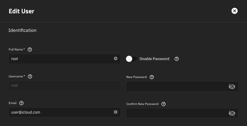

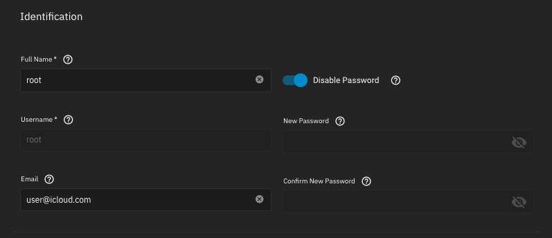

The Username must be your true AppleID email account or the linked iCloud alias (which you cannot modify or delete). From Email can be any @icloud.com alias you can create, modify or delete, but must be part of your list of linked emails to main AppleID. For example, you can use user@icloud.com, which is an account alias you created into username@icloud.com AppleID account.
Next, go to Credentials > Local Users > root > Edit and add the email address you used into previous From Email field:
See also NAS-119145 related to wrong hostname, fixed in Bluefin 22.12-RC.1.

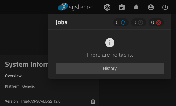

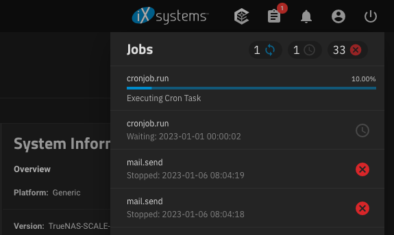

System Failed Jobs
In certain rare cases, you might experience certain cron jobs being stuck for days or other failed tasks:
You can address the issue easy, by restarting the middlewared service:
# systemctl restart middlewared.service

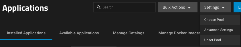

If you get an error message telling you the Kubernetes service is not running or Unable to connect to kubernetes cluster in Bluefin, go to Apps > Settings > Unset Pool. Reboot the server and Set/Choose Pool. Once the pool set, it can take up to 30 minutes until all services are reconfigured, please be patient.

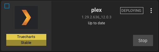

Is recommended to use the TrueCharts applications, their development team is specialized in Kubernetes charts, the same way iXsystems team is specialized in Scale OS. Beside robust charts, the main advantage TrueCharts applications offer is an uniform installer process. You will find the same familiar settings in each application and the team offers stellar support on their Discord channel, if you have any questions. All related application settings reflected in this guide are taken from their apps, thank you @truecharts for your community support.

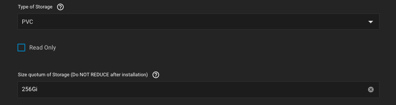

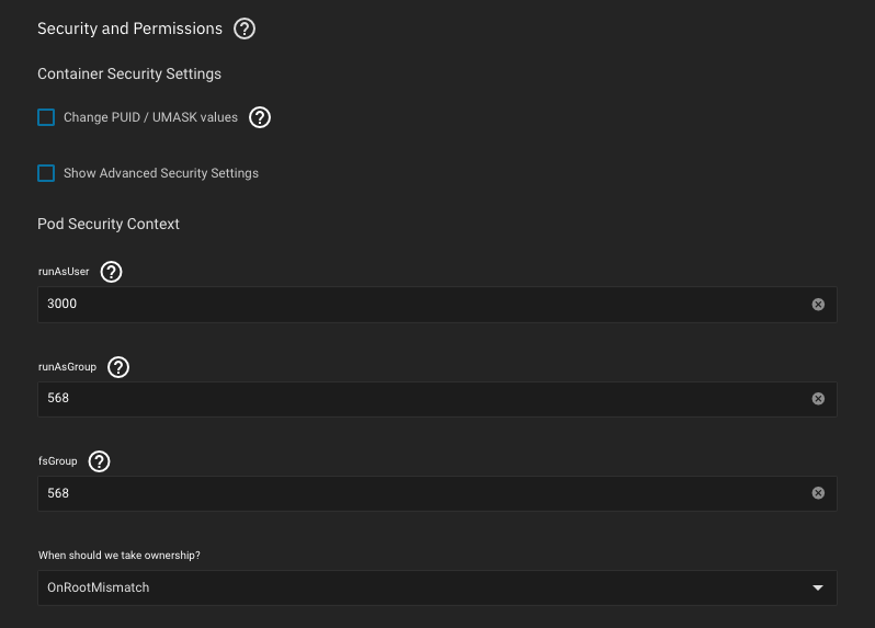

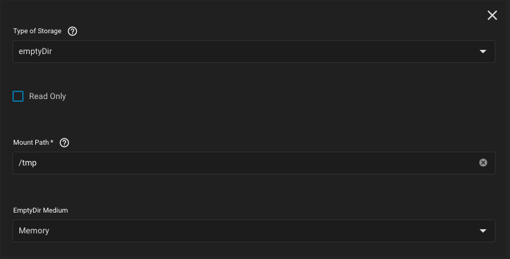

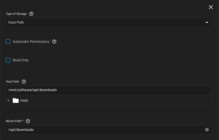

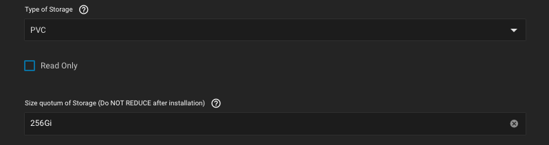

Make sure your apps have the following storage types set accordingly.
Required default app storage:
  • PVC, the simple type is deprecated, never change this type of storage, this is the main cause for application failures

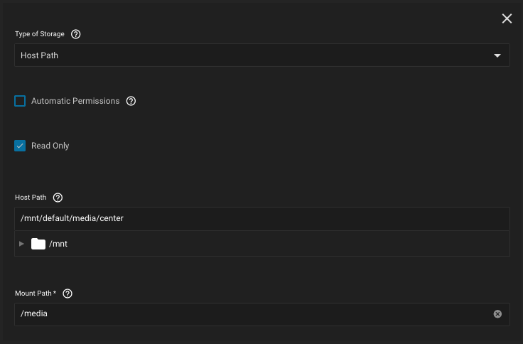

Example of additional storage, in TrueCharts Plex application:
  • Host Path set to /mnt/pool/dataset/child-dataset, in my example /mnt/default/media/center
  • Mount Path set to internal container directory /media, standard Linux directory where media is stored
As per Kubernetes documentation, the hostPath volume must be mounted as Read Only. This will also prevent any SMB share mounted on /mnt/default/media dataset to change the file permissions inside containers.
List of directories present into internal /media container directory, which are also present inside /mnt/default/media/center dataset:

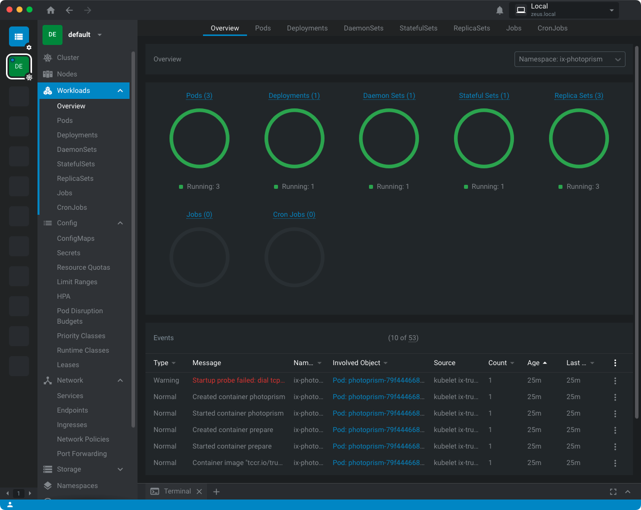

Bluefin introduces a new non-root admin user, disabling the password for root user. This prohibits the access to application logs and shell, which will be fixed into a future Bluefin release. You can easily access to logs and shell through an ssh terminal, with root user. If you are a Kubernetes administrator, see the Kubernetes External Access section.

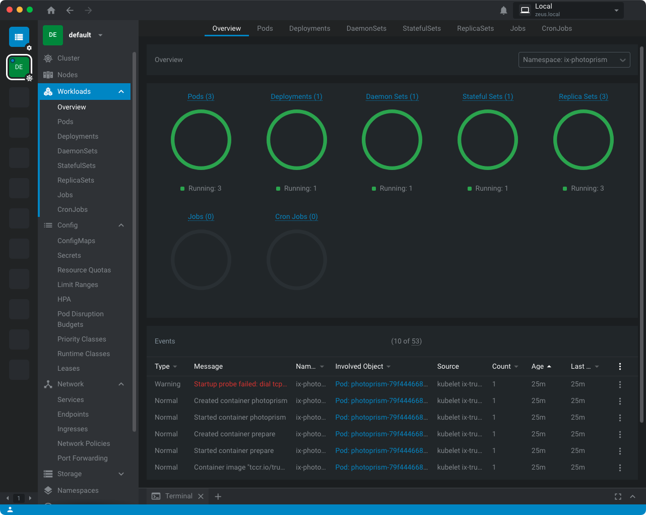

List all Kubernetes pods:
# k3s kubectl get pods -A
Access the TrueCharts Plex application logs:
# k3s kubectl get pods -n ix-plex
NAME                    READY   STATUS    RESTARTS   AGE
plex-7d47c9cc4f-dprph   1/1     Running   0          42h
# k3s kubectl logs plex-7d47c9cc4f-dprph -n ix-plex | tail -n 3
udc input failed with 1001
udc input failed with 1011
ERROR: Error decoding audio frame (Invalid data found when processing input)

Kubernetes Applications Security
To avoid any file permission issues while sharing the same hostPath with multiple applications and a SMB share, is recommended to set the runAsUser to the non-root local user you use to access the SMB share, in my case UID 3000:
You can always use the default apps (568) user as runAsUser, but you will end-up with mixed permissions, if you manually create a directory or file through a SMB share (logged as non-root local user), which will break your apps file access. Proceed, based on your own needs.
In certain cases, the runAsUser UID change can result in failure to properly apply the UID for all container files:
Container logs:
2022-12-19 19:15:27.197191+00:00 Permission denied: /config/Library/Application Support/Plex Media Server/Preferences.xml
With PVC mounted locally, old UID 1000 is still assigned, instead of UID 3000:
# ls -lh /mnt/software/tmp-plex
total 512
drwxrwsr-x 3 1000 apps 3 Aug  9 16:33 Library
You have the choice to delete the app and start fresh, or execute the script listed below, to fix the permissions.
Adjust the pool (where ix-application dataset belongs to), app and username script variables (where user should be the name of your UID 3000):
# id user
uid=3000(user) gid=3000(user) groups=3000(user),568(apps),544(builtin_administrators)
The script has all required failsafe checks in place and is set to use the apps (568) usergroup, which is the default runAsGroup setting into all apps. I recommend to never change the usergroup name, into your applications. Create the script as root:

In UI, stop the application if is still showing as Deploying and execute the script:
# bash perms.tool
Applying user:apps permissions to plex application... OK
Start the application in UI.

Kubernetes Cluster External Access (for Advanced Users)
If you are an experienced Kubernetes cluster administrator, you can access the Scale Kubernetes cluster remotely and troubleshoot quite easy any issues you might encounter. Thank you @blacktide for the useful information.
You can temporarily modify iptables, allowing the Kubernetes cluster to accept connections from a wider private subnet. My current iptables output:
# iptables -L INPUT -n --line-numbers
# Warning: iptables-legacy tables present, use iptables-legacy to see them
Chain INPUT (policy ACCEPT)
num  target     prot opt source               destination
1    KUBE-ROUTER-INPUT  all  --  0.0.0.0/0            0.0.0.0/0            /* kube-router netpol - 4IA2OSFRMVNDXBVV */
2    KUBE-ROUTER-SERVICES  all  --  0.0.0.0/0            0.0.0.0/0            /* handle traffic to IPVS service IPs in custom chain */ match-set kube-router-service-ips dst
3    KUBE-FIREWALL  all  --  0.0.0.0/0            0.0.0.0/0
4    ACCEPT     tcp  --  192.168.1.8          0.0.0.0/0            tcp dpt:6443 /* iX Custom Rule to allow access to k8s cluster from internal TrueNAS connections */
5    ACCEPT     tcp  --  127.0.0.1            0.0.0.0/0            tcp dpt:6443 /* iX Custom Rule to allow access to k8s cluster from internal TrueNAS connections */
6    DROP       tcp  --  0.0.0.0/0            0.0.0.0/0            tcp dpt:6443 /* iX Custom Rule to drop connection requests to k8s cluster from external sources */
Modify INPUT 4 (your line number might be different) to accept a wider private subnet, instead of just the assigned Scale 192.168.1.8 private IP address:
# iptables -R INPUT 4 -s 192.168.0.0/16 -j ACCEPT
Next, copy the /etc/rancher/k3s/k3s.yaml file contents to your local ~/.kube/config and change the localhost IP address, to your required private IP address:
$ sed -i 's|127.0.0.1|192.168.1.12|' ~/.kube/config
You can now access the Kubernetes cluster with Lens:
Rebooting the server will revert iptables to original configuration.

Datasets Structure Organization
You can easily organize your pool datasets structure with zfs rename command, thank you @winnielinnie for the useful information.
The goal is to move all data from media dataset:
Into media/center child dataset:
➊ Use zfs command as root user, to rename the dataset you plan to move into a child dataset:
# zfs rename default/media default/media-old
➋ Into UI, create a new media dataset:
➌ Rename the media-old dataset to center child dataset:
# zfs rename default/media-old default/media/center
The rename process is instant and recordsize setting will be preserved.
New dataset usage in TrueCharts Plex application, change only the hostPath and your Plex media files will not be affected in any way:
SMB Shares Configuration
Once your datasets structure is properly organized, proceed with the SMB shares configuration.
The main concern is having ix-applications dataset isolated, it should not be accessed by anyone except root user. Currently, the ix-applications dataset is allowed to be read by anyone and permissions cannot be changed. For example, a non-root local user should:
  • not be able to access ix-applications dataset through an SMB share, see thread
  • be able to read/write data using a hostPath volume assigned to a child dataset, accessible by multiple pods

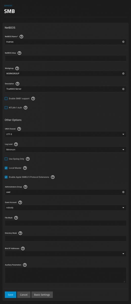

Prior setting a new SMB share, configure the service:
  • Enable Apple SMB2/3 Protocol Extensions, if you connect the shares to a Mac
  • Set the Administrators Group to user UID 3000 you created earlier
I currently have two SMB shares set:
  • media - mounted on media dataset, where center child dataset is used for shared files between multiple applications
  • opt - mounted on opt dataset, where downloads child dataset is used for shared files between multiple applications
For any SMB connectivity issues, you can troubleshoot with following command:
# midclt call smb.status AUTH_LOG | jq
Organize your pool datasets, preferably following Linux standard naming conventions (read the Pools and Datasets section, for important dataset optimizations):
To avoid any hostPath conflicts, set your SMB share to /mnt/software/opt and your application hostPath to /mnt/software/opt/downloads. Assigning an SMB share directly to /mnt/software pool is not considered good practice.
To access your SMB shares, use the previously created UID 3000, which must have proper permissions to all your datasets (except ix-applications dataset, which should never be exposed or accessed by an end-user).
/mnt/software/opt/downloads dataset permissions, see documentation for setting POSIX ACLs:
You will not encounter any issues or warnings if you make sure the /mnt/software/opt SMB share is not directly accessed by multiple applications, the SMB share user matches the runAsUser UID and the dataset ACL Type is set to POSIX (default option), which is supported by Linux, Mac and Windows:

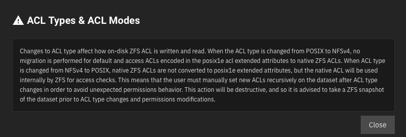

Changing the dataset ACL Type to SMB/NFSv4 will result in breaking the file permissions and cannot be reversed, as detailed into warning:
As per Kubernetes documentation, the hostPath volume must be mounted as Read Only. Since we are using POSIX ACLs and a single non-root local user controls the SMB share, as well all applications, an exception can be made. Example of /mnt/software/opt/downloads dataset shared with multiple applications who access the internal pod /opt/downloads directory to read/write data:
Example of re-used internal directory, into an application:

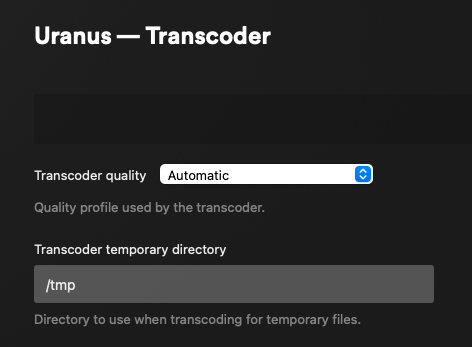

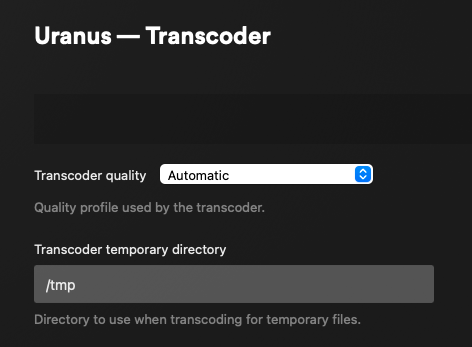

Plex Transcoding
Media that is incompatible with your device will be transcoded to a playable format. If you own a Plex compatible GPU, you can turn on Hardware-Accelerated Streaming in Plex Media Server. It is strongly recommended to create a Memory medium storage type, used specifically for transcoding.
Using a Memory medium will significantly improve the transcoding performance. In your TrueCharts Plex application, add:
In Plex Media Server, go to Settings > Transcoder and set the temporary directory:
Uninterruptible Power Supply
It is recommended to use an UPS, in order to avoid brief power failures, which will abruptly shutdown your server. These interruptions are known to corrupt your pool data, therefore is worth the investment.
Identify the UPS model and driver:
# nut-scanner
Neon library not found. XML search disabled.
Scanning USB bus.
No start IP, skipping SNMP
No start IP, skipping NUT bus (old connect method)
Scanning IPMI bus.
[nutdev1]
    driver = "usbhid-ups"
    port = "auto"
    vendorid = "051D"
    productid = "0002"
    product = "Back-UPS NS 1500M2 FW:957.e4 .D USB FW:e4"
    serial = "5B2150T61261"
    vendor = "American Power Conversion"
    bus = "001"
[nutdev2]
    driver = "nut-ipmipsu"
    port = "id1"
[nutdev3]
    port = "id2"
In my case, the scanner detected an UPS unit connected to USB port. The only important information you will need is the driver usbhid-ups, the product name might vary. Into UPS service, configure the settings as listed below and pay attention to:
  • Driver - match the found driver, in our example usbhid-ups
  • Port - match the found port, in our example auto
  • Monitor Password - set a random complex password, you will not use it as end-user
If you configured correctly your email alerts, in case of a power failure, you will receive an alert similar to:

yes okay, but how do i disable host path mount...??
and what will happen with my shared network drive on my windows computer then...???
oblivioncth
Jul 13, 2022
71
The simple version is that the actual data itself is stored within whatever dataset you're using on your server, whereas chart host path mounts, SMB, and NFS are all different protocols for accessing that data externally to truenas (which is the case even for charts installed via truenas since they're containerized). Making changes to your configuration in regards to any of these three things doesn't actually alter the dataset itself so your data isn't going anywhere.
The Windows share you see is made available via SMB, which again since you aren't touching that means the share won't be lost either.
The only thing you're doing is changing the chart's access method to your data from a Host Path mount to NFS. Under the settings for your chart under Additional App Storage you should see the host path you created earlier which you can simply remove. At this point all that will have chaged is that this one chart only will have lost access to the data temporarily. You can then follow the NFS share steps above within the same settings panel to restore the charts access to your dataset via this other method. The settings you need to apply to the NFS section will be nearly the same as those that were in the Host Path section.
You should stop each chart you need to make this change to before proceeding and then start them again after the change has been made.
This is technically unrelated but be sure not to update any of your trucharts based charts until you've fully handled making these changes and have updated to 22.12.2 as truecharts is overhauling their chart implementation at the moment and there's been some road bumps along the way so you don't want to be dealing with multiple problems at once in case you do run into issues with the updates.
