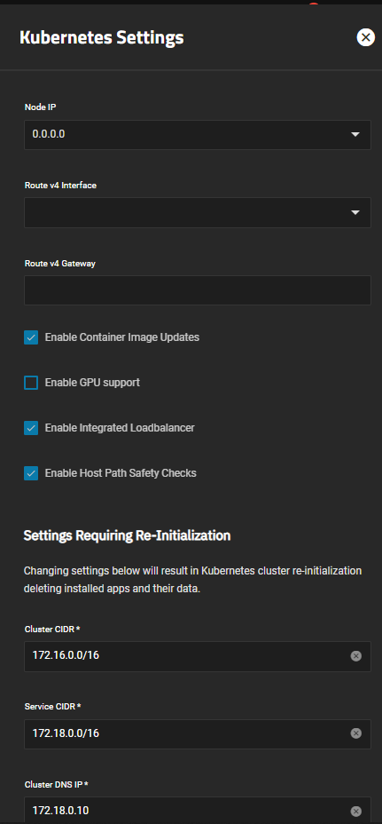

Go to your apps tab. And hit settings / Advanced settings. Post image of your kubernetes settings.

I have tried changing to my local ip for Node IP, however that didn't change much in terms of working :)

Fill in Route v4 Interface (whichever interface is listed on you Network tab) and then add your router IP as the Gateway. Save and then reboot to apply changes. These are the steps that worked for me!

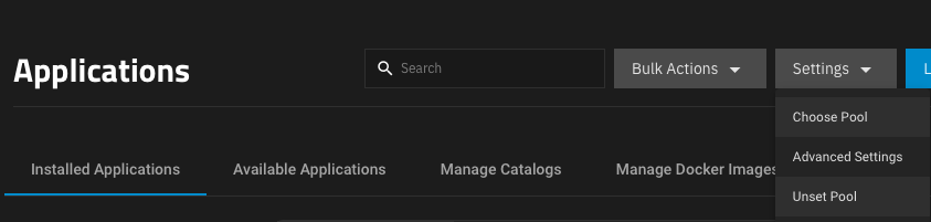

Is there a gui-fied way to do it
Yes that's how I did it, through Bluefin UI. Apps > Settings > New Pool:
Once migrated to new pool, you need to reboot the server, your Kubernetes service should start without issues. Next, you move everything back to previous pool, the same way. Are you running your software pool on dual SSDs?

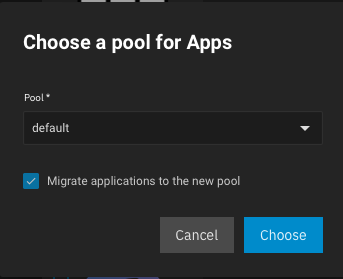

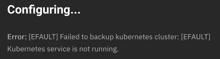

That's Choose Pool, right? But that requires the Kubernetes service to be running:

...but the migration still fails, with the same error. Oh, I see it's "activating", not actually "active." And when I wait a bit and check status again, I get:
