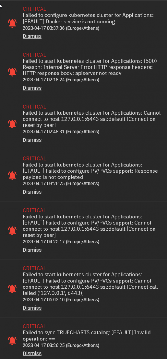

Shortly after, I upgraded to 22.12. Due to an issue with my X540-T2's (not recognized/no connection status), I switched back to 22.02.04.
In 22.04, the following errors are present and apps don't load at all, seems that kubernetes is not running:

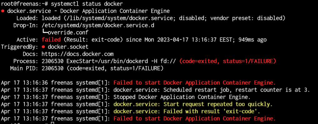

I've tried:
- Unsetting applications pool, rebooting, setting it again, waiting, rebooting, waiting.
- Restarting/Starting docker service
- Restarting middlewared
- Running 22.12 - apps not working there either
- Triple checked NTP settings (time is correct)
- Triple checked Timezone
- Starting k3s (works)
- Restarting docker (fails):
Failed to configure kubernetes cluster for Applications: [EFAULT] Docker service is not running
Failed to start kubernetes cluster for Applications: (500) Reason: Internal Server Error HTTP response headers: HTTP response body: apiserver not ready
Failed to start kubernetes cluster for Applications: Cannot connect to host 127.0.0.1:6443 ssl:default [Connection reset by peer]
Failed to start kubernetes cluster for Applications: [EFAULT] Failed to configure PV/PVCs support: Response payload is not completed
Failed to start kubernetes cluster for Applications: [EFAULT] Failed to configure PV/PVCs support: Cannot connect to host 127.0.0.1:6443 ssl:default [Connection reset by peer]
Failed to start kubernetes cluster for Applications: [EFAULT] Failed to configure PV/PVCs support: Cannot connect to host 127.0.0.1:6443 ssl:default [Connect call failed ('127.0.0.1', 6443)]
Failed to sync TRUECHARTS catalog: [EFAULT] Invalid operation: ==
I've tried:
