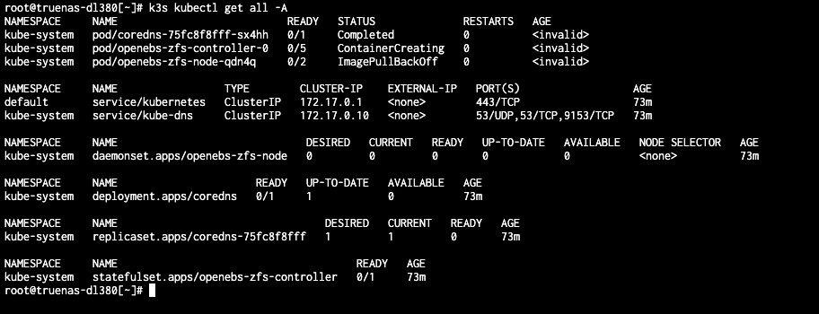

I'm having similar issues, not sure if it's related to this specific or not. Running k3s kubectl get all -A I got this:

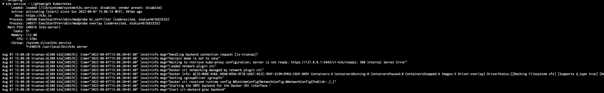

after unset zpool and reassigning after reboot, I had to manually start k3s. This is the current status of the k3s cluster
