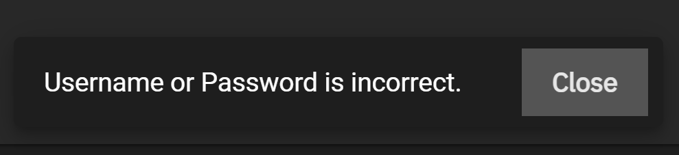

I created a brand new user with "builtin_administrators" group, however when I tried to log in with it through web UI, it keeps complaining wrong username or password:
Did I miss anything?

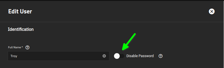

Do you have the password enabled?

@tprelog, yes the password is enabled.
Below is the actual error message:

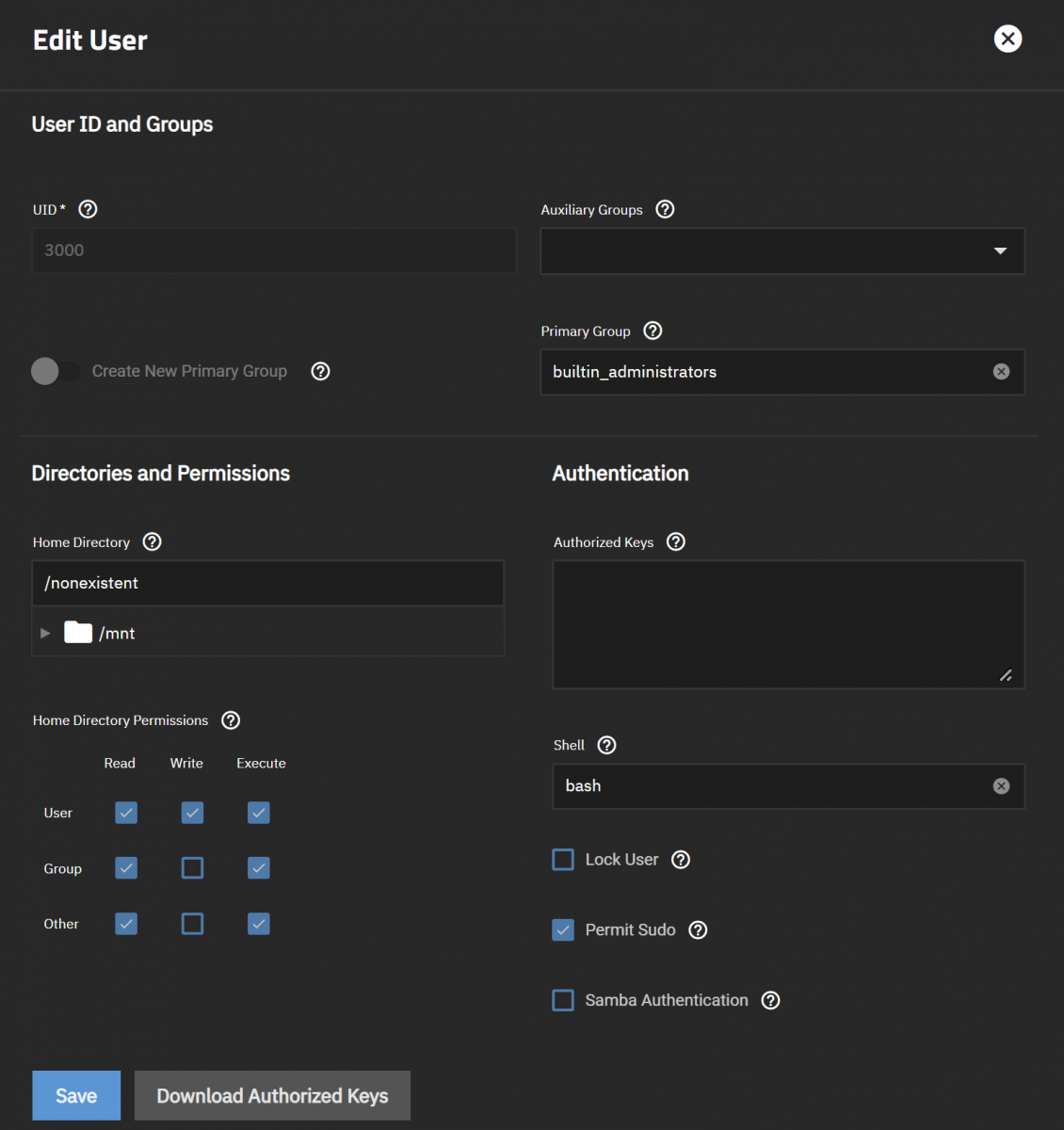

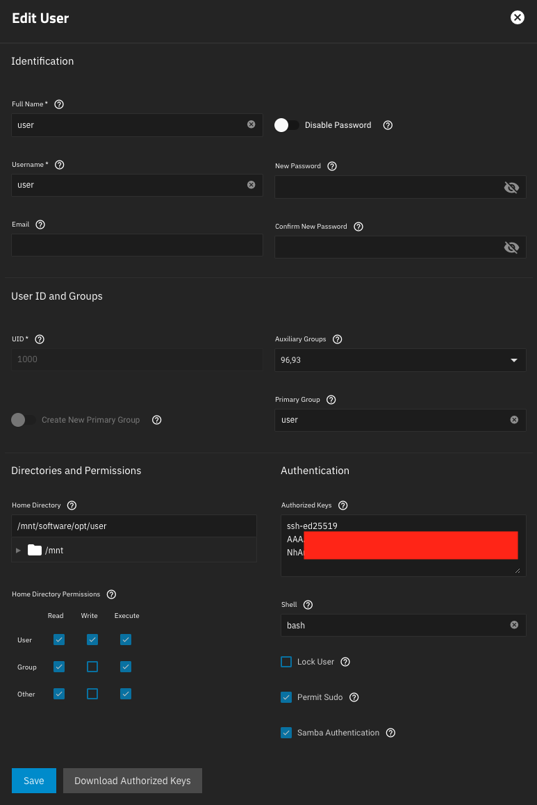

I don't know why you used primary group as builtin_administrators. Standard Linux user creation defines the same userid and groupid, then you can add additional groupids to your user. A standard Linux user also requires a /home directory defined, in your case /mnt/pool/dataset/username.
I'm not saying you should do this, I'm saying when I do this, I don't have any issues logging into UI or ssh with a non-root user in Bluefin 22.12.0. Auxiliary groupid 96 is builtin_administrators, names showing as ids will be fixed in Bluefin 22.12.1.

I didn't disable root password before trying the new account, was that the reason?
Nothing to do with your issue.
The screenshot is helpful, thanks!
I had no preference, was just using default values when creating a new user.
