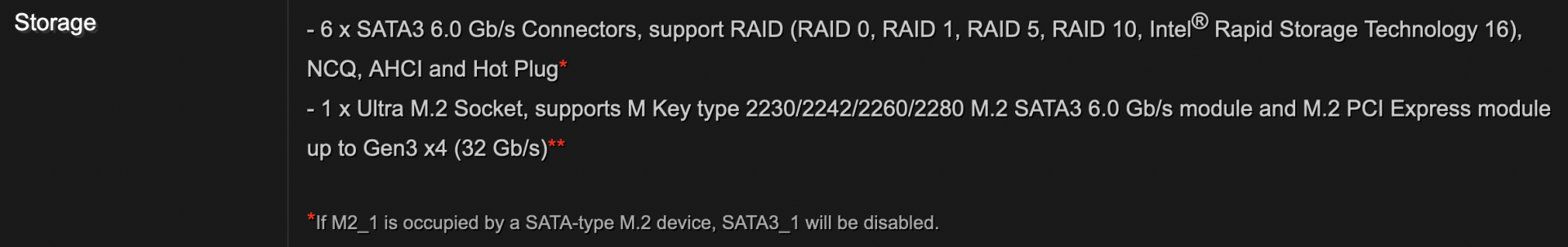

Hello everyone! I am new here, and I am currently in the proces of upgrading my previous NAS (DIY Xpenology) to TrueNAS Scale. My question is also about the boot drives. What exactly are they used for? How much does their speed influence the performance of the entire server?
I have a Asrock Z390m-itx/ac which has 6 Sata ports and 1 M.2 NVME. If the NVME is in use, only 5 SATA ports can be used.
I have 5x 4TB WD Red+ HDD, and one Samsung 256 NVME drive.
I plan to use the server as a NAS, and for a few aplications, (Plex, Pihole, Docker...) and for 1 virtual machine. The NVME drive was supposed to be dedicated to the virtual machine which would mean, that I do not have a free SATA port for boot. (And I am pretty much out of budget :D )
However I have a PCIe slot, which I could use to expand my storage, and I have 2 older SSDs Kingston SV300S37A/60G. The question is, which configuration makes more sense?

Etorix
Dec 30, 2020
2,134
Typically, M.2 slots share a SATA lane with one motherboard port but NOT their PCIe lanes (or then with a PCIe slot). Which means that using a M.2 SATA drive disables one SATA port, but using a M.2 NVMe drive leaves ALL SATA ports enabled.
This appears to be the case here:
So you can boot from one 60 GB SSD, still have 5 SATA ports for the HDD pool and use the NVMe drive for VM. And NOT use the Axagon card, which is unlikely to be ZFS-qualified HBA.
Other options would involve a (proper) HBA and/or investigating how the PCIe slot can be bifurcated to run several NVMe drives.
The board has two Intel NICs… but these are i211 and i219, not the better i210.
zubo100
Aug 25, 2022
19
In the pool that you configure for the apps.
Can I select the boot pool for this?
Thank you for this!!! I have absolutely not realised the simple fact that my Samsung is an NVME and not SATA. What you recommended is exactly what I will do. I originaly wanted to use 2 SSDs for a boot mirror, but I can live with 1. In case the boot drive fails, I can simply replace it with another.
The board also has WiFi which I planned to use as a dedicated port for the VM (since my NAS is not even 2m away from the router), but unfortunately TrueNas does not support Wireless Interfaces (or at least I think so... I am completely new to TrueNas, so I might be mistaken ), and I am not yet sure ir there is a possibility to do so. If not, I gues 2 NICs with link agregataion will have to be enough for all the trafic.
Thank you all for the replies!
