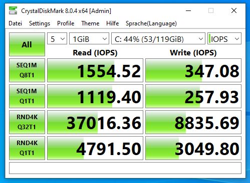

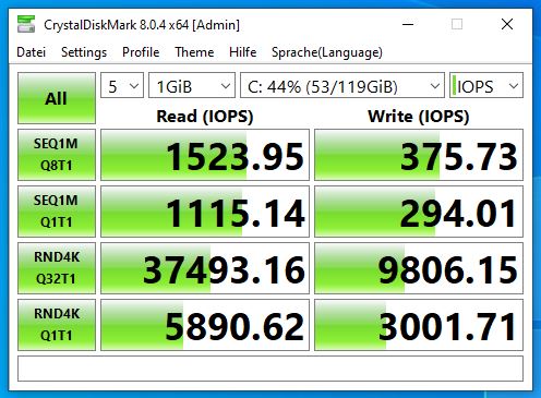

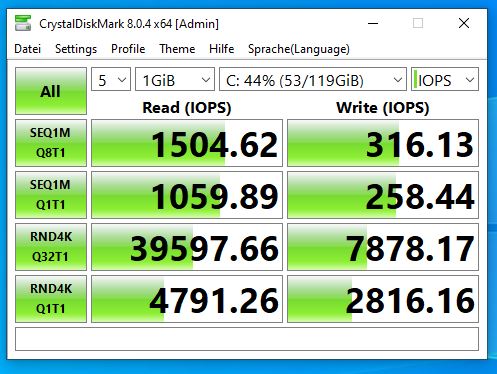

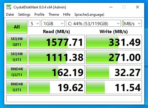

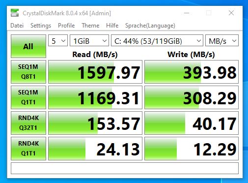

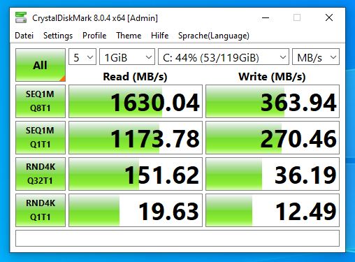

As promised, I made a few benchmarks and would like to share the results with you. Maybe it will help someone.
It is only one Intel SDD in a stripe.
Intel P4510 - MB/s (TrueNAS_128KiB - 2 Cores - 16GB RAM)
Intel P4510 - MB/s (TrueNAS_128KiB - 2 Cores - 32GB RAM)
Intel P4510 - MB/s (TrueNAS_128KiB - 4 Cores - 32GB RAM)
Intel P4510 - IOPS (TrueNAS_128KiB - 2 Cores - 16GB RAM)
Intel P4510 - IOPS (TrueNAS_128KiB - 2 Cores - 32GB RAM)
Intel P4510 - IOPS (TrueNAS_128KiB - 4 Cores - 32GB RAM)
I am very happy with the result.
Many times faster than most consumer SSDs. Especially the IOPS are excellent from my point of view.
By increasing the RAM to 32GB and doubling the CPUs, I might have expected a little more.
However, this also shows that in my case 2 CPUs and 16GB RAM are generally sufficient.
Nevertheless, I am considering whether I should stick with 4 cores and 24GB or 32GB RAM.
