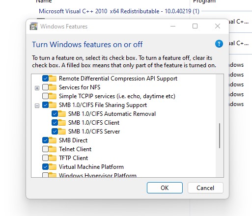

I do use LastPass plugin for work .. But I also chatting with a friend of mine and said something about maybe it was a SMB thing with Windows 11 .. So I checked and by default " SMB 1.0/CIFS File Sharing Support" is not turned on .. So I turned it on , but need to reboot for it to take effect .. Still working so cant do that yet ..

You do not need or want to use SMB 1.0. You will use SMB 3.1.1 if I recall correctly once you get a share functioning.

AAhhh well I don't see that inside of windows .. all I see the following ..
That is really old and insecure. 3 should work for you by default in both trueNAS and windows11
