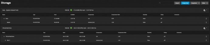

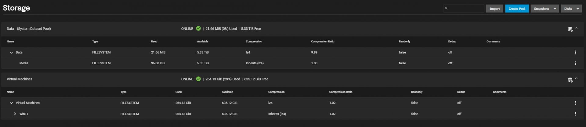

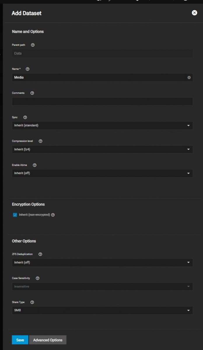

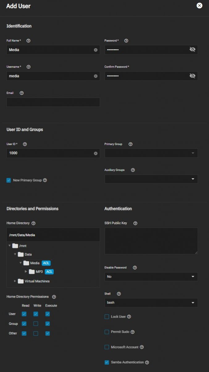

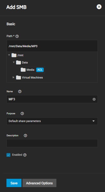

I tried again by following the link and still nothing .. Here are the pics .. I hope they help ..

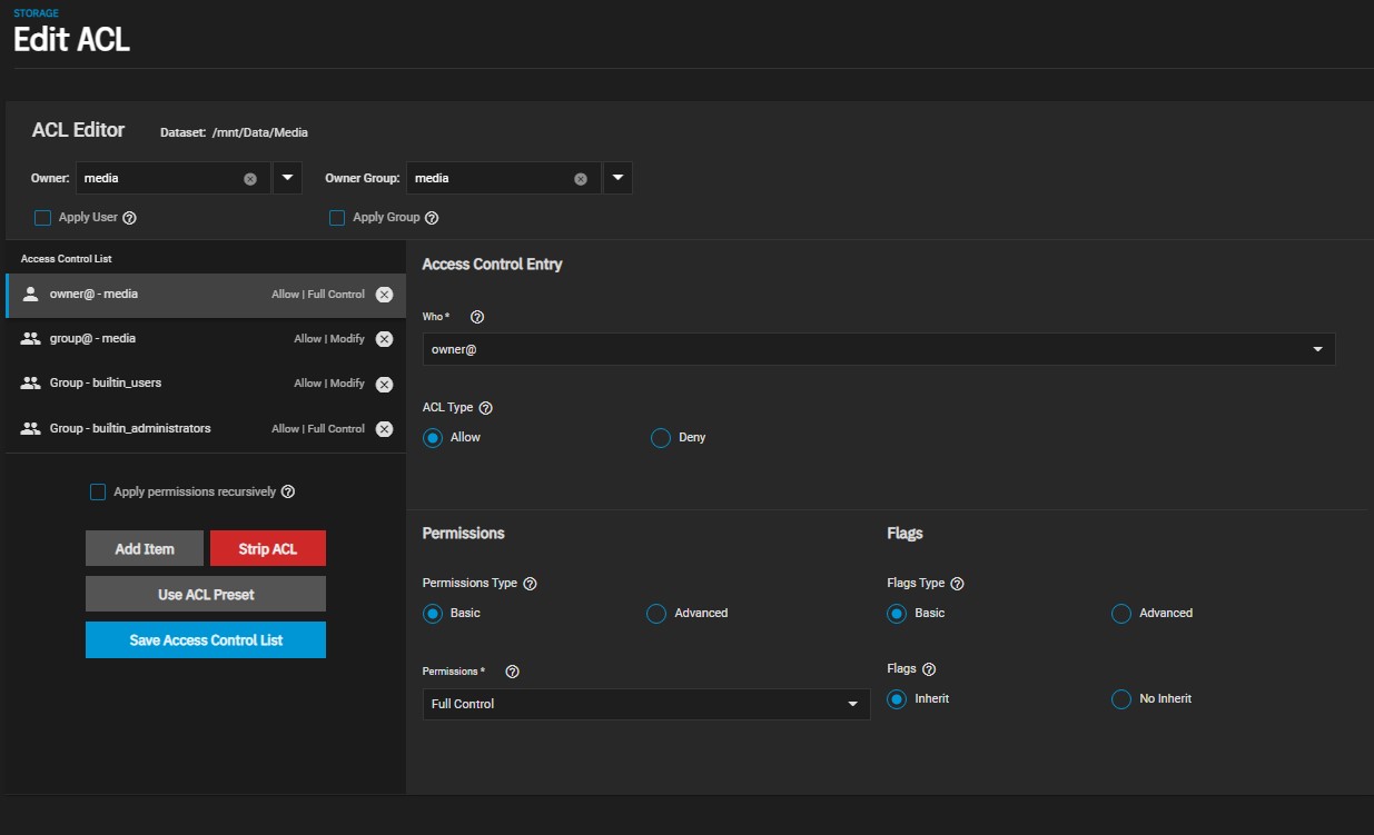

I noticed your id is Media / media. one has capital M and the other doesn't. Unlike Windows, Linux pays attention to capital letters in the ID. I am not an expert enough in truenas scale to know the precise impact of having that inconsistancy, but to make things simple, pick one or the other, and make sure to enter it correctly into Windows. My preference is just to make them all lower case.
Edit: I think you will be OK, fullname seems to be a description, and the username is the key one. as long as you user the lowercase version in Windows, you should be OK with this wrinkle.
Also you made the home directory /mnt/Data/Media. This is not what I showed in my example, or how it was done in the video. There are impacts ... complications of making something your home folder, and unless you understand them, it is best to keep things as they were suggested. I had issues with this at first, and eventually remade my IDs without home drives .. and it works for me.
Creativity in an area that you are still learning and have fundimental problems to resolve ... my preference is against that.

In Windows, is it fair to assume you typed in EXACTLY \\172.168.40.16\MP3? your old NAS named that share with a capital M small p 3. your new share was all caps MP3, so you must type in the correct case for your new share name.

try this: at the SMB share permission, use ACL Preset, and give everyone full control. then back to your windows machine, you should be able to see your dataset as a shared folder without a password. ( by typing \\172.168.40.16). right-click the folder go to security, then add your NAS user. when you add your NAS user, you need to change the location to your NAS (172.168.40.16), click check name to make sure the user name it spelled correctly. it will update SMB ACL. after it is all done remove everyone from the folder security tab. hope those steps make sense to you. Basically, it gives NAS dataset full permission for everyone. and then you edit the ACL on the windows side.

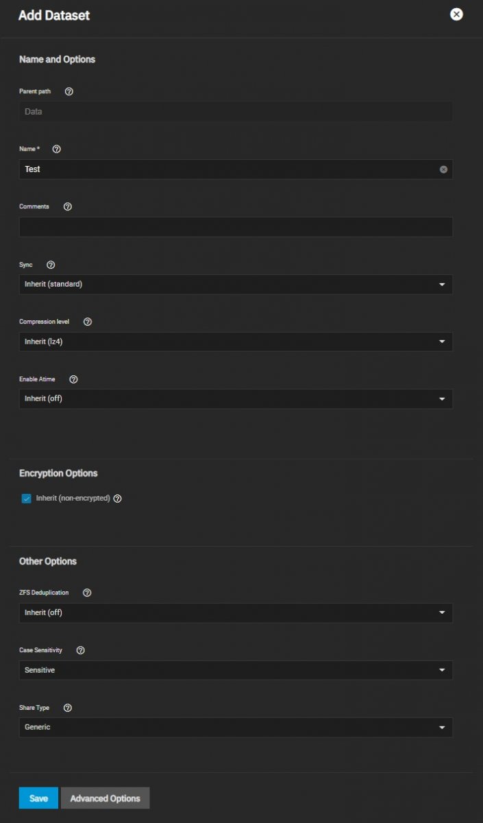

Thank you for posting the screens.
Have you turned SMB on in the "System Settings > Services" section?

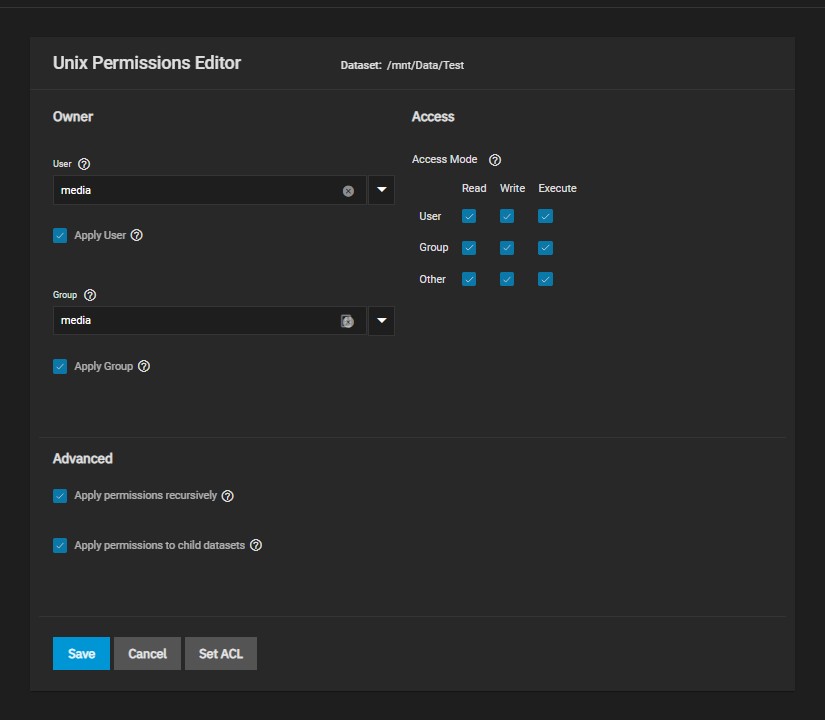

For simplicity, I would recommend working with Unix permissions instead of ACL.
Try this:
1. Go to "Storage"
2. Under the "Data" pool, click the 3 dots to open options for "Data". Select "Add Dataset". (Not "Add Zvol").
3. Name it "test". Don't change anything else. Click "Save".
4. Once "test" is created, click on its 3 dots to open options and select "View Permissions". Then click on the pencil in the permissions box to edit them.
5. You should see Unix style permissions options here. Not the ACL style permissions you posted a screen of. If you don't, stop here and let us know.
6. In the Unix permissions boxes, select every box. So, that is read, write, execute for every box.
7. Change the user and group to media.
8. Check "Apply permissions recursively". Select "Save".
9. Go to Shares page. Click "Add"
10. Point it to the "test" dataset.
11. Name it "test" and click "Save"

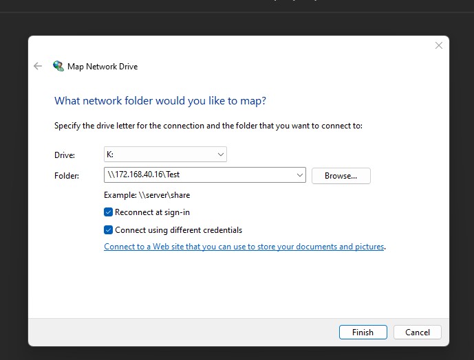

12. Open windows explorer. Right click "This PC" and select "Map Network Drive"
13. Enter "\\YOUR_SERVER_IP_ADDRESS\test" in the Folder field. Select "Connect using different credentials". Click "finish".
14. For user name enter "YOUR_SERVER_IP_ADDRESS\media" and password.
Report back what happens.
PS: Have you turned SMB on in the "System Settings > Services" section?

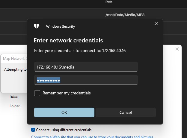

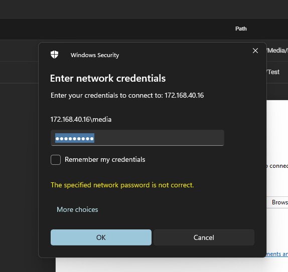

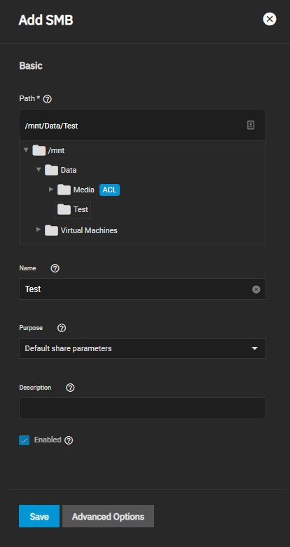

Still nothing .. Here are more screen shots ..
Man this is crazy .. why its so confusing and difficult ..

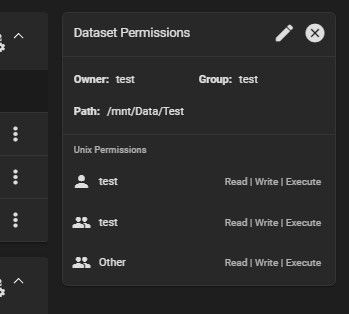

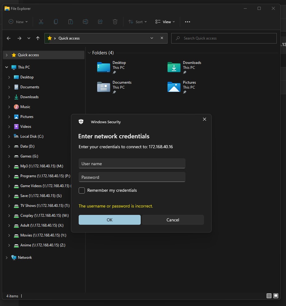

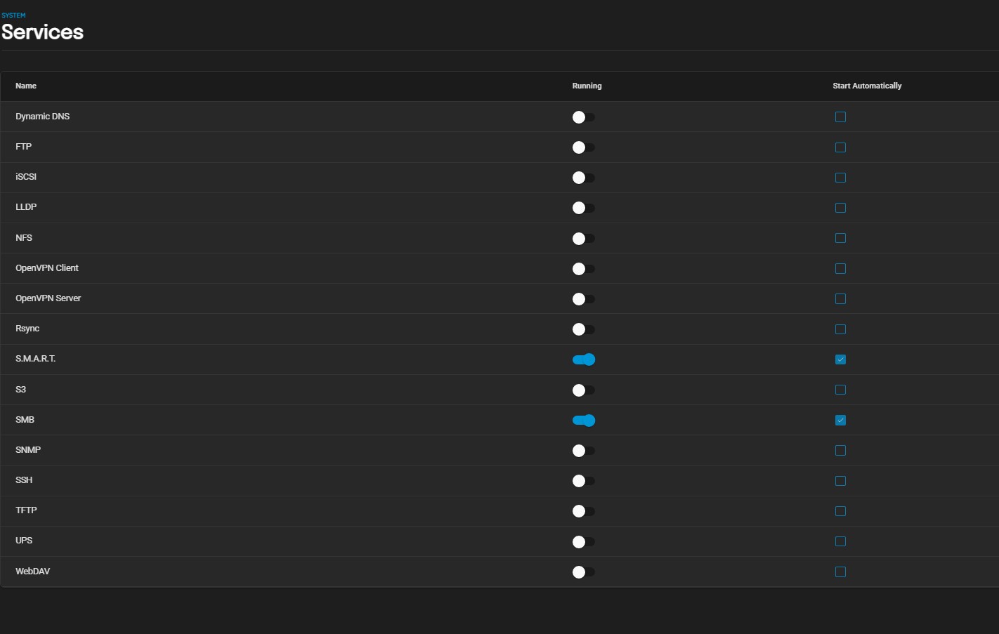

LarsR
Oct 23, 2020
719
in credentials you have to put the name of the user not the ip\share
so in the screen test map user.jpg first field is user name second field is password.
15,504
media is a built-in user, under which a variety of services run. It doesn't have a password and can't log in. Create a user, set a password for that user, and use that username and password to connect.

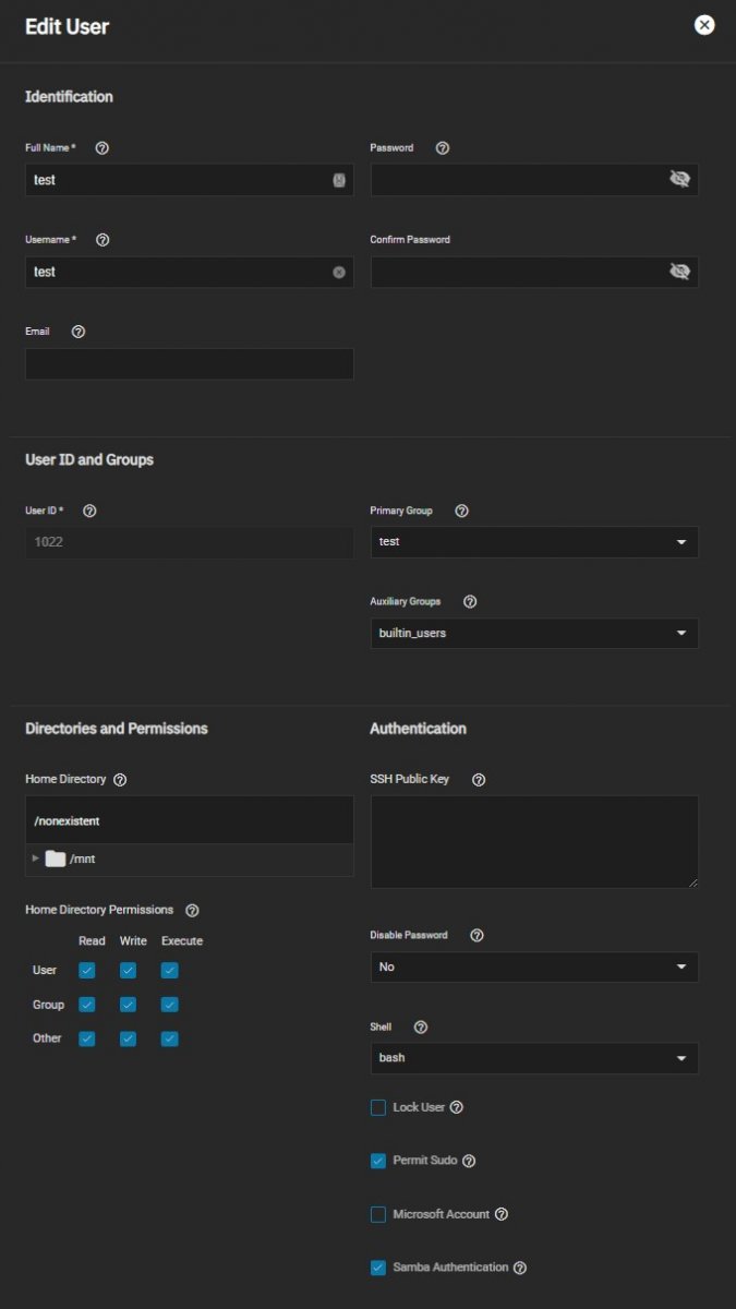

I just finished trying that .. I made a "test" user and left everything default and still same issue ..
