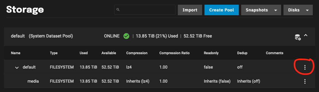

2. Create a specific dataset you plan to share with other Windows computers
You already have your pool created, so the first step is done. Next, you need to create a dataset, so you tell the SMB service what needs to be shared. To create a dataset, go to Storage, you should see the pool you created. In my case, I'll use the default pool name, as reference:
You notice the media dataset listed below my default pool. To create a dataset, simply click on the 3 dots next to your pool name and add a dataset. Set the Name to whatever you like (in my case I named it media) and leave the rest of options default. Optionally, scroll down to Advanced Settings button and click on it. Scroll all the way down and set the Share Type to SMB, then save. Some old versions of Windows don't like the default Share Type. You are done with this part.

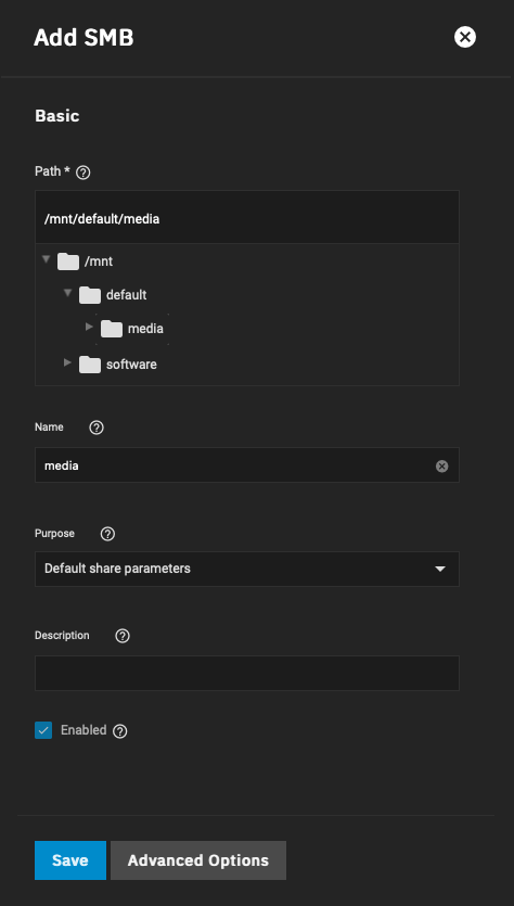

5. Add a Samba share
Go to Shares and add a SMB share, pick the path to your dataset, leave the rest of options default and save:
On Windows, use the username and password you created earlier to access the share. Your NAS will be automatically detected, under Network.
