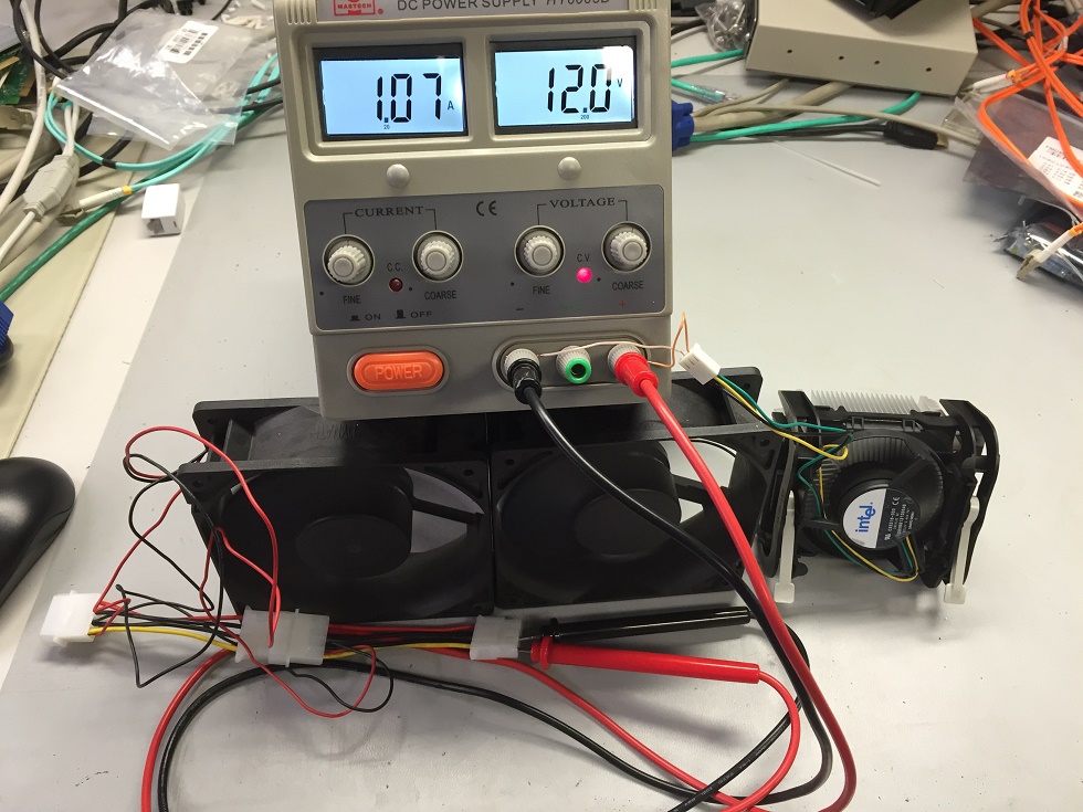

I'm thinking of Seasonic Focus PX-650 (Found it around $180)
Constantin
Vampire Pig
May 19, 2017
1,829
What I like about Seasonic is that they explicitly call out the Watts/Amps per rail and the prime series appears to set aside about 100-125W for motherboard-related voltage rails and the rest goes to 12VDC. So these PSUs seem to be pretty optimal for NAS' with HDDs - lots of 12VDC use by the drive motors.
Sadly, the Seasonic Prime SSR-650TD I bought in 2017 appears to be failing. I've started the RMA process (12 year warranty). Since Seasonic does not offer a advance-exchange program (like iXsystems!), I bought another Prime Titanium unit, this time w/a 750W capacity.
My line power plug load was about 126W max. and it appears impossible to find a ATX-form factor, Ti-certified PSU under 600W. Curiously, some of those 600W Ti-certified units sell for far more than higher-capacity, also Ti-certified, units from the same OEM, in the same marketplaces.
Yet, using a Ti-certified PSU seems advisable in areas like mine with 0.25$+/kWh electricity prices since the kinds of loads my NAS imposes squarely falls in the 15-20% capacity range that Ti-certified PSUs have to show a 90-92% conversion efficiency for.
Edit: Seasonic DOES offer an advance-exchange program. For $75 via PayPal they will send you a replacement and give you 60 days to send in the defective unit. My bad!
Seasonic's good, but what keep me buying from them specifically is that their cables have been compatible for some ten years now. It's just so convenient to be able to quickly swap out a PSU without replacing all the cables, along with the single pool of cables for all PSUs...

I was wondering where the 15-30W per fan potential power come from. Might be a typo of 1.5-3.0W?
jgreco
Resident Grinch
May 29, 2011
18,680
I do not make typos of that sort.
Borrowed from the thread at https://www.truenas.com/community/threads/i-need-some-data-points.32829/
Fans - 2x 92mm, 1x 120mm + 1x Intel boxed fan. 0.5A at most.
Really? In what fantasy world?
Ok, so I didn't have two 92mm fans and a 120mm readily available so I just used two 120's and an Intel fan. There it is. 1.07 amps - very near the lower number I mentioned (15W). And, horrifyingly, I caught the inrush current up at 2.72 amps, and a single fan stall at 2.39 amps. Unusual for me to underestimate but there we have it.
Is that a Socket 478 cooler? For a Pentium 4?
If it helps, the source post was from 2015. That makes the cooler only ~10 years old, instead of ~20 years now.
